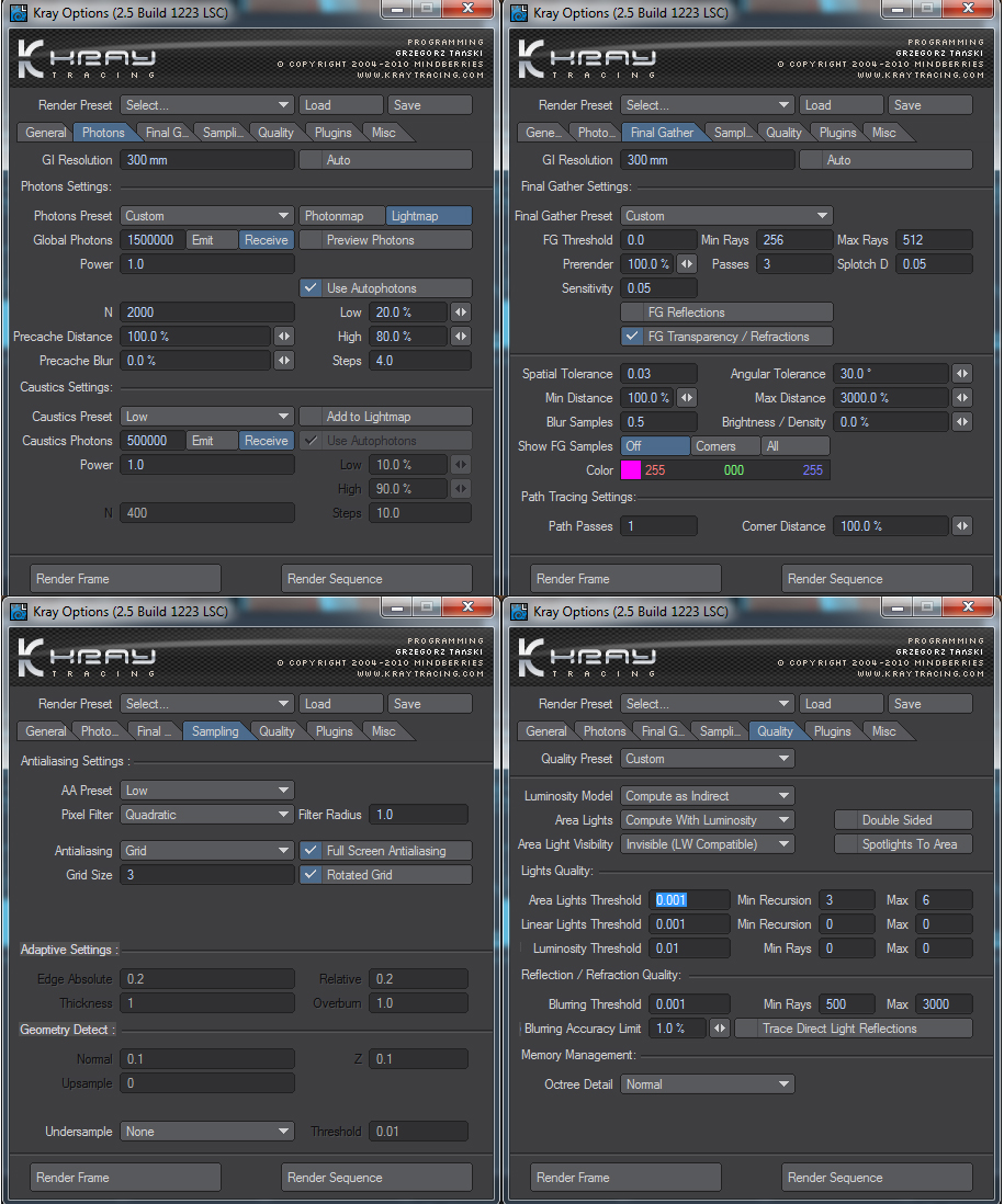

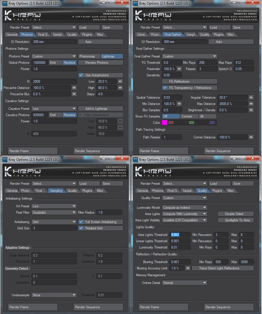

I am attaching my settings so others could see. In some areas they are higher than you suggested but it still renders around 2h, which is very fast.

Setup are very good. I would like just change:
- Area Light 2/4 or if you want maximum then 3/6 (you have too high)
- blur min/max 500/1000 or maximum 500/2000
If you get noise in scene then watch strong Lumi panels (do not allow, if You need them in scene, raise over 200-500%)
If you have blur noise - read above (lumi problem) or too strong Physky or another environment light.
If you put Area Light in window - you can make them much smaller (you will prevent ugly noise near, which is not from low setup but from strong light...I suspect them as kind of hot pixels. For that will be shader in K3 which will clean that noise and will rapid speed of render by physical lights)
By this you will decrease time ~ 30-50%. Please notice: You have perfect GI so is not waste time. You do not need time to fights with splotches or contact shadows....
You will receive very good material for post process.
I suggest concentrate with DoF (Z-buffer) it is VERY DIFFICULT part of renders, need a lot of training because is very easy exaggerate with DOF effect.
