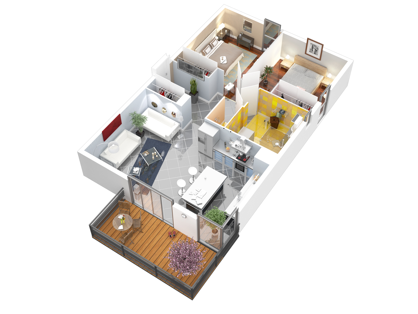

Thanks very much !
It's what i do with fbx file for a long time.
Enclosed is my current job. I think I have to do 100 to 150 apartments per year ....
I also do some outside views for real estate developers, but I'm not good.
Thank you again.

I think is very good for that big amount of renders per year.thibault wrote:Thanks very much !
Thank you again.
High quality render needs a lot of time...sometimes setup one camera in perfect angle and place takes a lot time
Also surfacing (this real top) and lighting is next nightmare...
