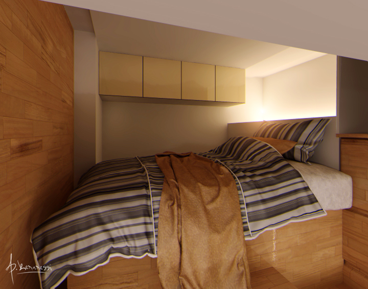

re model from real photo kray render .
Re: re model from real photo kray render .
Good stuff. You should put it in Gallery category. About quality:
1. I suggest render with QMC (try FG 2000/2000)
2. Switch AA to Random Full Screen AA around 50 (give really the best AA loosing of course time, but last time I use only this -it is just impossible to receive good AA from standard setup FSAA Grid)
3. Better setup of surfaces (I know this is the most difficult part)
4. Better blur (1000/4000)
great renders! I also think this belongs into Gallery section
thnx guys . thnx teatcher janusz biela .
its low quality render time about 2 and 3 minutes . i will put high quality when i finish it . thnx for the tips janusz
