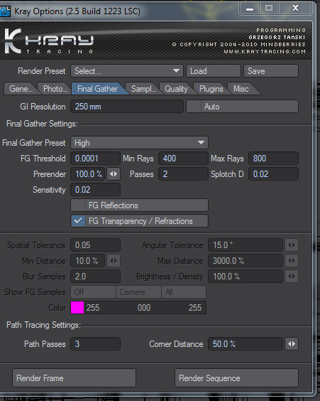

Re: a little kitchen
Here setup (maybe a bit extreme, but this is minimum)

How do I solve the corner problem of gi. What should be the settings tab.
This is screenshot from pre-render (better is to post final render - then we will see more information).
This effect will be less visible after finish render - if not then You can increase blur samples (for example 1 , higher parameter make problems with contact shadow) and increase FG min/max Rays (for example 600/1000, this is major part of render engine in Final Gathering. Raising up for example 600/2000 You increase time render around twice but quality of samples is higher)

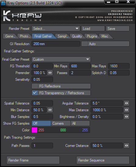

I think You should try with this:
Now is much better.
