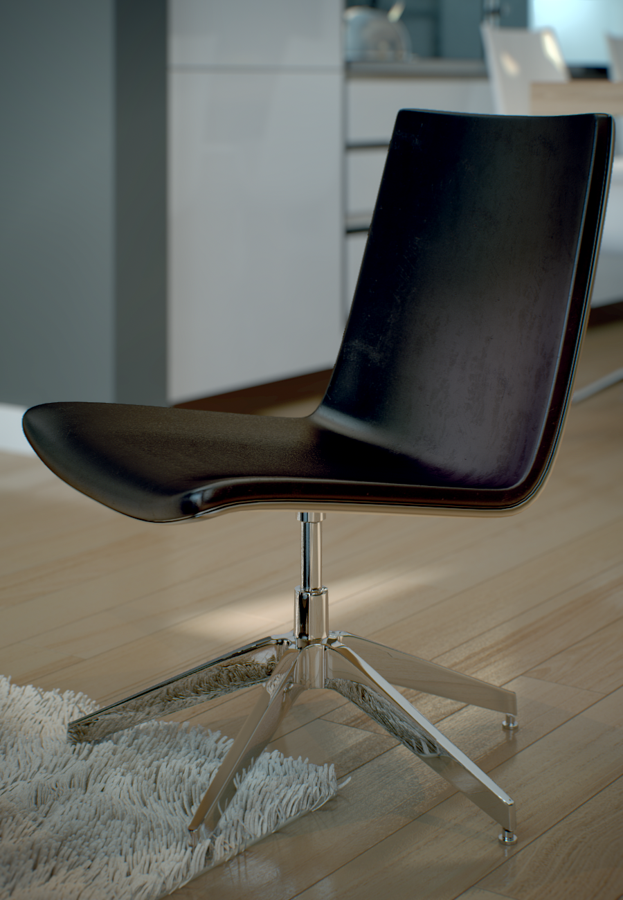

Some next updates (I changed some setup in light and surfaces also).
Re: ambient
Last one is my favorite.
It seems that you have increased your level in texturing.
We can all imagine how much a material integration in Kray engine would (will ?) be kick-ass.

Very good materials. I like your fabric, leather and wood. I guess you are using NODES to create such a materials. What method (many trials, known physical parameters for each specific material or any other source) do you use for creating these materials? Do you render all tests in KRay or in VPR? Do these materials perform differently in KRay vs LW standard render?
Re: ambient
Yes, exactly. Some surfaces has 4-6 different maps (different for bump, different for blur, diffuse etc) I Use only one map which I clone under LW many times and each of them I tweak with gamma and contrast + sometimes blur.Sometimes I create also bump map because is difficult under LW to get correct result. Is one think which MUST BE, this is HiRes seamless textures...I do not use textures under 2000-3000 pix. Textures I prepare by myself , even if they are commercial (clean from noise, save to PNG)cruisermori wrote:Very good materials. I like your fabric, leather and wood. I guess you are using NODES to create such a materials. What method (many trials, known physical parameters for each specific material or any other source)
Only Kray. Of course they different looks in LW render and this is correct (Kray is more physical then LW, are more bounce light, better transport of photons etc)Do you render all tests in KRay or in VPR? Do these materials perform differently in KRay vs LW standard render?
Since when I use new Sunsky plugin from LW I do not use VPR (before I used it for positioning of Sun...but now is easy to do with new tools).
