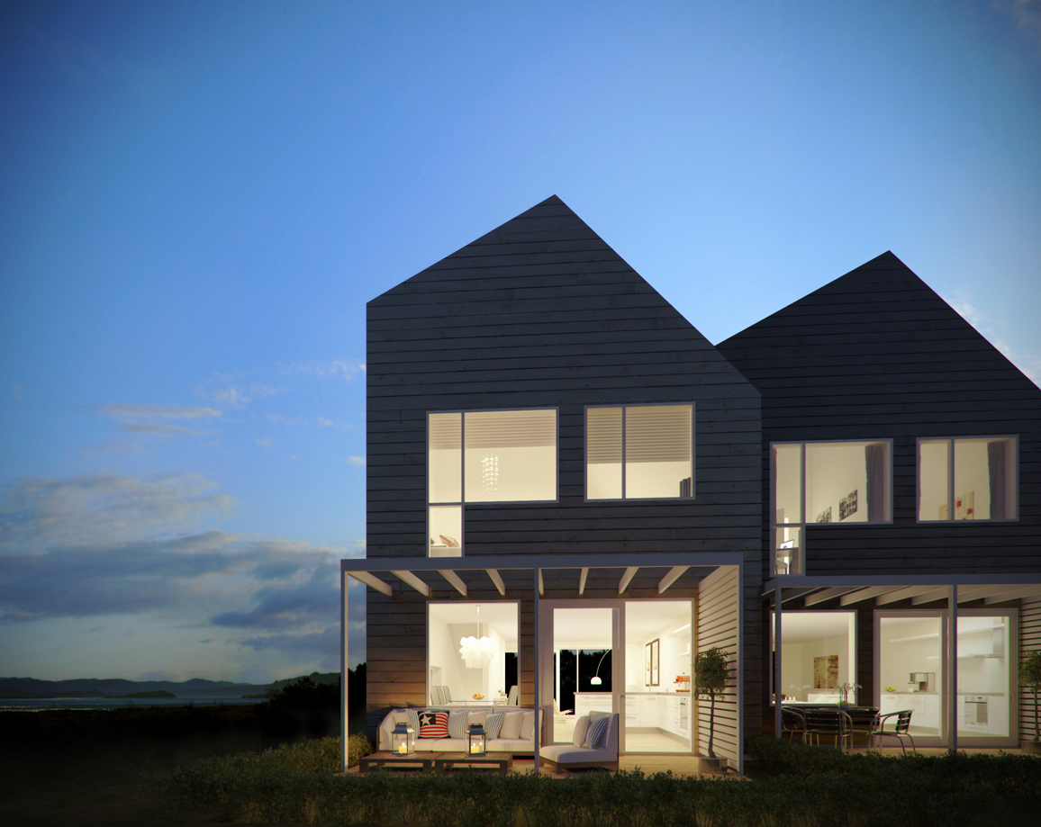

evening exterior
Re: evening exterior
perfect integrate with background!

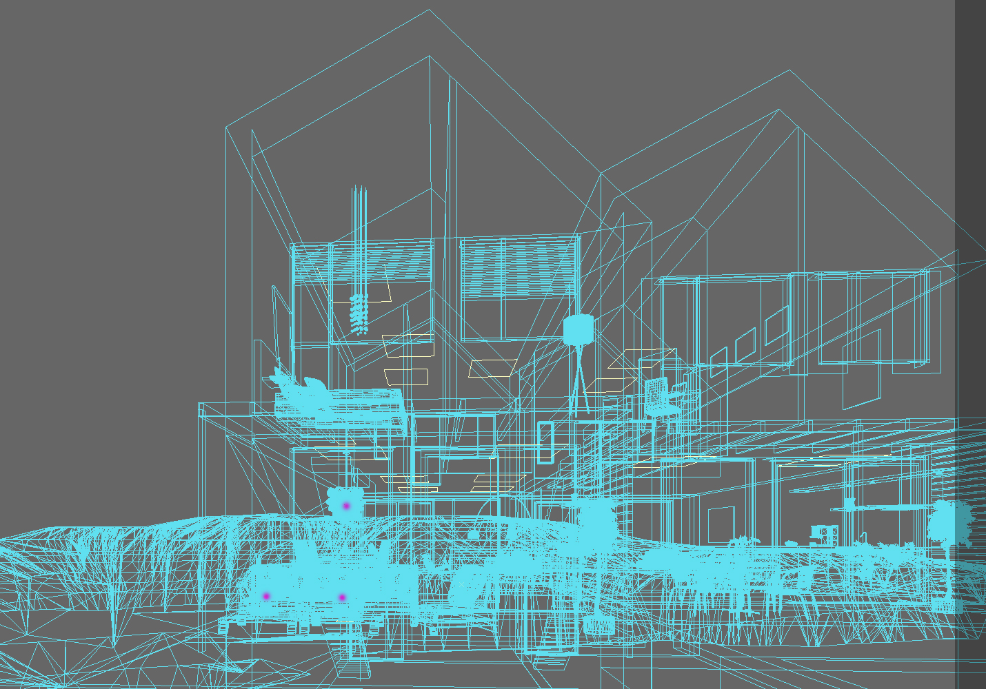

I would like see your lights positions in scene....
sure thing Janusz.................
the scene only has 3 sphere lights. one behind the ceiling lamp and 2 for the candles...............
they are way to bright but i didnt have much time to adjust anything.
the interior is lit with luminous panels at ceiling level
i have a hdri as an enviroment lumination also..................that helps the image alot!!
Thanks !
I asked because I see good quality render, also no noise on the plants...so was quite long render ...
it took 1 hr 25 mins to render at 2316x1440, so not long at all...............
and thats on a pc thats 4 years old now
one of the best night renderings around here. Congrats!
May I ask which HDRI did u use?
thanks jure............i got the hdri from hdri-locations.com
have bought alot of hdri's over the years but these seem to work the best with lightwave
WOW!!! Love the quality rendering. How do you used the HDRI in kray? Should try this later.
The lights are a bit strong but I love it!!!
Do you use Hdri on an object (sphere or box)?
no the hdri is applied as a textured environment............
