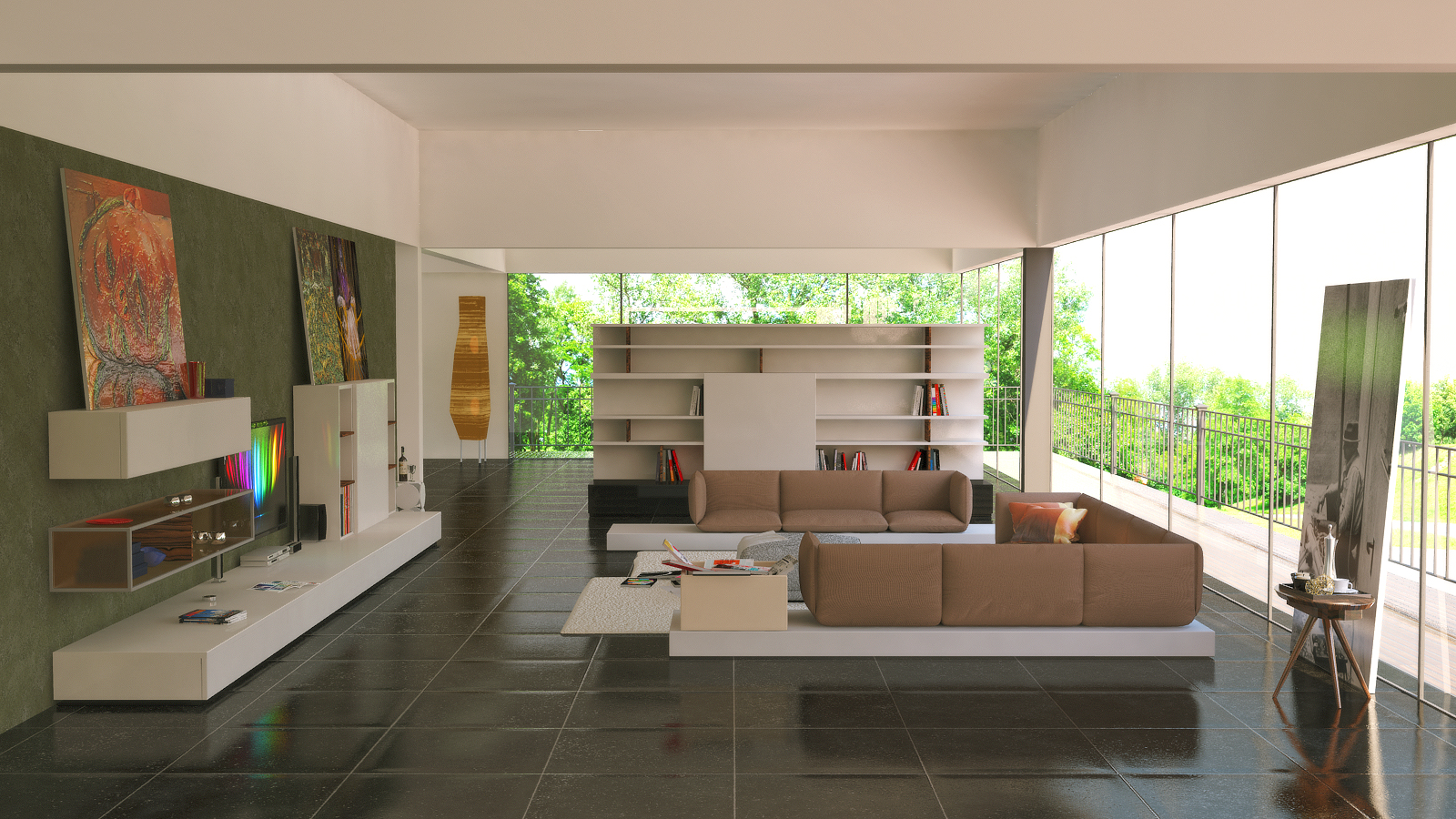

 Waiting for criticstest interior
Re: test interior
 Top part Crap!
 Top part Crap!
 but bottom very good. Nice GI... i mean light is every where and still good contrat.
congratulation !
Btw carpet should be with fur (more realistic)
I like right bottom part, is very realistic (exception moire effect on the sofa:

Re: test interior
Biela thanks
						Re: test interior
i like it
only advice : some more book in the library and more small flor tiles
Re: test interior
It looks good, but there's something weird about the floor bump map. If the tiles really have such a wide inclined edge it will be a nightmare to clean because all the water will collect in the ridges

Re: test interior
thomas wrote:It looks good, but there's something weird about the floor bump map. If the tiles really have such a wide inclined edge it will be a nightmare to clean because all the water will collect in the ridges
t
Correct...wrong bump map texture with too big seam
Re: test interior
+ 1 for the floor. All the rest is excellent
						Re: test interior
nice start! and one more in the chorus: bump map (if a tiled texture was used for the floor) or smoothing (if u used real geometry for the floor) is definitely wrong...
another thing i would do differently is the glass material, as usually you would have a double layer of glass for such big surfaces, the material should be more visible, also on the reflections side. as it looks now, the window frames are "filled with air".

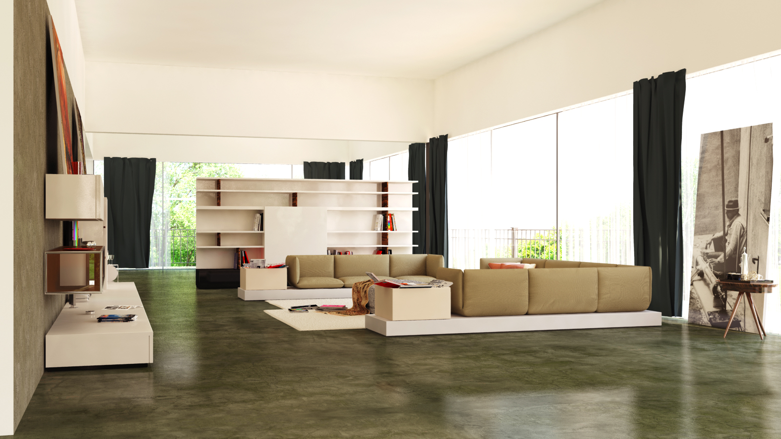

Re: test interior
If You will change ceiling for more interesting and will add curtains (some white , some dark) and fur for carpet + more books on the shelf...will by very good render
