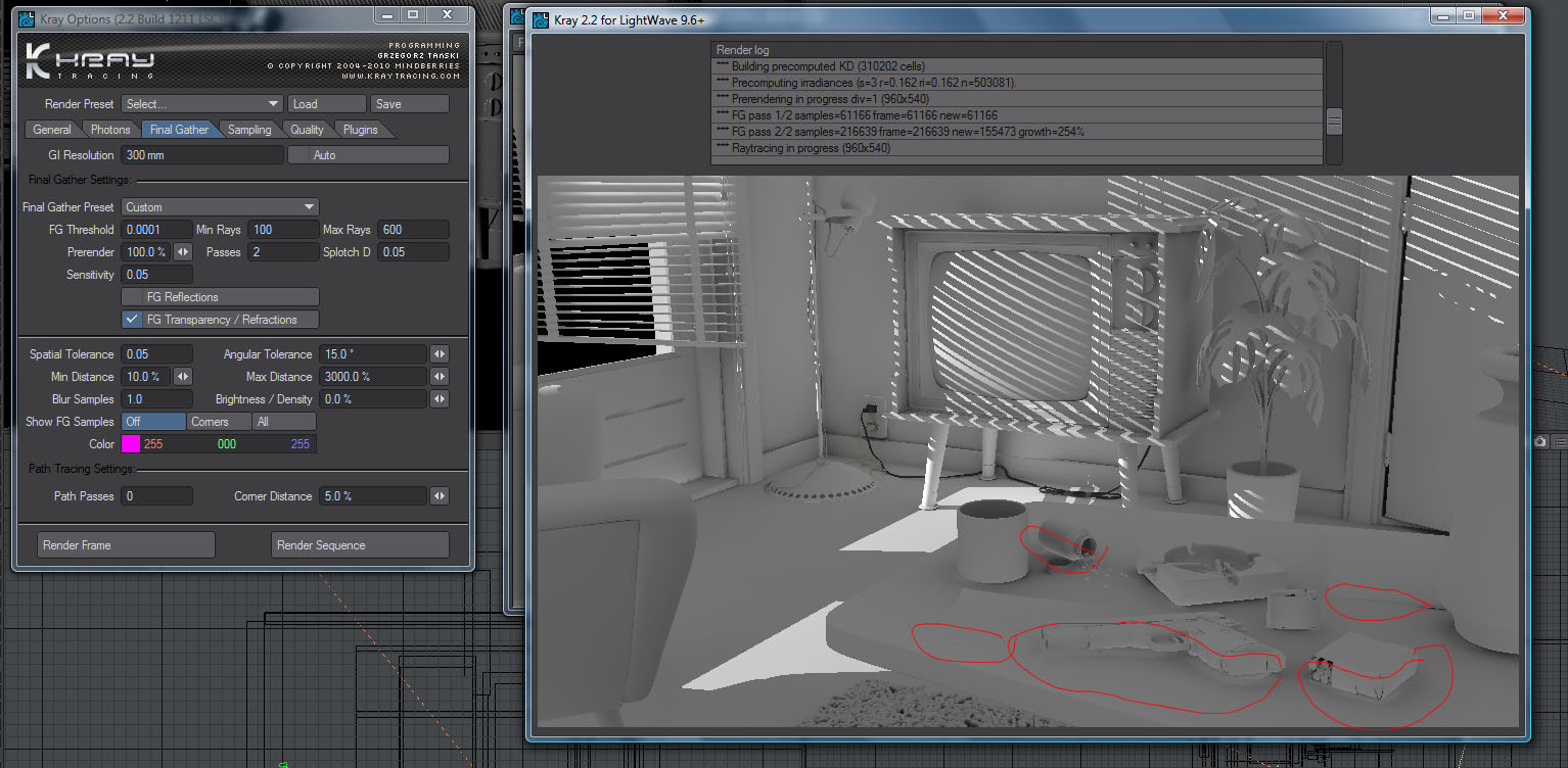

Hi Jure and Januzsz,
Thank you both for helping me on this project.
I did the photon-tab tutorial (the videos) and it is very enlightening, exactly what a tutorial should be.
Here is a picture from my photon-tab, with the result. It looks much much better than before, but still it has some problems.
As you can see in the Final Gather image there are still some strange bright spots and there are no good contact shadows on the photo (under the gun), the gun and the cigarette pack.
How can I improve this?
Cheers,
Simon

Re: Help with getting good result...
On FG tab change "PATH" setting to 1 or 2. Also you may want to try Lightmap instead of Photonmap?
1. I suggest use LIGHTMAP in PHOTONS TAB.
2. Still PATH PASSES option You have 0
.Should be 1 and 50%-100%.
3. With that small SPATIAL TOLERANCE You can use bigger BLUR SAMPLES (2 or 3)
4. Also parametr N in PHOTONS TAB should be bigger (3000-5000 is good level, enough to smoth nicely photons and make in Final gathering phase better and faster interpolation. I know, during photons shoting phase high parametr N make longer first step of position photons...but better is sacriface 1-2 min of time render to receive better GI (You will . For fast prev I suggest small N (for example 200-400) and PRERENDER in FINAL GATHER as 0 without passes...
I think your time render should by much faster (around 10 min). Very high setup you have and still PATH 0.Spatial tolerance is too small. Better use 0.06-0.08 and min/max distance 50%/300%.
