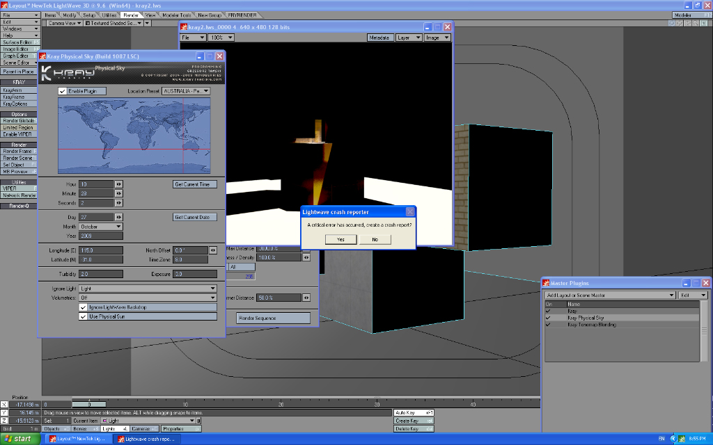

kray rc5 crashing
doing some simple scene and testing physky.
after changing turbidty to lesser value, LW crashes. and not only this, also after changing value to exposure and sometimes the value in hours too...
Re: Kray RC5 released
Please clean your config files. This can only be Lightwave problem since Kray PhySky is purely an lscript. If you can make this bug reproducable please send the scene to use so we can check it.jdomingo wrote:kray rc5 crashing

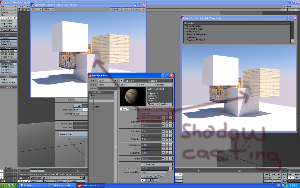

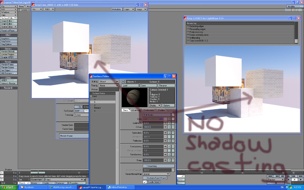

ok thanks Jure. attached here is the scene, after cleaning my config so far has no crash. but when i use node material (for the yellow brick) it doesnt cast shadow
- Scenes.zip
- (1.63 MiB) Downloaded 473 times
You are using Delta material node. Some material nodes can not be used with Kray PhySky currently because the node requires actual light source in scene to query. And since Kray PhySky does not use light sources from lightwave it cannot see this material.jdomingo wrote:ok thanks Jure. attached here is the scene, after cleaning my config so far has no crash. but when i use node material (for the yellow brick) it doesnt cast shadow
