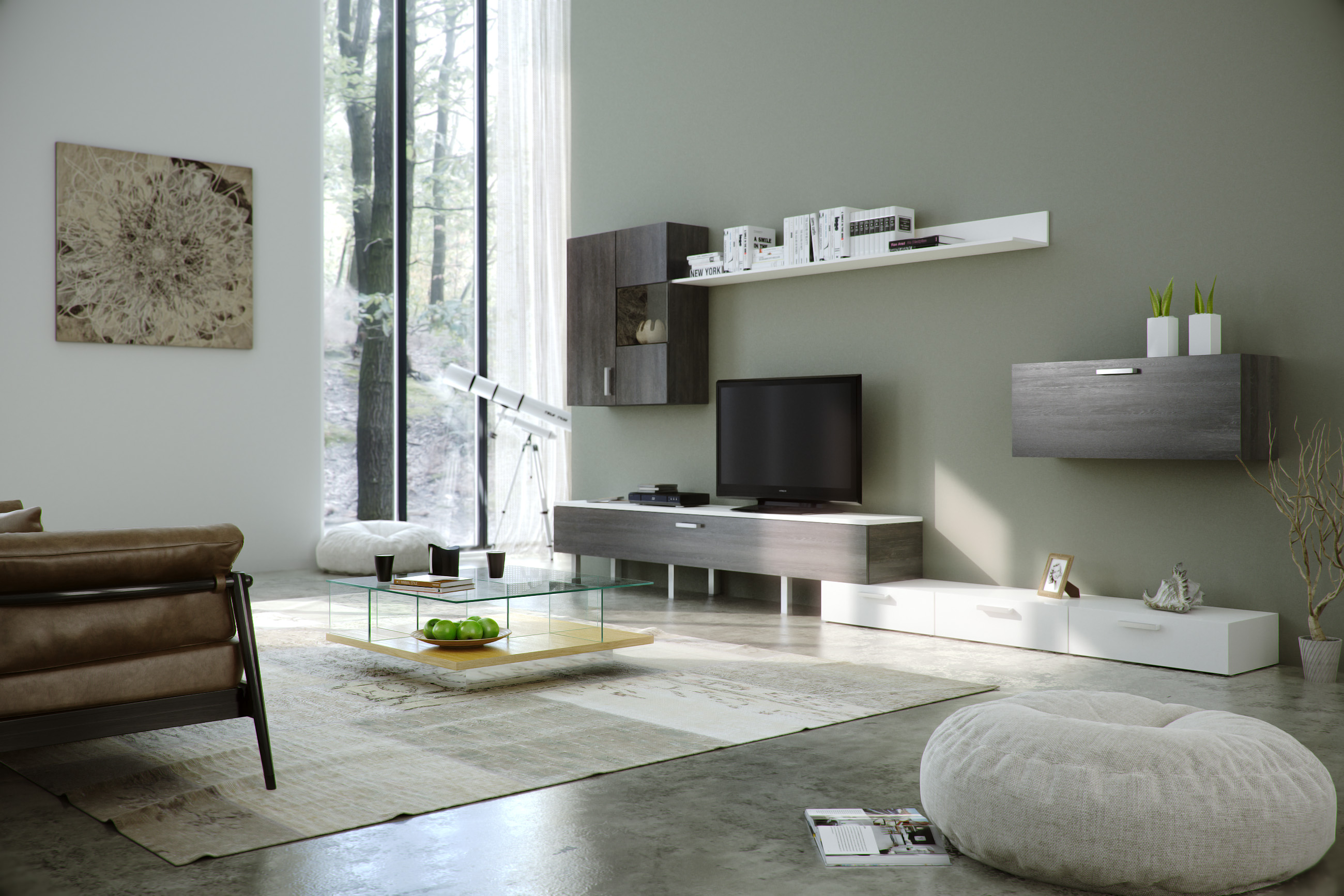

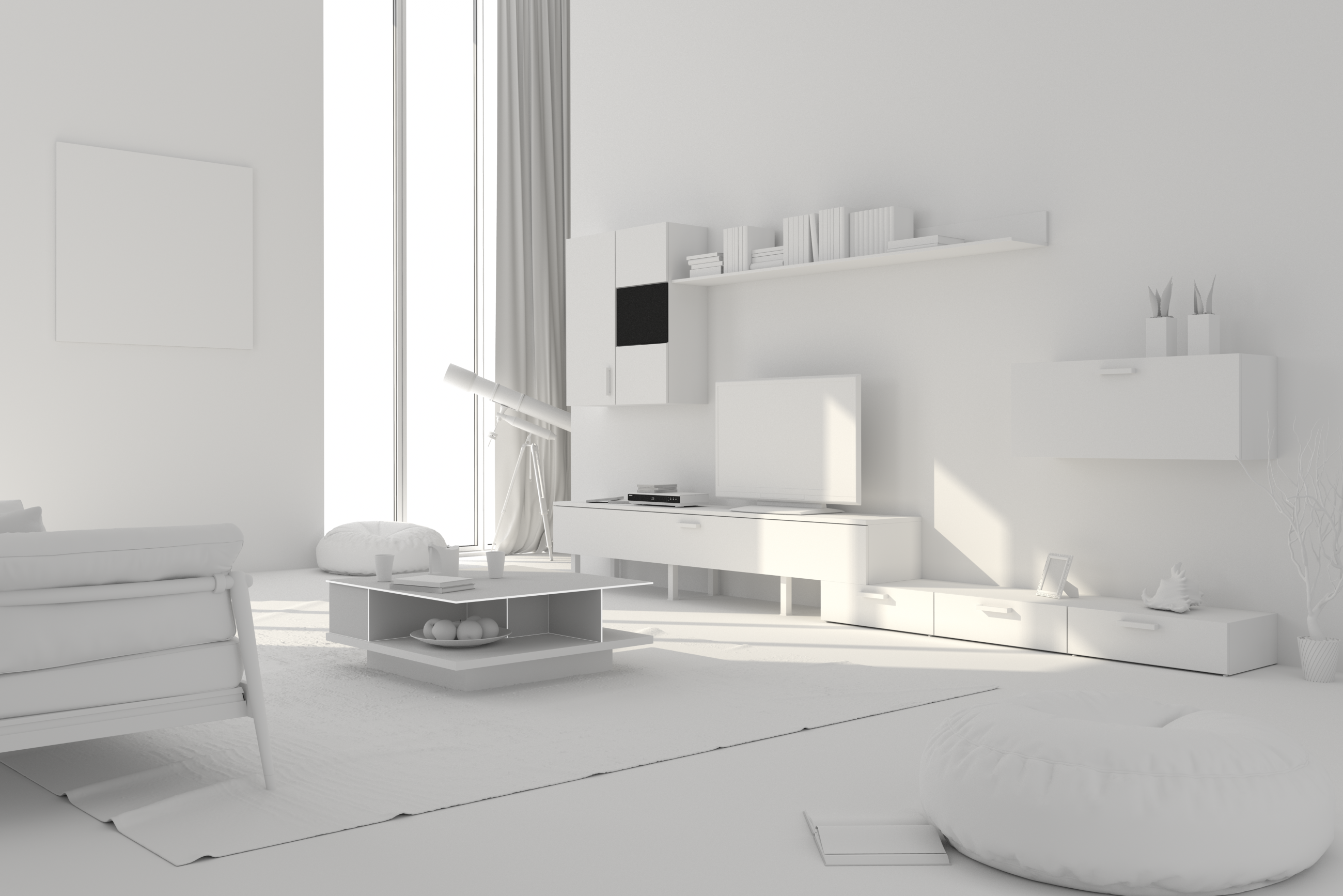

That`s the surprise for me, it seams QMC mode in new Kray works very fast!
I have to make more tests but in this moment using Final Gathering is senseless. I get twice faster time and of course almost ideal accuracy (very close to Path Tracing).
Time render i7 CPU 4.5h or 72 HT dual Core: 35 min.
QMC Rays 1000
							K2.62 QMC
