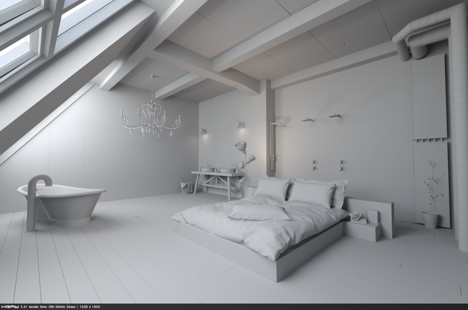

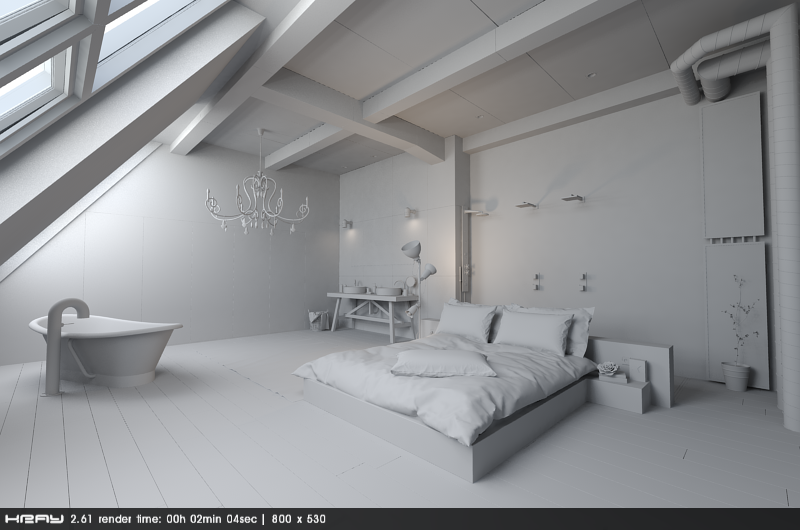

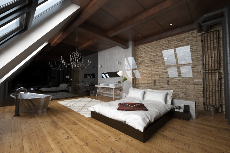

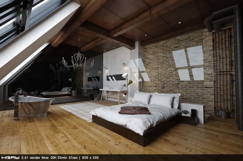

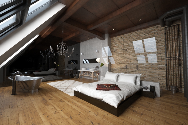

I gave last shoot for K2 because I wanted finish edge/corner detection processing in Nodes.
All surfaces Nodes. No specular. Time render is longer then V-ray but Kray has no shaders at all include no physical lights support inside engine.
V-ray RAW render:
Kray RAW render:
Here how it works:
