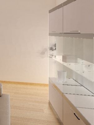

Hi Kray friends,
does anybody know how to fix this problem during prerendering. There is glass and behind I can see some black spots on the wall.

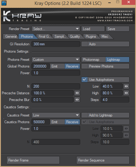

Try:
- increase amount of photons in Photon Tab. For example I use minimum 2.000.000. it is maybe a lot for small rooms but G. told me last time: then more the better for averaging information Photons cells. Here good setting for Photon Map:
- if you use Nodes turn OFF them ...maybe you use something unsupported
- if you use Dielectric Node change it for another system of glass
- all the time with problems in render use analyse tools:
it will show you errors from Photon Map side. If Photon Map is correct (photon map has good quality, gradient, no black holes, no missing photons) then problem is elsewhere.

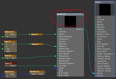

Thanks Janusz for your tips.
I found out, that when I switch off reflection of the glass this problem disappear.
Glass node (standard) creates this problem
Dielectric material is OK.

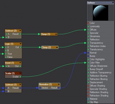

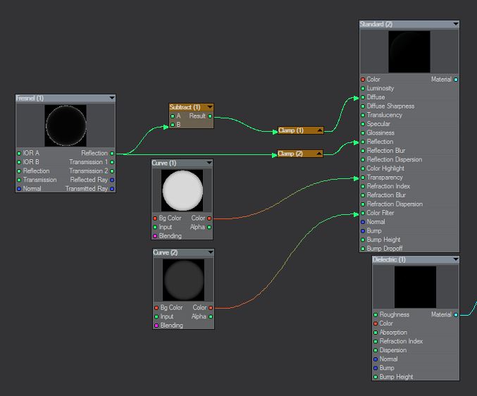

Hello,
thank you very much for detailed explanation.
I tried last time this node set-up for the glass and it created above mentioned problem (black spots)
If I connect it directly it works well (second picture)
I had a problem only with glass surface so far. I have to test, whether this set-up could be use or not with KRay.
If I skipped "Standard" node and connected it directly if worked well.
Re: Prerendering issue - black spots
Use only direct connections. Also be careful with compound.
