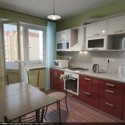

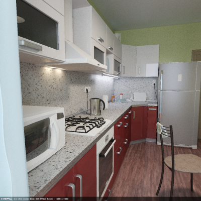

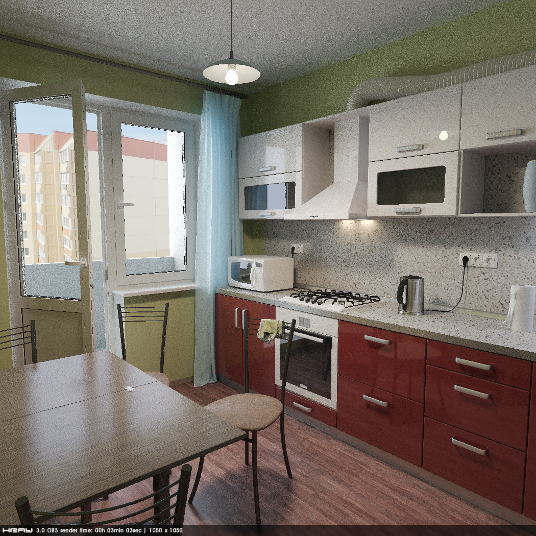

Example scene from nice FStorm render (GPU) Imported by me and remodeled for LW+Kray3.
Scene has only testing purpose.
Apparently I can not use Physky right now (reported bug with hot photons) so behind window are K3AreaLight and polygon background.
Also instead spherical light from ceiling lamp I had put Area Light.
1 million poly.
FStorm render 2xTitanium (lol that`s the piece of hardware) in 18 min: K3 low settings without AA (I think better will be just to wait for new AA engine in K3.1): K3 high setting (after Anti aliasing should not be visible noise at all): Of course no shaders - only basic Nodes. No extra physical surfaces.
1 million poly.

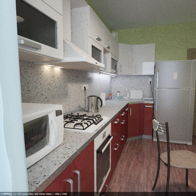

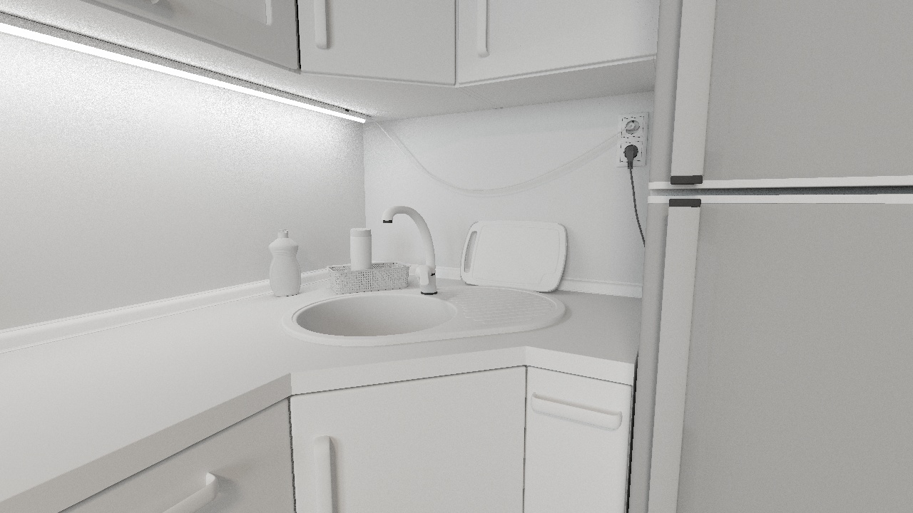

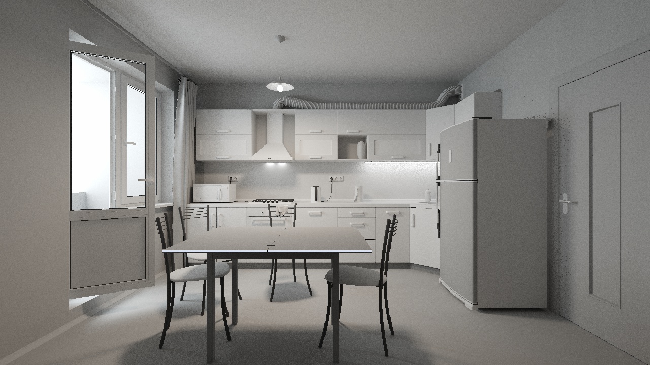

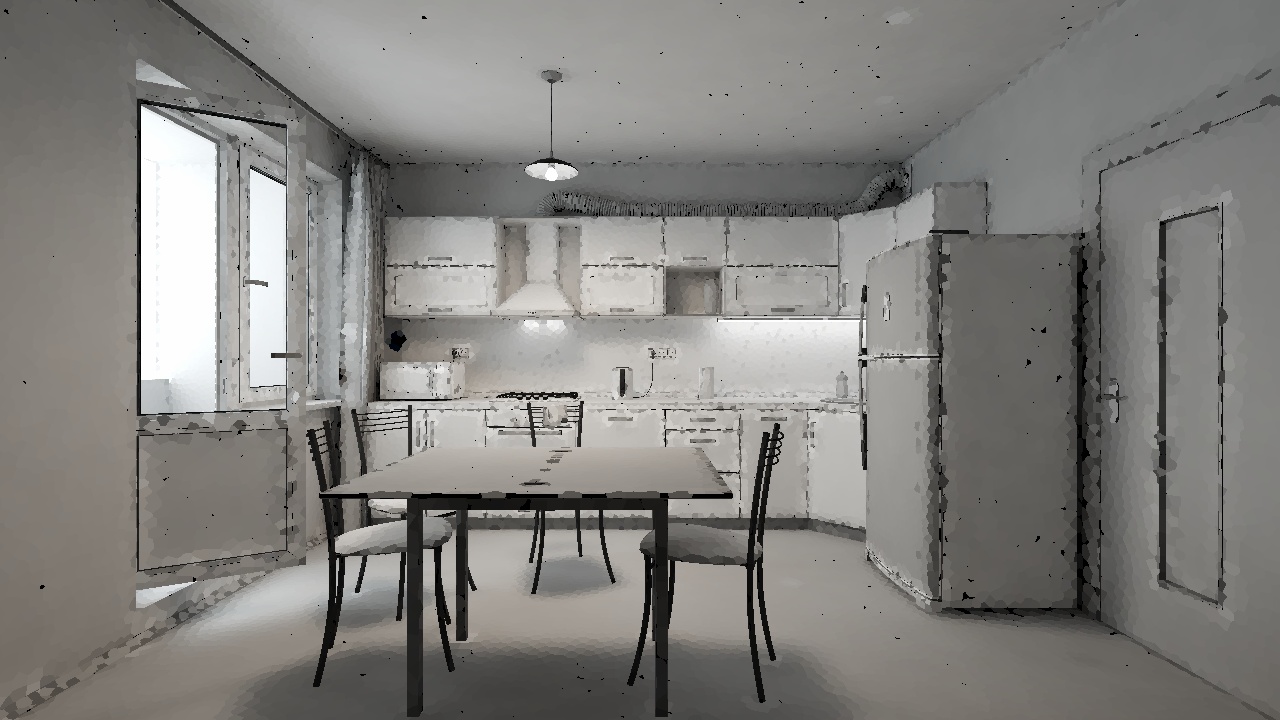

Some extra technical renders done in 15 sec:

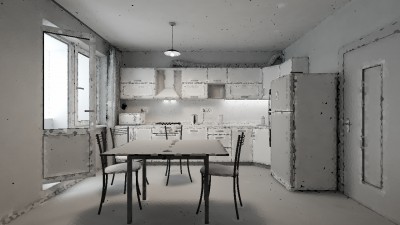

Precompute 300.000.000 photons of course in PhotonMap system:

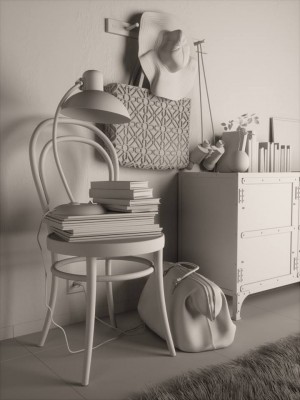

I did not mention: without shaders he would render that great images.
here is override from GPU render: Do you see something extraordinary?
