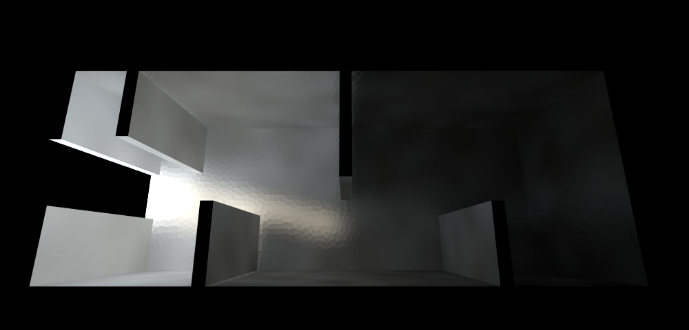

Yes is very difficult use them and perhaps I am only one who know how deal with them :( .
Skyportlas will be fix in next Kray and finally will work with physical sky from Kray.
Kray is created for photon mapping and final gathering so this tool is necessary for that. Photon mapping is very strong interpolated method - from infinite amount to thousands pieces reduction must create problems with correct position and power - why Skyportals are important to help engine reorder these photons.
Here small test, how it`s work. You can notice very accurate corners, no splotches
and light leaks. The different is big but more bigger is You switch to Final Gathering - then render is much faster, much cleaner, light is better balanced, AA is even faster.
Skyportals works now only in Photonmap mode (must be lumi sphere as source of light)
To test normal mode without skyportals just switch to Lightmap.
You can see in renders big different between both method and how important are skyportals. Of Course when You use Path Tracing You do not need them.
Have nice test!
Skyportal_test.rar
(9.04 KiB) Downloaded 359 times
