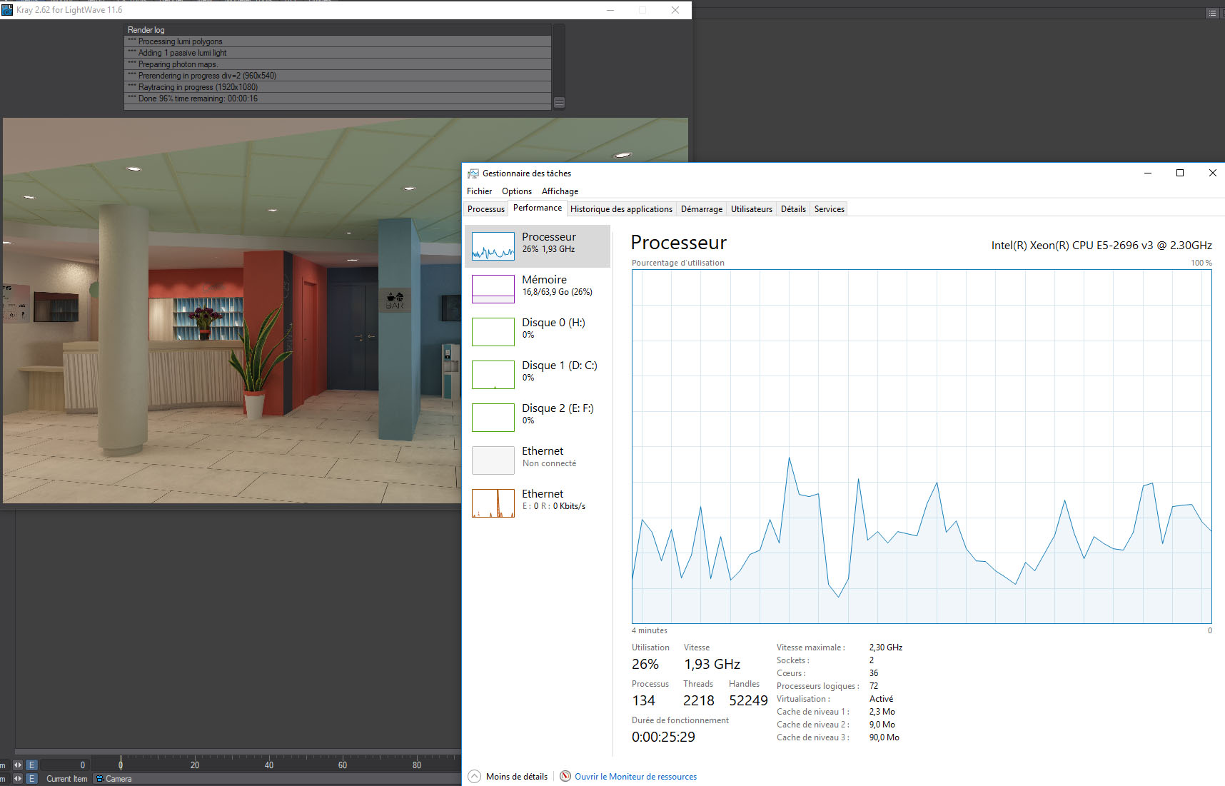

Hello everyone,
I have a problem with my new PC. When I render a rendering, the preparation phase is very long, sometimes longer than the rendering in itself. 3-4 min for preparation GI, less than one minute for rendering and 2-3 min for the "antibanding" phase after the 100%
If I cancel the rendering I sometimes have to wait 8-10 min before I can return to the layout.
It does on all my kray scenes.
You have an idea?
Thank you

You can dowload my 400 Go disk work?Janusz Biela wrote:Probably deep recurse or instances problem.
Send me scene: janusz.biela@gmail.com via wetransfer (confidential of course) I will check.
I have this problem with big scene, over 1.5 million poly, many instance veget and objects and i suspect problemb with RAM instructions.
My hardware, bi xeon e5-2696 v3, Ram 4x16gb 2400 cl17 Ecc registered and parity, MB asus Z10PE-D8ws.
I render test frame (960x540 pixel), click on "render frame", 3min for loading and calcul kray, 40s "raytracing calcul" and 5min for return in layout for view render.. For simple texture test is very long.
Even .lws with my i7, I do not wait so long once the calculation is finished and the image go faster in raytracing calculation.
need bios parameter with this RAM ?
Thank you for help.

Hi, I have just re-tested by comparing two PCs.
850pt in cinebench r15 for an i7 (win10 64 family) and 4500pt for the bi-xeon (win10 64 pro).
The same scene without "cache irradiance", 55min on i7 and 10min on the bi-xeon. It's OK
With "cache irradiance" and "shared for all frames" already calculated, 19min on i7 and 10min on the bi-xeon with idle processor !!
I do not understand anything anymore. I do not use plug-in, only classic nodes and classic lightwave surfaces.
I timed when I canceled a rendering in progress. 35s on the i7 and more than 6min on the bi-xeon!
Kray is not compatible with some CPU instruction? Or specification ram (ecc, parity, ...)?
Thank you
