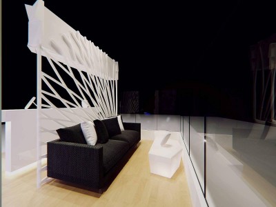

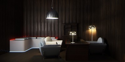

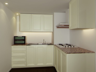

hey man i think ican help on this . u want to say u have room without windows or like night shot oky ? is this what u mean ?djwaterman wrote:There's no information in the tutorials, manual or online on how to create Lumi panels, I need to light a room with no windows. Strange this information is hidden from view. Can anyone describe the process?
here some exmple i did few years ago without sun light or exterior lighting . no windows . and light source come behind camera Lumi panel + area light invers distance x2 .
Re: How to make Lumi Panels?

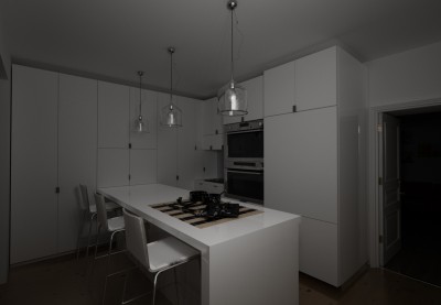

here kitchein night with small square lumi have luminosity mybe500 i dont rememver its depend of ur tonemapping and surfaces setup + area light is behind that lumi panel . try this tips on window ^^ .
good luck friend.

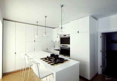

ps : that night kitchen in previous poste i put on with day liught and sun u can see the difference. kray physky is really really good. i dont know how kray3 with his new physky2 will bring to us ^^ . i belive kray3 will put all of us in next generation and next quality render ^^ . just think only on this vpr

why i use small square lumi u can go to quality tab and check area light visible . u dont need lumi light. i use both of them area light and small square lumi cause it give nice light ^^
