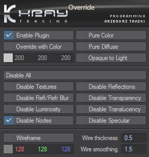

To switch OFF Nodes simply use Kray Override plugin:

Here's my pre-compute pass, pre-compute without the dielectric vase and pre-compute override:

I am using dielectric in the scene for the glass vase on the green shelf, so yes. But in the second render of the three posted above I replaced the dielectric with a normal simple node-based surface, and the photon map looks almost exactly the same. The third render is Kray override without nodes and the photon map also looks very similar, so I don't think the dielectric vase is causing any issues here.
