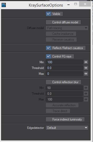

A question I have is on the vegetation. There is a lot of grass and plants that are instanced so I used the Kray surface options in the shader tab on all the vegetation. I have attached an image of my shader settings, Are those good settings to use for vegetation ?
Also I noticed that pathtracing seems to render faster than FG or QMC. Both of them were extremely slow.
The only problem I was having with path tracing was the noise but it looks like if I reduce the recurse to 4 that helps with the noise also.
Is there a way to optimize the scene for QMC or FG that would give me good render times and less noise?
