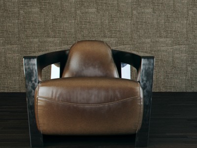

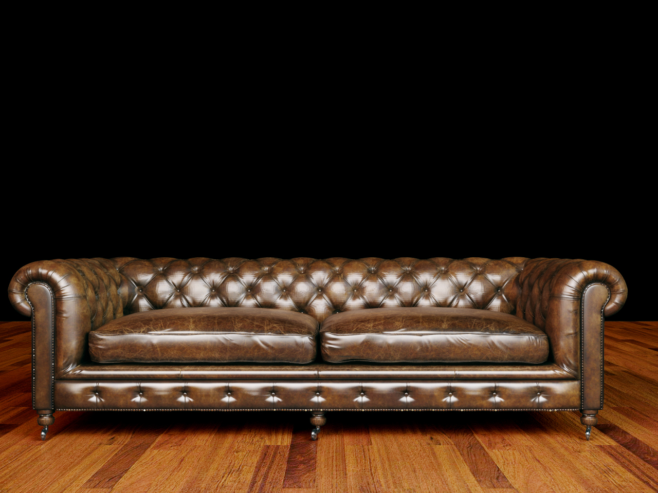

Here my test .
0 node . only basic surfaces . i use color gradient slope .

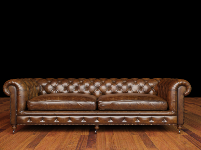

Re: Leather sofa for material evaluation

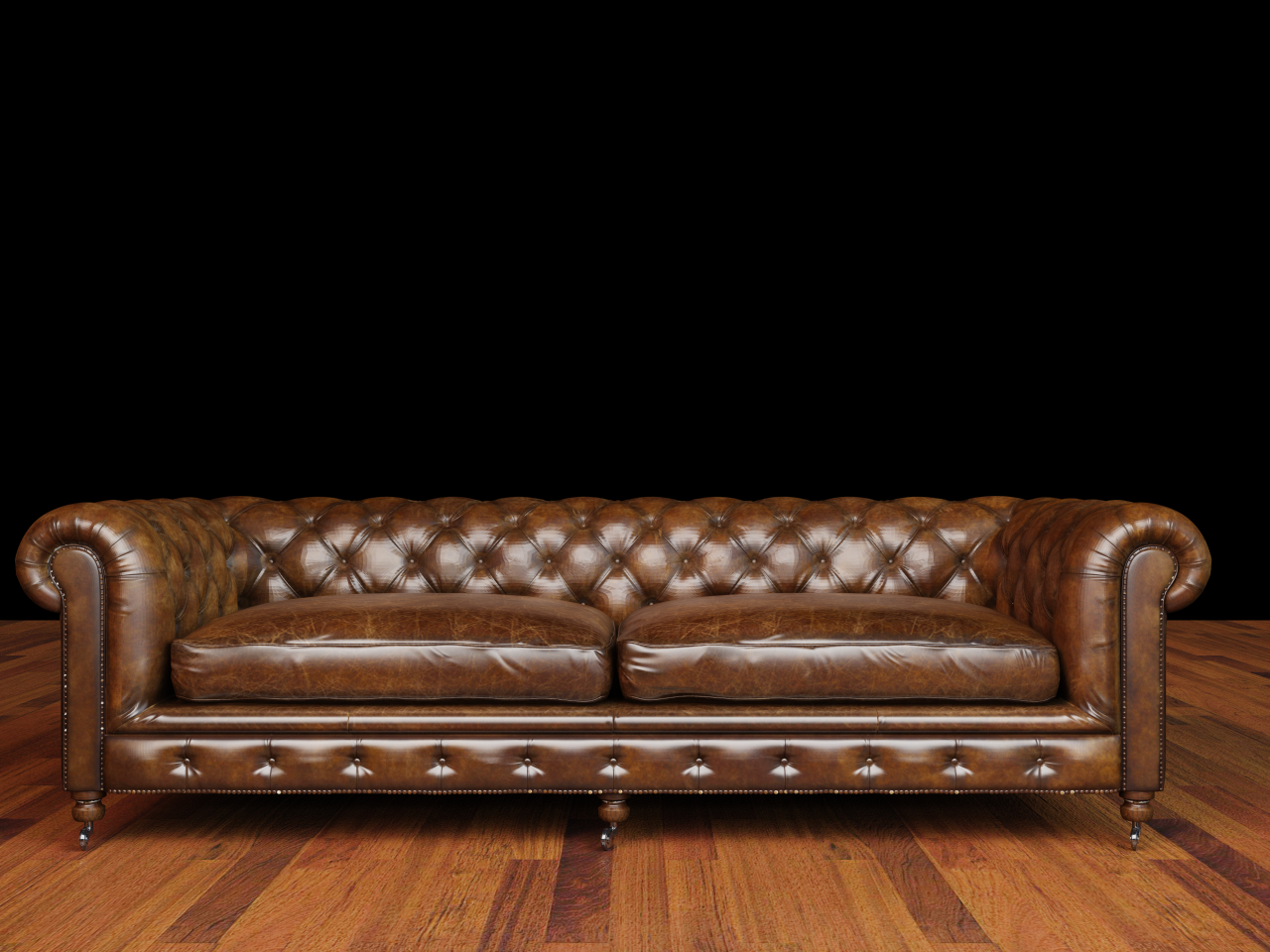

here my new test with leather . the same as u have :D :P .
Kray render ofcourse . 0 node . ony basic surfaces . + photoshop poste process :D .
1H render time  Qmc .  i have old i7 950 not dual xeon thank u .

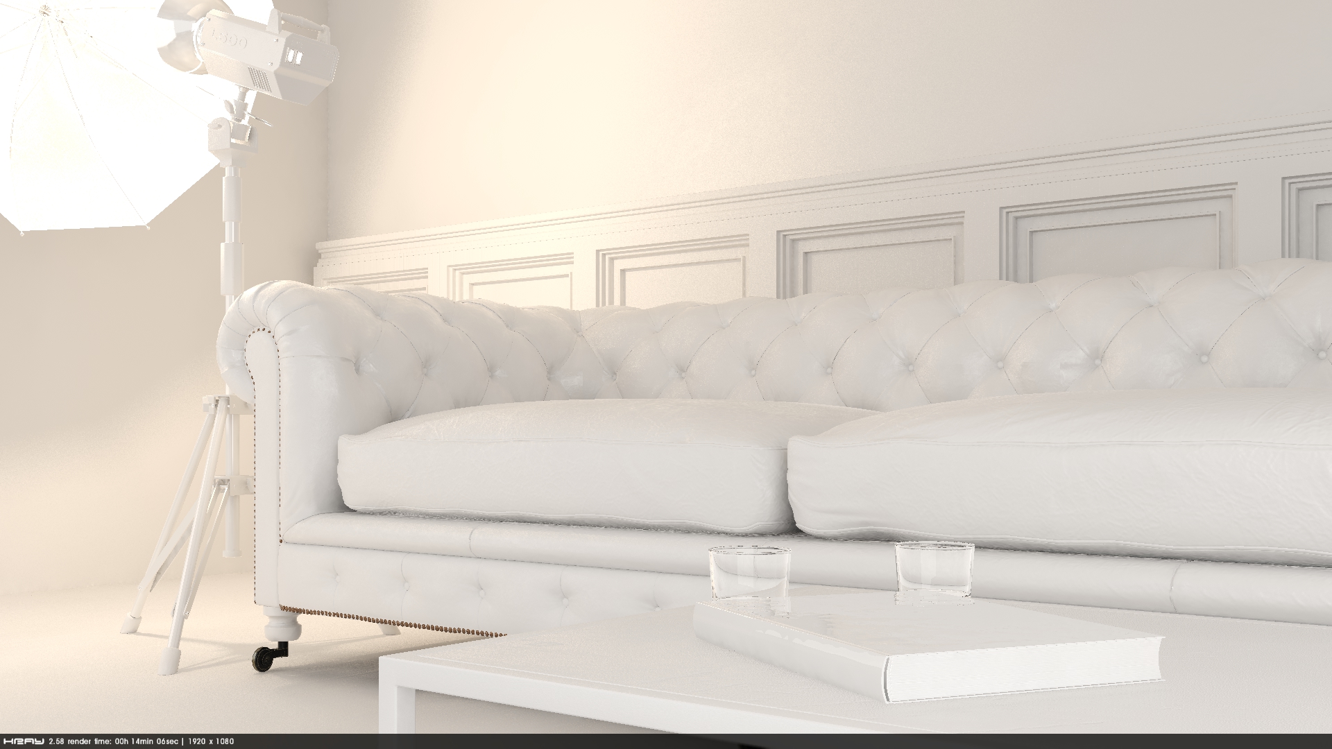

here the raw!
raw render
raw render
Post by NiGMa »
Sorry but it looks like the couch is covered in clingwrap! Need more refl blur.
NiGMa wrote:Sorry but it looks like the couch is covered in clingwrap! Need more refl blur.
u think its hard to make blur reflection ?
Post by NiGMa »
No, its not hard, you just increase the value right?
Post by graflukas »
It's quite good. Clingwrap - but just a little. Some smoothiness I think. I see some unsmooth square polys or unwelded polys.

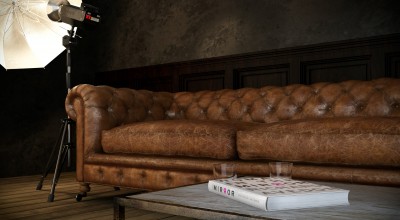

Post by S0nny »

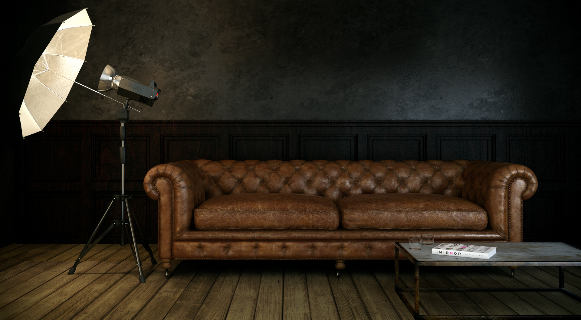

Hello guys, just a small update: spherical light + reflector, a small table and a different wood for the boiserie on the back.
I don't know but it seems to me that glass and the book have very subtle contact shadows, but everything else does.
Anyway, any comment appreciated!
p.s. I forgot the power cable! :D
The glass needs multiply reflection. Book seems for me too high diffuse (problem with Albedo). Both I can not show because still I test it in my Nodes.
...still waiting for floor :wink:
S0nny
Posts: 75
Post by S0nny »
Janusz Biela wrote:The glass needs multiply reflection. Book seems for me too high diffuse (problem with Albedo). Both I can not show because still I test it in my Nodes.
Yes the book is totally too bright, I checked the texture is 255 needs less brightness.
About the glass: multiply with another reflection?
Let's do this experiment, you tell me what floor you want and I'll try to replicate it, that's a good exercise for me!
I'll try when my clients are not pressing, maybe it will not be immediate :D

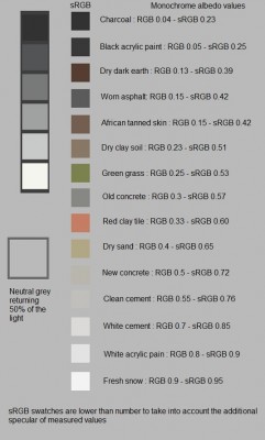

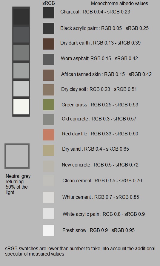

White color should be at maximum 220,220,220 RGB in other way you reflect too much photons which is not physically correct. Pure White color should have Albedo on the level 85-90% Albedo so if you want use diffuse control (to emulate Albedo) RGB level + 80% diffuse.
I found something that, maybe will help you:
S0nny
Posts: 75
Post by S0nny »
Yes, I have a similar scheme because when I used Maxwell and the principle for rgb values was the same, but sometimes I just copy paste materials and I leave behind some check on texture value.

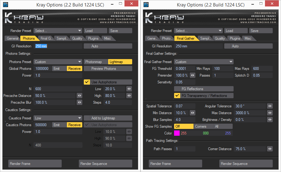

here's the last one

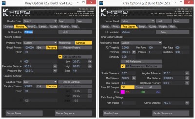

Can you render it in override mode? I would like to see pure GI samples because I suspect you have too low Final Gathering settings.
S0nny
Posts: 75
Post by S0nny »
Yes! Here we go:
edit: not so important, but why it says always Kray 2.2 in the window settings?
Is no so bad GI quality but can be better with long time render of course.
This is version of Core Kray.
