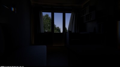

Needed to create an animation of the interior apartments, but get too much noise. There are no ready-made presets for Global Illumination settings for the animation of the interiors?
Re: Animation: Photon cache vs GI cache
promity wrote:Hello.
Hello
Can you show one or two renders? I suspect you talk about reflection blur noise - if yes then it is completely different problem not connected with GI solution. Also you can post kray.cfg file here.

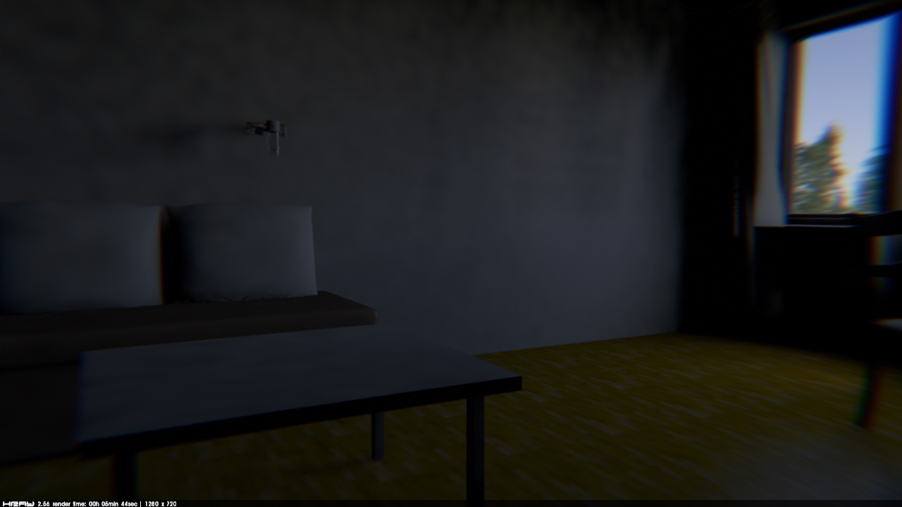

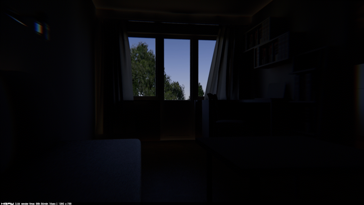

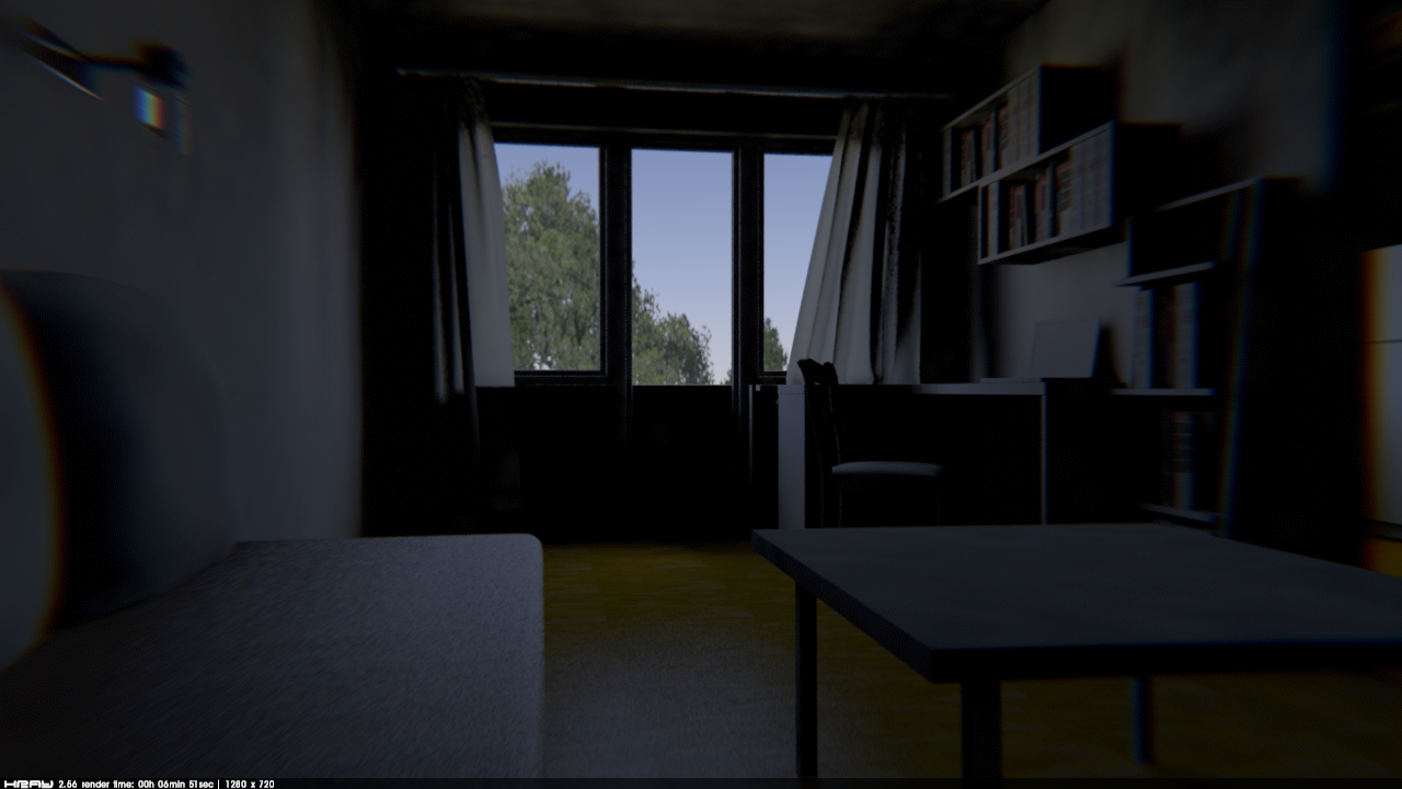

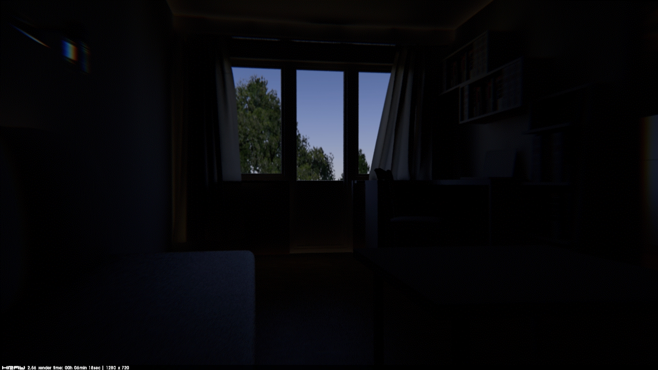

Another problem, even two. The first - the image appeared dispersion effect. Where did he come from? Motion blur is off ...
Second - here are two images of the same frame, rendered one after another. Why such difference?
kray_settings.KGcfg
(1.17 KiB) Downloaded 269 times
Thanks for these files.
There in cfg Kray file are some major wrong Kray settings, also in LW with light.
Because is too much to write about these subjects and I suspect also you are beginner of Kray software, so please contact me via Skype: biela1972.
If you can not, I will write here answers but it will take time to explain everything...
