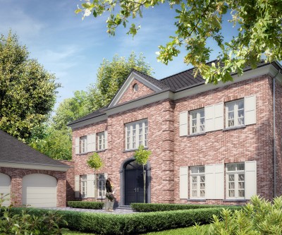

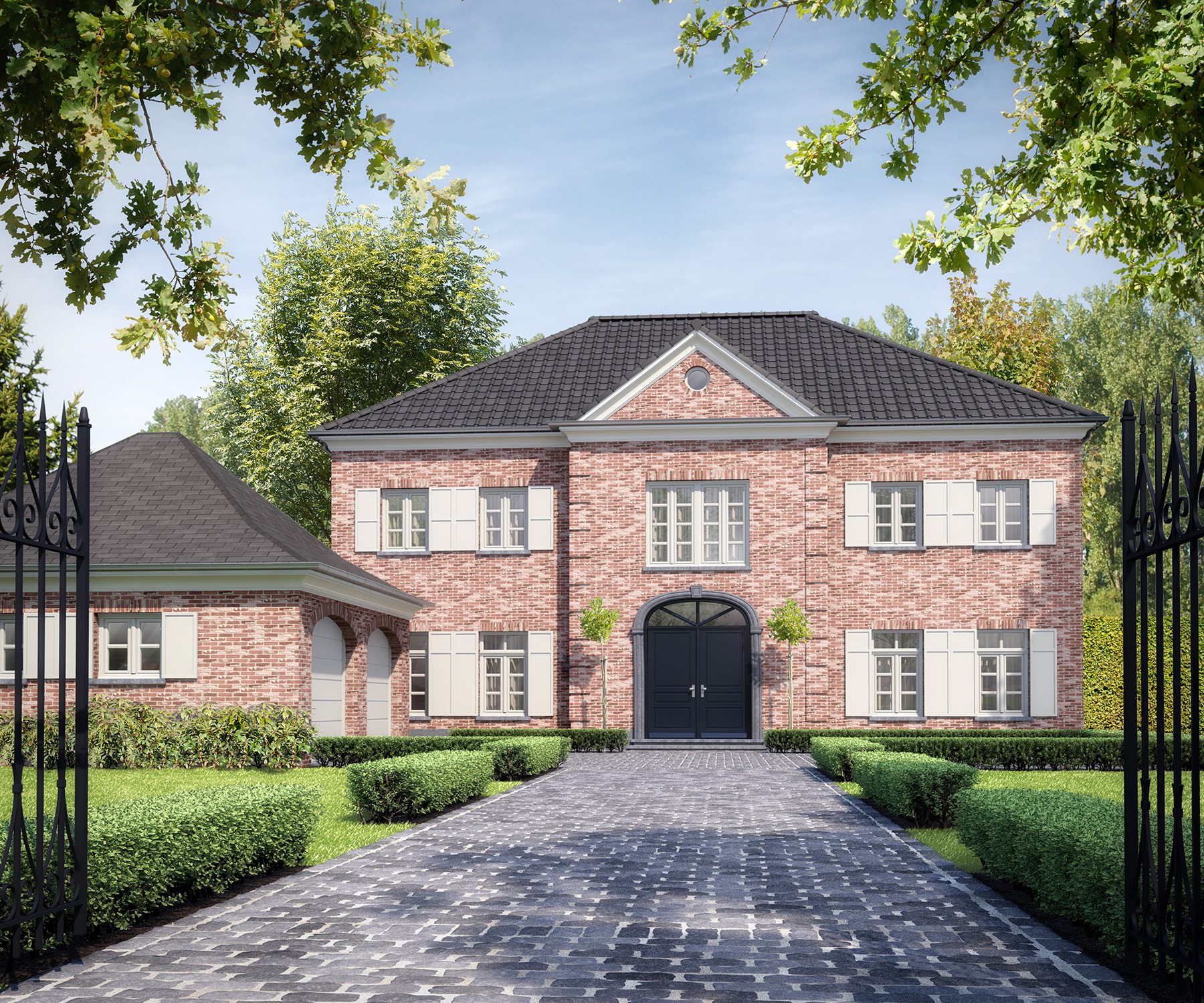

Just a collection of my renders :)

Good job :)

i suggest you using hdri . u will get really nice color and realisme . +phyksky only sun . kill lightwave light "distant light" and uncheck "Ingore lightwave backdrop" from physky kray .

Well I never realy managed to get good results with HDRI, maybe because I don't have good enough HDRI images.
I always render Physky (LW SUN ignored ofcourse) with ignored LW backdrop and sometimes a dome to 'fill in some shadows'

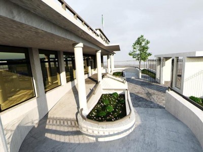

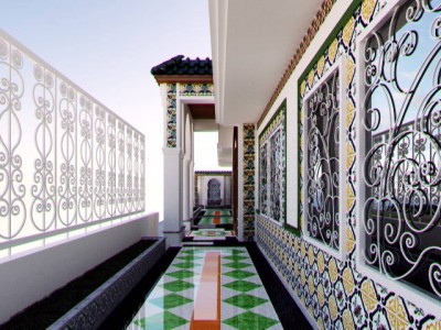

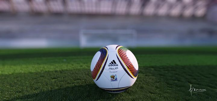

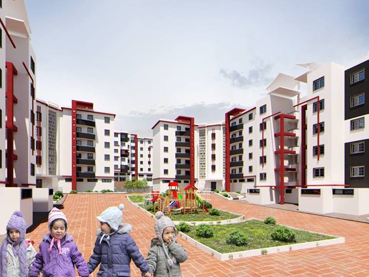

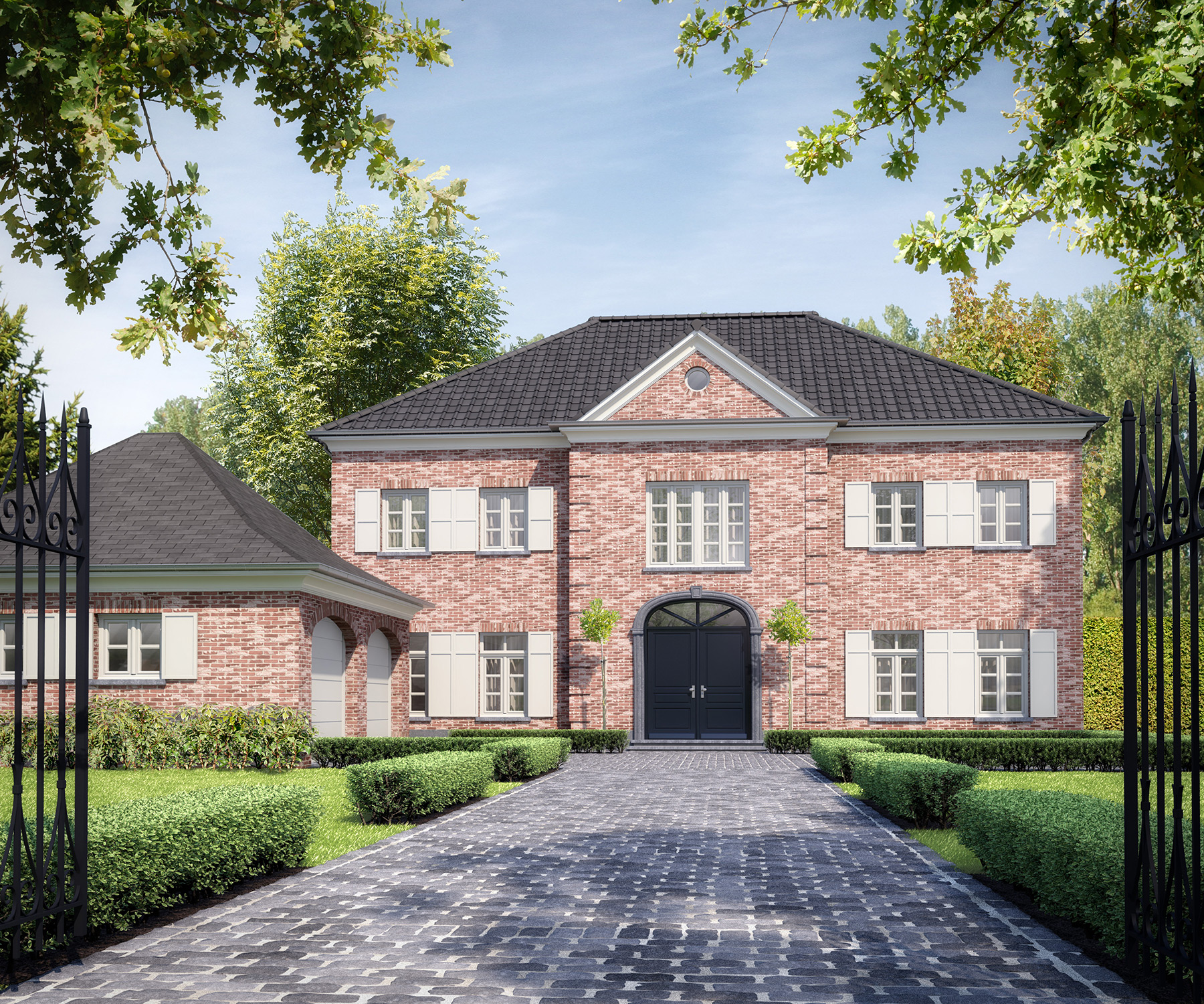

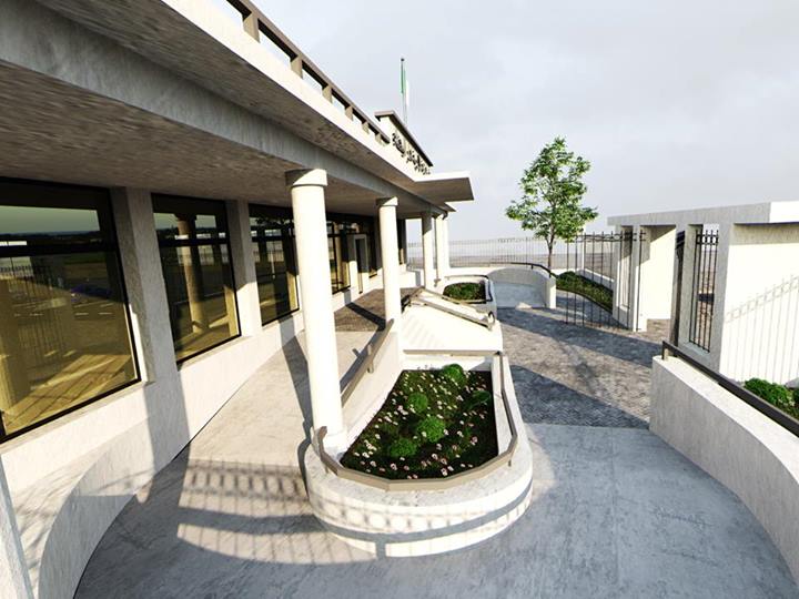

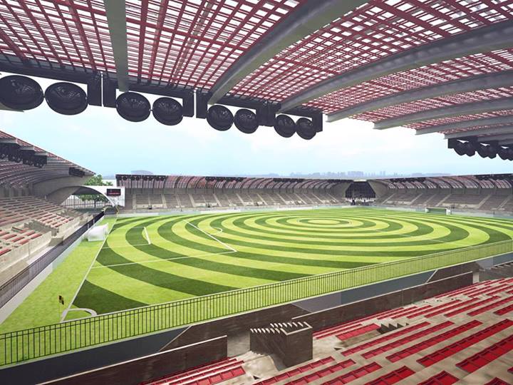

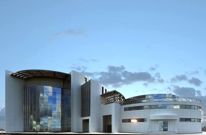

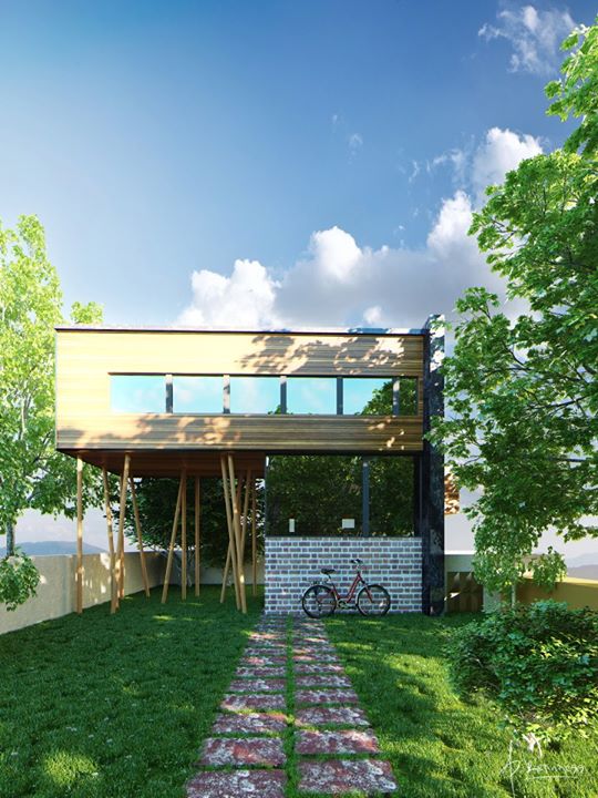

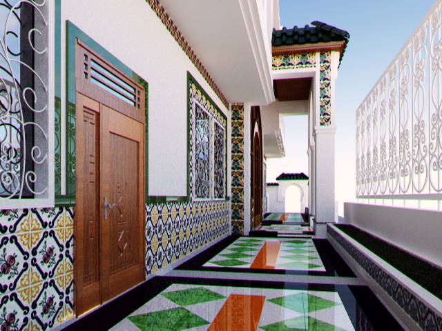

here few exmple render with hdri idid some old and some new .and +physky sun from kray .
Re: Just some random projects

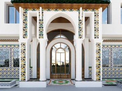

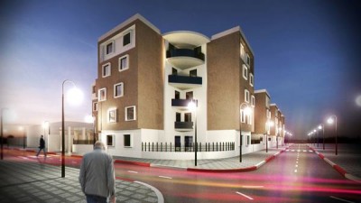

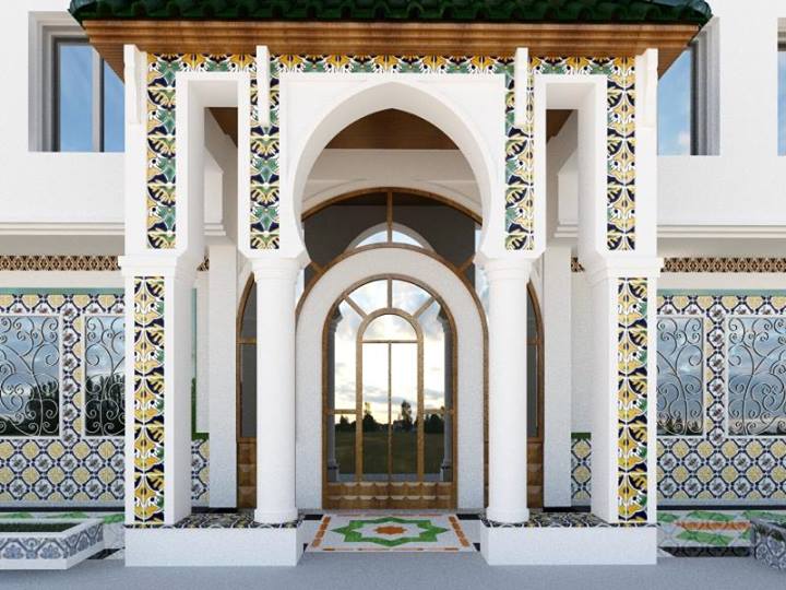

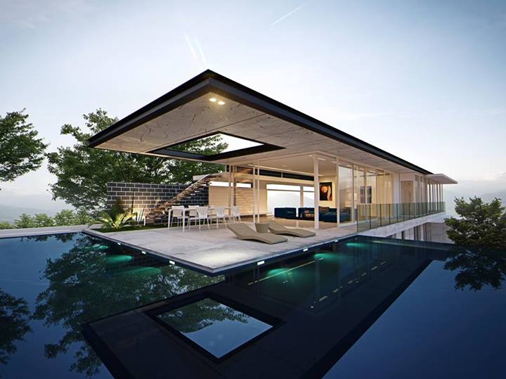

other one . some new and some old .

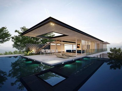

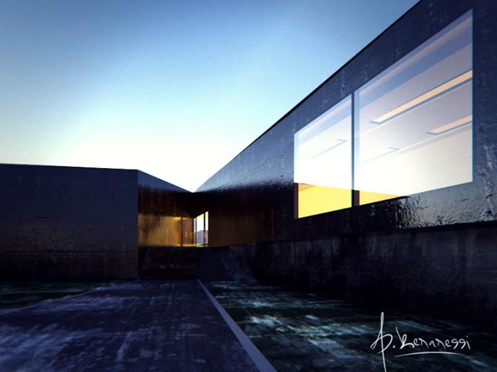

other one
all thos render is use any hdri image u habe its works . ofocurse with good kray sun position . and good tonmeping its done . hdri just give u mood and lighting . and u can tweak dat mood as u want .
as janusz said he is right . pohontmaping hot . not good but if u add gamma they will be good . when using hdri in envirement . spherical ball Y axis . its done . + gama 2. and over up to 6 or 7 . i never up it into 7. but as i said its depend hdri u use . any hdri u think exterior its good .

Also good stuff :wink:
