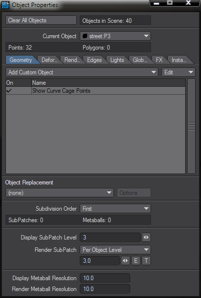

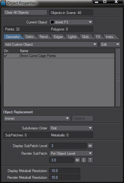

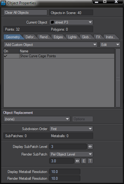

jnom wrote:- basic LW plugin for showing curve in Layout with colours and arrow (it`s help very much)
- bacic LW plugin to fallow object on the curve with Align option.
Looks effective. Which plugin are you using to show arrows from curve? Which method you use for second? Parent to curve then align to path?
For showing curve in Layout basic module: For following: Align is include so no problem with orientation.
Also Curve beginning/end of curve can be flipped (we change direction of moving object)
Control by curve has one problem: the speed control which is determined by distances between points. But this can be done by LW CAD (will show later). Another way - curve must have equal distances between points.
Speed control is controlled by End Time in CurveConstraint.
Will show soon more info and scenes for testing
Re: People motion test
Thanks Janusz. Screenshot 1 and 2 are the same though. Which curve contraint are you using? All native lw?
