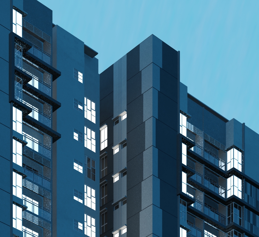

hi guys,
need some tips & tricks how to setup lighting for exterior & the huge city at night scene animation fly-thru?
how can i reduce the noise of lumi on the wall?
thank you.
Re: night scene render
This is Direct Mode render? It looks as Lumi Lights transformed to Area Lights...

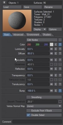

here is my setting..im still weak for night scene..

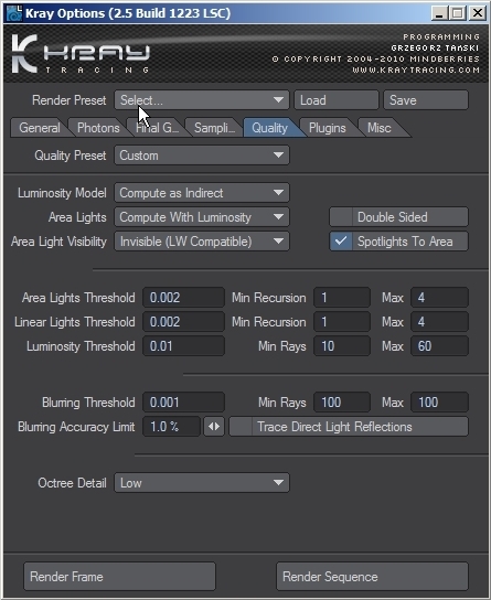

btw
Do not keep Octree low (I doubt you have small amount of RAM)
1. Reflection on walls?
2. Power of Lumi lights?
Post by azman_821009 »

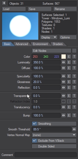

here my lumi setting..
...and first question? :wink:

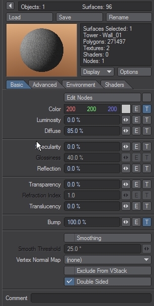

sorry for the first question..here is the setting..
It looks for me as not supported Node in scene. Dielectric Node?

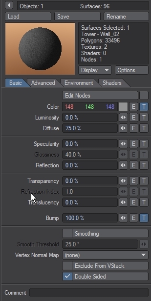

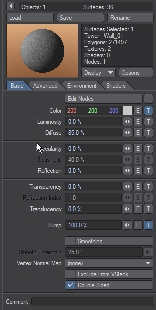

Janusz Biela wrote:It looks for me as not supported Node in scene. Dielectric Node?
what do u mean by not supported Node in scene? Am i using a Node editor? no dielectric Node anyway.
Node which is not fully supported in Kray or ...moment I remember something:
Did you used very high level of Bump Map?
azman_821009
Posts: 274
Location: Kuala Lumpur
Janusz Biela wrote:Node which is not fully supported in Kray or ...moment I remember something:
yes. i think so. not really high i think the texture amplitude is about 5-10. the rest is 100% or less..that one only for wall.

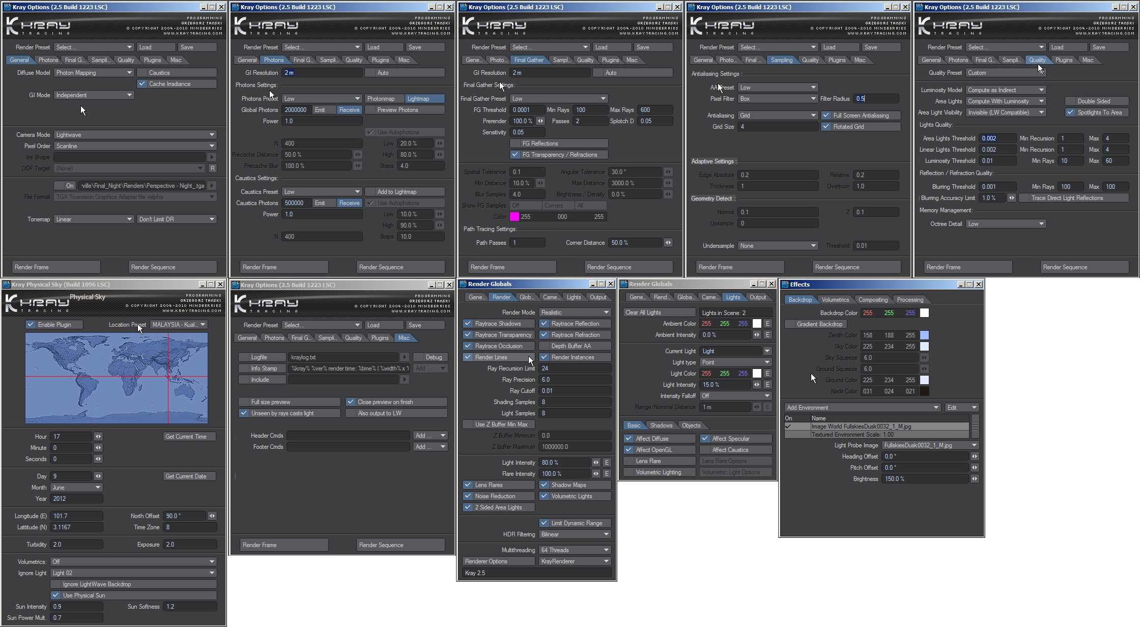

ok here is my overall setting of this scenes. actually im too worry right now because i have another job for architecture animation on night scenes. i do not know i can do it or not.
I think problem is from this Image World. it is LDR.
Also you have many bad setup in Kray (which doesn`t affect this error except 25 bounce light...You need maximum 12 in Kray)
jnom wrote:Janusz what was the problem and solution you came up with?
From first glance it looks like high specular and bump setting.
It is old bug from Kray. When you put luminosity surface + Kray Shader with switched RayTracing inside.
To avoid this problem I suggest put that surfaces in separate layer and then use LW raytracing flag.
