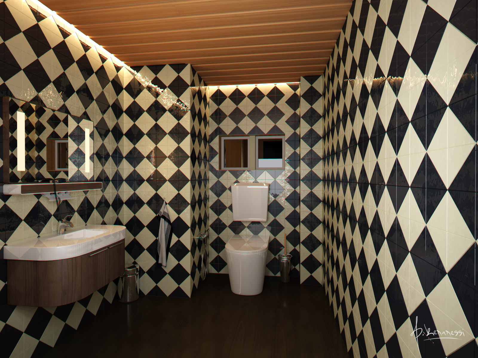

i think u can make small pattern and use lw instancer for ground to make it . i use it on wall in this case lw instancer.
can u put video pls . or iamge
In your case texture for each part is the same so it's easier. wooden planks shouldn't all have the same texture.
