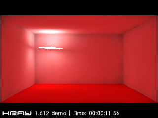

kray render pic
my floor is red,kray make red to white wall is too much

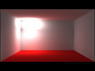

fp render pic
white wall is look as good,I want use kray to render like this pic
how to set kray to do this? thank you

lower number of ray bounces.
Posts: 453 Joined: Thu Jun 02, 2005 7:05 pm
Post
by silverlw » Tue Sep 19, 2006 5:51 am
I havent seen the Fprime render but i guess the white wall is whiter because it's less bounces. If you use 16 recursions (standard in lw) you get 16 Bounces in Kray.

where is lower number of ray bounces??
I use fp in default with MC GI

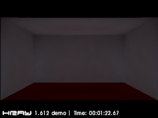

in my opinion, you should ambient occlusion advance on 0

global illumination > ambient intensity = 0, try this
Post
by silverlw » Tue Sep 19, 2006 7:24 am
Single wrote: in my opinion, you should ambient occlusion advance on 0
Yes i also wonders what that is
Anyway in lightwaves rendersettings where you set shadows/reflections/refractions, set rayrecursions to something lesser than 16, or write "recurse 30;" (or whatever) in the the tailer command box in kray misc tab.

Silverlw wrote: Single wrote: global illumination > ambient intensity = 0, try this
Where do we set this ? (now im really qurious)
I try it ,but nothing happen
so I upload scenes and objects ,can some one help me to set a kray render pic to light not take the floor color to wall setting?
great thanks!
and how can get kray 1.7 version? I very love it ^_^

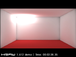

by cheneva » Tue Sep 19, 2006 9:52 am
Single wrote: main version
thanks,but the white wall still too red .......kray can't control this color?

by cheneva » Tue Sep 19, 2006 11:30 am
use some test to complete it ^_^
