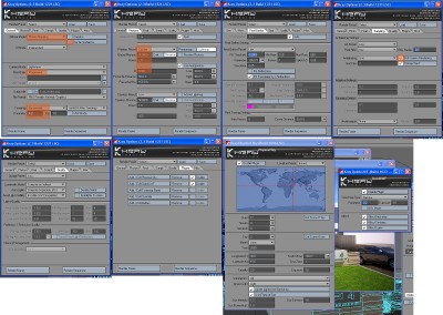

can show grab screen of kray panel? tonemapping and other? :mrgreen:
jdomingo
Posts: 144
Re: kray v 2.3
Post by jdomingo »
Hi Nico,
thanks, it is pretty much "low preset setting' whenever i am doing test render. please find attache screen grab of my low preset setup. there could be a lot better setup out there by the experts but i am happy with this one. try experimenting till you get what you are happy with.
Re: kray v 2.3
thank's!!! :mrgreen:
i've tested your valure...are fast but i think my problem are the texturing.... :shock: your material are very luminouse and contrast... :twisted:
