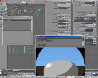

I'm testing advanded camera in v 9.6
see the screen shot numbered " 1 ~~~ " that I attached
On top-left side , you can see the lens shaped object is used as "custom lens" by the uv coodinate.
I pushed F9 and got "image viewer's image" by lw native renderer

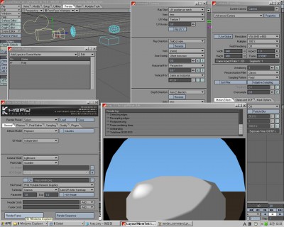

see the screen shot numbered " 2 ~~~ " that I attached
I added kray and pushed render frame button and get "kray rendered image"

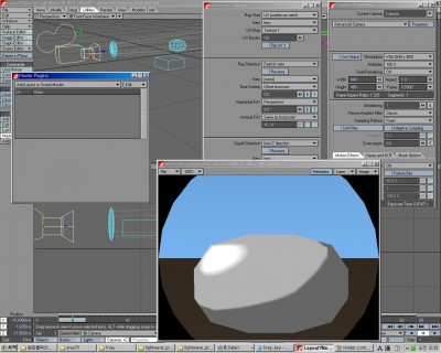

see the screen shot numbered " 3 ~~~ " that I attached
I removed kray and pushed F9 ( not shortcut but menu button )
and I encountered kray preview which was already removed
and after this first "F9 ignored" , I can not get back image viewer !!! until I restart lightwave
