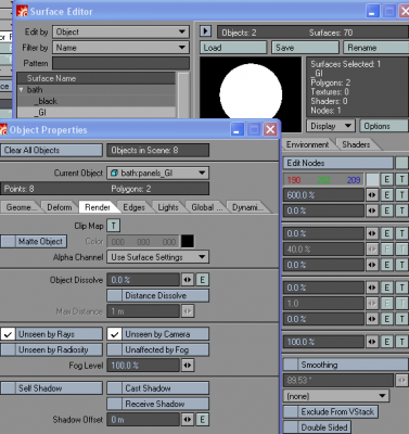

My old scene with New features:
- new blurr rapid engine (still in test)
- lumi poly as Area light (new feature, hiden from reflections and view)
- and perfect Kray tonemaping: LWF + blending (70% expo/30% gamma 1.6)
6 min time render HQ. (prev render : one pass, without AA and low blurr: 40 sec)
Render stright from Kray. Without lights inside. Only physky and lumi panels in windows.

Setup new engine blurr
footer cmds: importancegammamultiplier 1.4;
http://www.kraytracing.com/forum/viewto ... 730#p10730
I thing 1.4 i the best. High value blurr just looks as high. for fast prev You can switch to 100/500

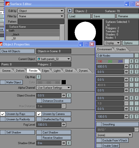

New feature: hidden lumi poly
activate and setup (later will receive shader I think)
footer cmds: lwo2unseenbyrays_affectsgi 0;

brownie wrote:About light planes :
-is it definitely a better option or just an alternative to areas?
-How do you deal with the fallof?
I thing better now use Lumi Poly:
- soft GI shadows (not that ugly as from Area Lights) so renders is more "softly"
- fast renders
- without NOISE (this is the best)
- easy setup
- without fallow (maybe in future...) so without complicate control,
For me now: better use Lumi (I must back to old scenes and test...)

-Soft shadows are maybe ...too soft
This is depends from setup :) I f You use QMC You will recive silimar shadows as Area Light...so depends from FG setup in Kray: I sugest Oversampling...
-Don' hesitate to put crazy values in Brightness (over 1000%) to get bright scenes.
I used 500 % Lumi + maximum 6 Exposure in physky, IF is not enough light in room You must turn ON lamps....or put Power shader for Lumi
-I have the impression that I get more light leaks.
:D this is depends from setup GI! If You have good setup You don`t see it.
