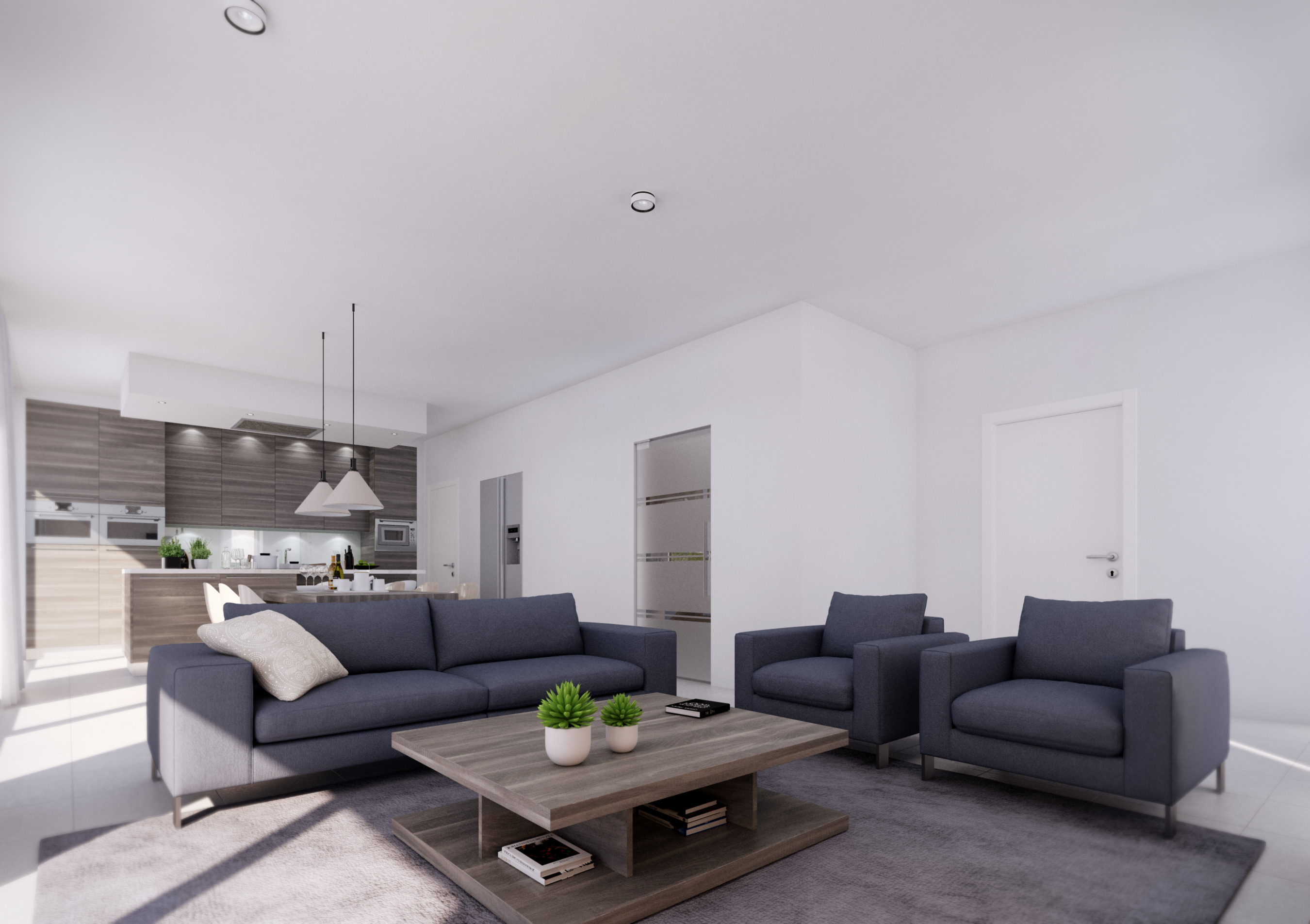

follow janusz what he said. and u will be good.
for my point when i saw ur render . i think u need good tonemaping setup
her my poste for u render .
dont use lumi panel on ceiling . my openion .
and i see u have poor materiel there and quality render also .
and about backdrop hdri using kray in interior . its useless . use physky alltime .
mybe if u have some big window and u want to get true color like nature . use hdri in backdrop . otherwise its useless to use it when u have small window ordinary house .
Use one Area light out side . and good luck . tone map as this is good : "Lwf " 1.2 - 1 | 2.2 . 1 . 3.5 . 1.0

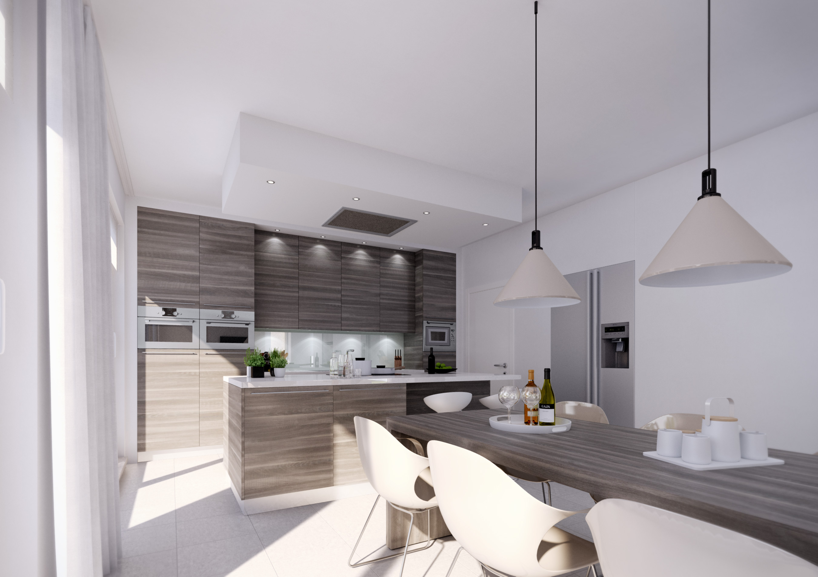

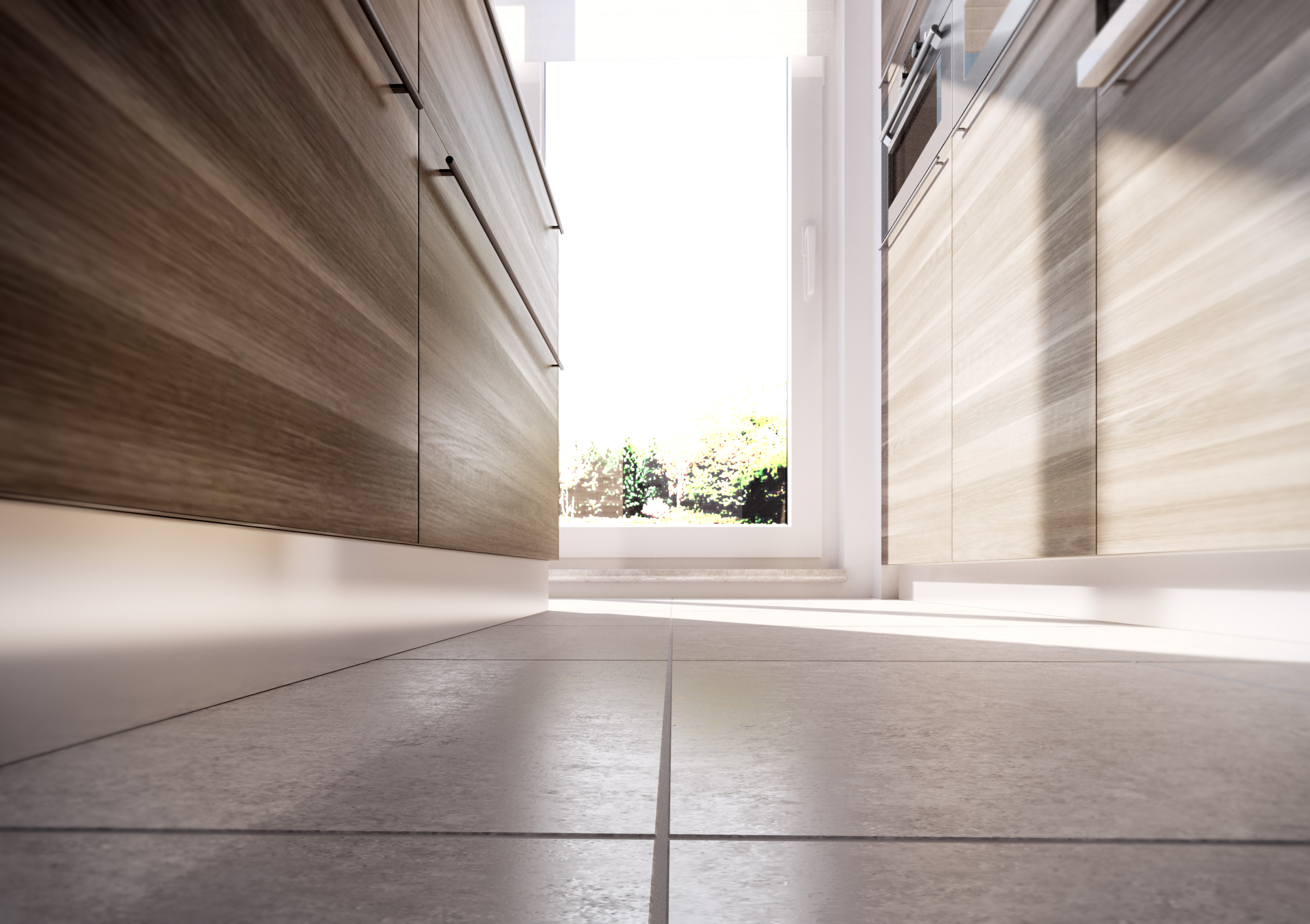

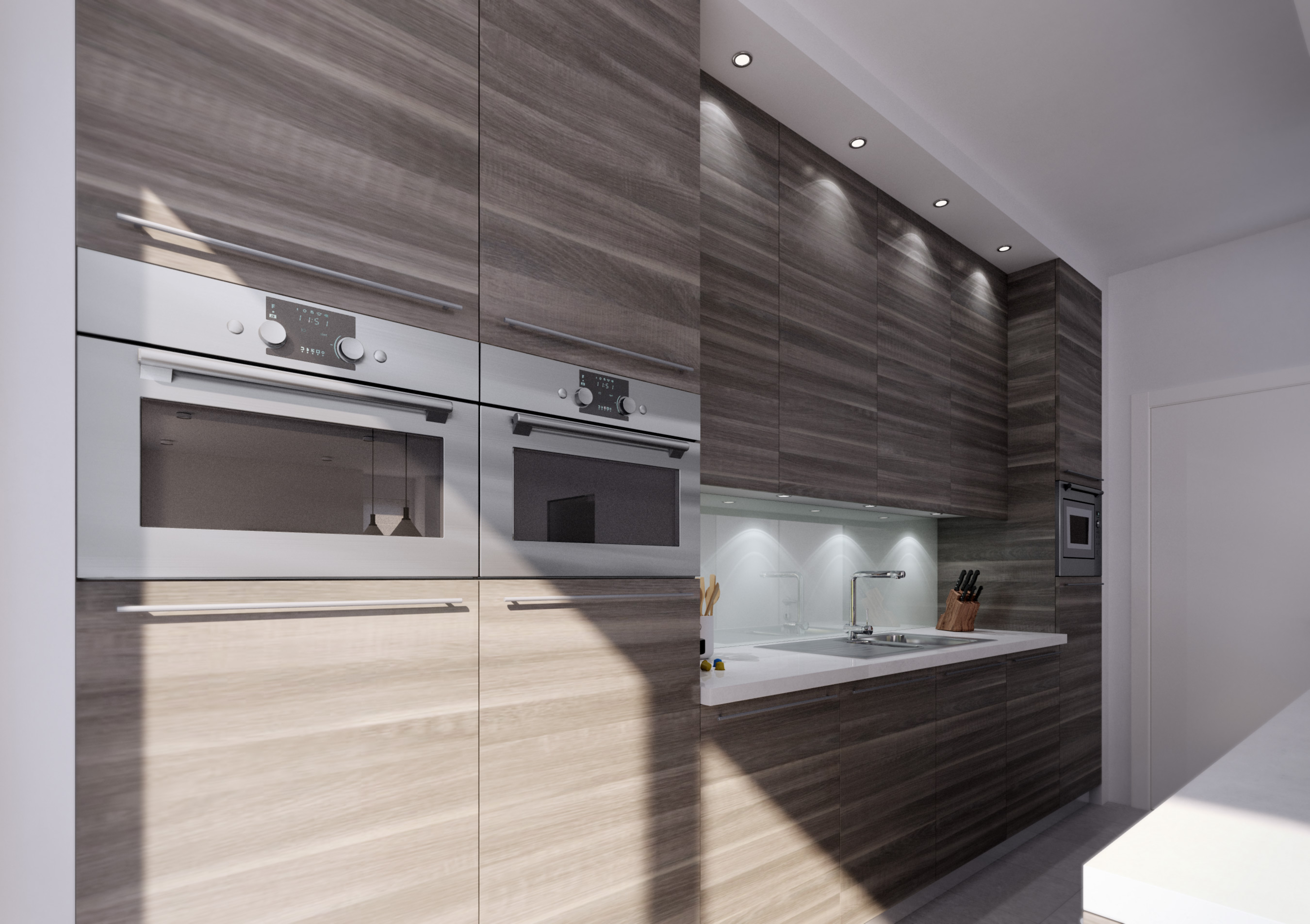

Here are final results :
Re: Best recent interior setup?
Looks good
btw
for better GI (sharp GI corner effect) we must wait for K3. With K2 engine is quite difficult to get good looking corners - the radiation is too big always. Path Passes option (for example 1/50%) helps detect these regions by cached Path Tracing Photons but effect is average...of course without is much worst.
This bad effect comes from not accurate photons (which is normal and exist everywhere in other software) G. add just small tool (path passes) which support this imperfection by small amount Path Tracing Photons.
K3 has new Photon engine which make accuracy close to Path Tracing! but with Photon Mapping system (so ~10-20 times faster)...something similar to Sky Portals. After that having good photon map sampling will be very good and fast.
