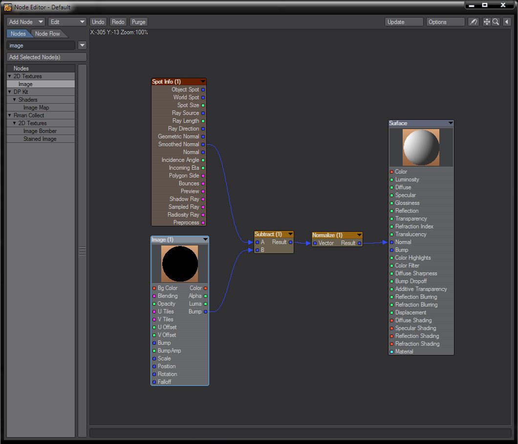

Because I use this non stop it this just matter of seconds to setup for me material without rendering (but this is normal when you use non stop same system - you just get use of it)
I tried a fast modded setup in some variations: wood, leather and chrome and it seems work very good (usually for this materials I use the Delta node or a more basic fresnel setup with some tweaking). It's a bit heavy to calculate, but my machine (i7 six core @4ghz) can handle it pretty well, even with the defalut lw engine. I need to look better at how the the normal to bump maps convertion works because seems to me that the normalize node require a different tone/contrast for the image source.
I have a question, is there a reason to use the spot normal + bump in the subtract node before the normalize? Because I tried to connect the bump directly to the normalize node and the bump effect does appear more stronger (but seems impossibile to change the final result with bump value, or other multipliers: 0% bump or 400% changes nothing).

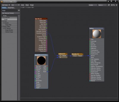

Here Normalize Node.

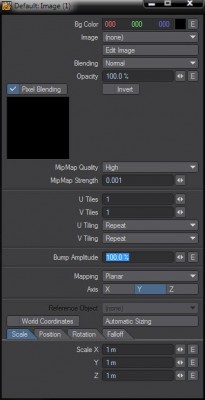

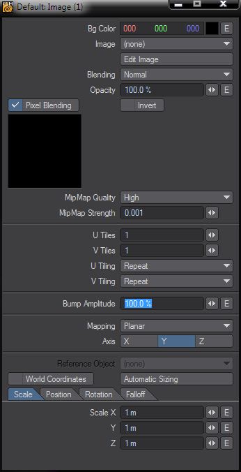

- Bump control you can control only from blue connector and BUMP AMPLITUDE (it`s make bump in three dimensions instead of two).
- in image channel you can add whatever you want (grey scale map or colour map)
but you must remember not all diffuse maps are good for bump, many of them need separate texture.
- you can connect colour to colour Surface (so it will be one texture for two effects) or also use LUMA for reflection channel (then will be one texture still)
- sometimes one texture can be used for, Normal Bump Map, reflection, diffuse, blur map - it`s save a lot time!
- sometimes when bump map is not good you can increase BUMP AMPLITUDE up to 1000% (it`s happen when luma of texture has low range grey scale - is not "strong" dark or white colour)
- bump map need a lot experience to prepare - most of the time is not enough just put texture to bump channel
- This Node save a lot of Time! You do not need waste time for prepare special Normal Map.
- Normal Map is better then standard bump map but of course up to one level when only real displacement can help (K3 will have finally real displacement).
- this is basic Normal Map Node - most of the time I "inject" another Bump Map (to mix) - You can see it in my renders on the walls or ceiling.
- Last time I use Bum Drop Off effect - special curve for control bump effect which reduce bump depends from angle view (make better Anti Aliasing and reduce bad looking Moiré pattern)
Normal_bump.rar
(4.94 KiB) Downloaded 556 times

nico wrote:sorry for my question but i don't see difference from use node for normal map or bump in texture!!!why need use it in surface respect "old" system with bump? in my test the final effect it's identic!! :oops:
Normal map is "three dimension" bump and is better visible in shadows area where doesn`t exist direct light (for example Sun). Also Normal Map looks more deep. Of course it is not big difference...or maybe it is because when I need really strong bump - only Normal Map helps me.
