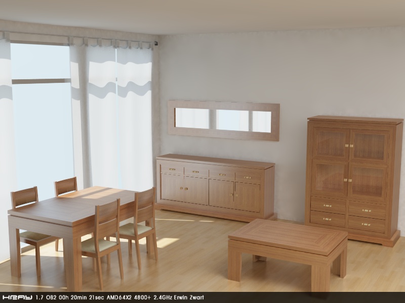

erwin zwart
Posts: 152
Post by erwin zwart »
JUli51 wrote:if I multiply the sume and division of the color cannel with the sume of difusse and reflection,.. i will fas allways get values more than 100% :roll:
sorry I could not look at your scene last night, but when I turn diffuse down on your wood surfaces, everything is fine. Phile is totally right.
I changed some lighting and surfaces and rendered this. I will mail you the LWS and changed LWO's.
btw FG max rays is now 1600, take it to 3200 to get less splotches, AA could use upsample 1 or 2 to get more thin lines into it.

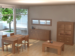

juli51_forum
Posts: 142
Location: Spain
Post by juli51_forum »
Ok,..here is mine,.... I were still improving lights, illumination,.. etc..
but i think i got the thing,.... :D
