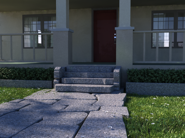

Used tonemap and instances, etc. Sorry for the ugly render its a wip.
Main pc is corei3 with nvidia 430gt. Pretty low end.
