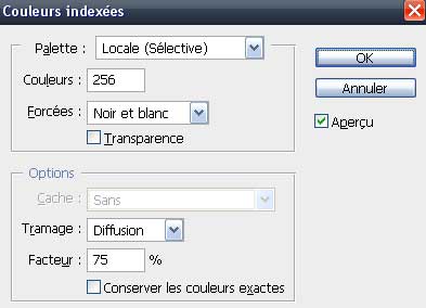

Indexed color is a color mode which reduce the amount of color of a picture, in many cases 256 color picture are enough (yes I didn't believe that at first, but it really work), here's a screenshot of the Photoshop windows (in French sorry):
