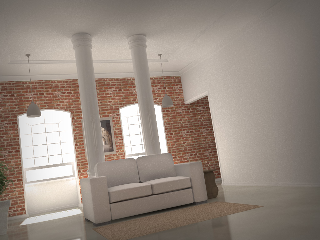

I've attached an updated image. Not perfect, but I'm liking the results much better. No post was done, straight Kray render. Basically what I did is add some area lights as fill lights by the windows closes (not viewable) to the camera. Then I beefed up the lighting intensity.
How does luminous polygons differ then just using area lights in Kray? Because I tried using the luminous polys (admittedly not for very long) before the area lights and couldn't get the lighting boosted like when area lights where in.Pheidian wrote:Have you tried applying luminous polygons behind the windows (like area lights in fprime), adding them a luminosity of 1000%, and then playing around with recurse settings (10 is good, but 30 will give you more much more light).
Hey Pheidian, I know your busy, so I understand...but I'd love to see what this scene could look like from someone who knows what they're doing. So when ever you have a chance, I'd love to see something.Pheidian wrote:I gotta give this a try also at some point when not rendering any commercial stuff...I'll try to do some image for this for you when I have the time.

kray has to convert area lights, its more efficient to use lumi polys, they will give cleaner results. In this image the scene looks evenly lit thus dull, this could be a look you are aiming for but generally you would want to see subtle differences in lighting, see where the light is coming from, for instance on the ceiling. Lumi polys give you just that.. more controll, cleaner gi and a sense of where the light is coming from.How does luminous polygons differ then just using area lights in Kray? Because I tried using the luminous polys (admittedly not for very long) before the area lights and couldn't get the lighting boosted like when area lights where in.
Use the autopart plugin to let them be converted to seperate sources and you will be amazed..

If you look at what area basicly are (and what makes them render so inefficient) they are planes casting bright light in the middle and casting less light moving away from the center, a lumi poly will cast light evenly but they can have whatever shape you want them to be.
you can handle the recursion through the 2 kray surfaceshader in materialeditor (last tab) you can add a multiplier there, force them to render indirectly (splothes) or let them render directly (noise). For accurate placement i suggest you place them i modeler and apply parts (with plugin) there.
cheers
I agree about the slightly dull look due to the overall even lighting. I don't mind it per se, I was just glad I could get it from looking so dark. I'll try with the luminous polys to get less dull.darickster wrote:In this image the scene looks evenly lit thus dull, this could be a look you are aiming for but generally you would want to see subtle differences in lighting, see where the light is coming from, for instance on the ceiling.How does luminous polygons differ then just using area lights in Kray? Because I tried using the luminous polys (admittedly not for very long) before the area lights and couldn't get the lighting boosted like when area lights where in.
Yeah, I like that one that Pheidian did, that's why I want to see him mess with this scene. Thanks very much for the explanation & resources darickster.darickster wrote:Use the autopart plugin to let them be converted to separate sources and you will be amazed..How does luminous polygons differ then just using area lights in Kray? Because I tried using the luminous polys (admittedly not for very long) before the area lights and couldn't get the lighting boosted like when area lights where in.

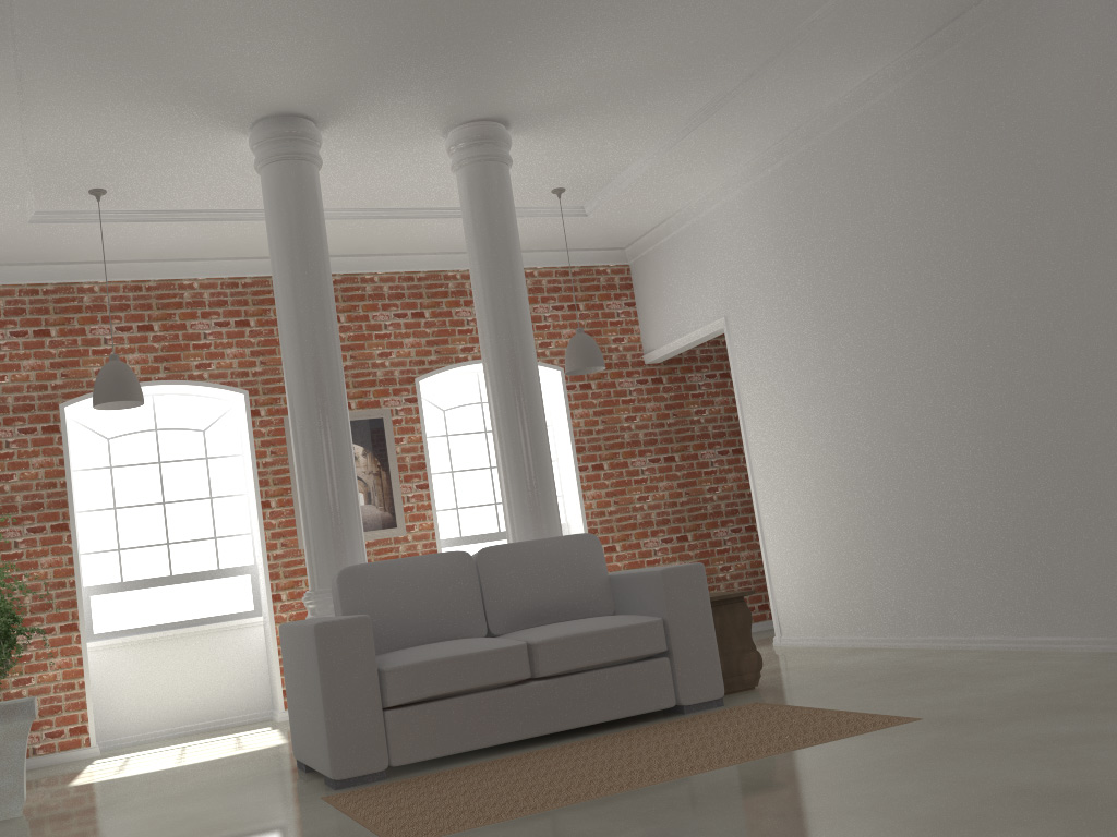

Rendered out a bunch, lumis in windows, dome, altered some textures.. hdr output..
The original one (in the wiiroom thread) has some light coming from the camera side (which help giving more attention to the sofa), this is just lit with natural light so focus is on the windows. Faked it in one because i can.
cheers

- postwork and faked couchlight
- wiiroomric_kray_ps2.jpg (201.8 KiB) Viewed 25008 times
- straight from kray
- wiiroomric_kray.jpg (193.32 KiB) Viewed 25022 times
- some postwork
- wiiroomric_kray_ps.jpg (196.4 KiB) Viewed 24992 times

Have that one larry, thanks, see you are improving far more lately..
Had to pull the backwall back to get the camera in, gave me funny results when i used the original one sided poly scene. So the windows on camside dont have a lot of effect. Experimenting to retain some grain in the images, quasi random AA.

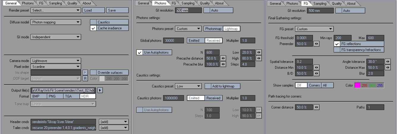

1 spol light (Sun) and Skylight plugin. LM mode. AMD 3000+ and still good render time. KRay
- Test_0200000.jpg (261.11 KiB) Viewed 25042 times
Re: My render
Nice CruiseMori, it's a bit too flat for my taste (might just be because some textures aren't there), but it's definitely more lit, which is more what I was looking to do. Mind sharing your settings? Also what do you mean by LM mode?CruiserMori wrote:1 spol light (Sun) and Skylight plugin. LM mode. AMD 3000+ and still good render time. KRay
