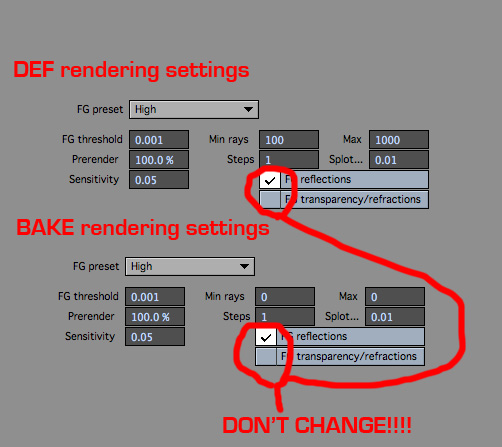

In lightwave rendering options, frame step 10 for slow animation, frame step 5 for fast animation. (you dont need to do this if you render on 1 computer because kray writes data from frame to frame, a renderfarm not)
If you change the FG, be sure not to change the checkboxes for raytrace reflection/transparecy/refraction, because that wil not work for the baking. (see attachment)
Greetzzzz,
Fabian
Update of the subject:
Greetzzzz,
Fabian
