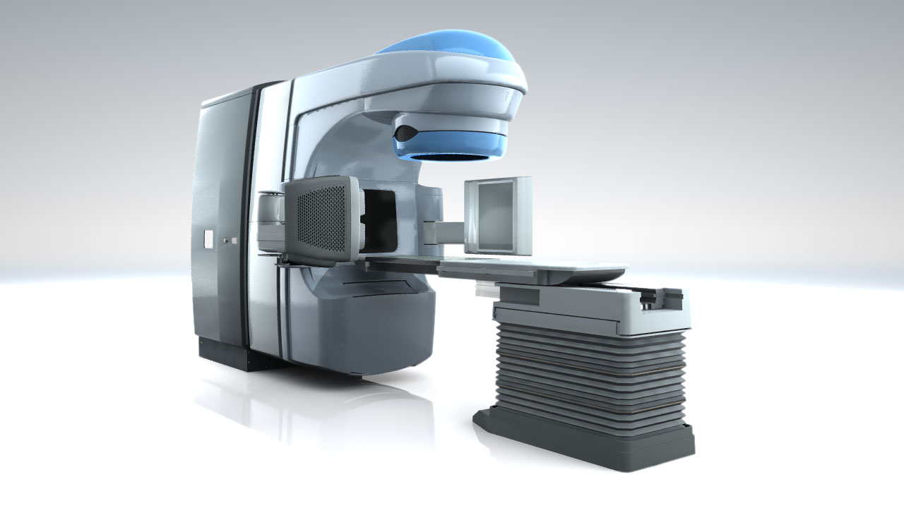

The animation is of a machine (a pretty high poly mesh). I can get really decent renders out of LW's G.I. but they take about 20 minutes per frame (and I've got 1000's to render).

Here's what I'm rendering

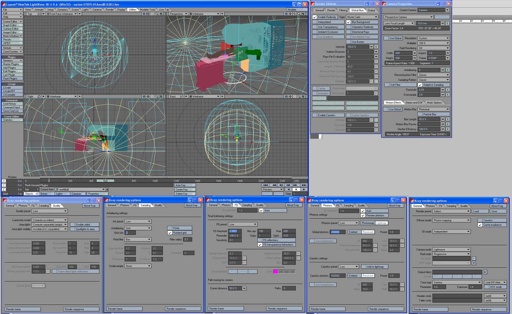

Here's my settings...
Thanks

You need to change GI mode to Time interpolation for animation 5 frames nice for me.
And you can show Ligth configuration, ambient need to be 0?
Off preview photons too
Re: First posting... :) Slow render :(
doug1138 wrote:Here's my settings...
Thanks
Hmm yor settings look realy low. maybe its something with materials and/or lights that is throwing off the computation. I suggrest you try this: open master plugins and find kray override plugin. In plugin settings choose enable override, use color and pure diffuse. If this renders much faster than its some surface setting slowing it down.
Also add logfile 'kraylog.txt'; into the header commands list on the General tab of the Kray GUI. This will create logfile. Upload it back here so I can check it.
