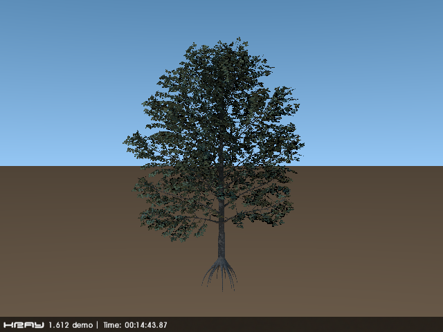

ana028
Posts: 208
Post by ana028 »
I render this test without the alpha channel. I used transparence channel to make this test works in kray. The test is without aa.
