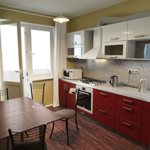

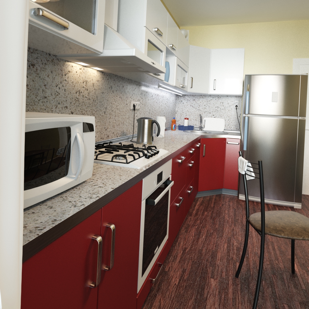

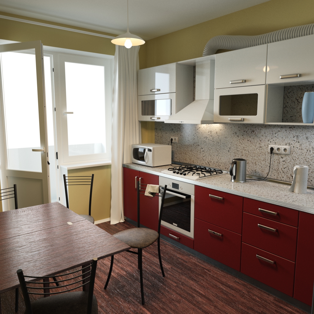

hey im really happy searchin all days and ifound it . how to get the same result as modern render as k3 but in k2 .
so in k2 everyone know u cant get nice shadow from lumi only if u just choose direct light in luminosity model so u will get some noise and u can reduce it very clean in photon tab and fg . but u will lose indirect compute . sooo i found solution as indirect luminosity model u get the many many shadow in side room ^^ .
here test with kray 2.62 using Kitchen fstorm from janusz .

I tried this method.
That's right, the quality and precision of the shadows much better.
Sorry render time 100% longer.
In the case of a small amount of light area better to give more light than lumi panel.
It all depends on the scene. And it is super kray can adjust the settings for the specific project.
The floor area for correction. Less bump mapping for more reflection.
Good job.
Good job.
Re: New Trciks in kray 2.62
Hey artAttak thank you for your feedback .can u plz tell me wich scn it took 100/100 long cause in my caise all scn it work the same. or mybe u put something wrong .artattak wrote:I tried this method.
Good job.
my tricks is to put 2 area lights for each light sources and use photonmultipilier to get nice shadow in side room without affect gi and too much diffuse of ur model. im working on bathroom . when i frinish it i will put it with this new method for everyone to lean this one . and for all kray user can acheive photo realsitic easy mybe its long 10min differance but the render is very very nice. thankyou !

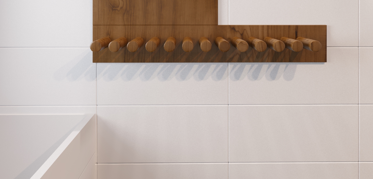

this is my tricks look pls how much shadow we have in this bathroom without affect gi and diffuse too much i have 4 shadow here . and know the one is next ground if u can see it.

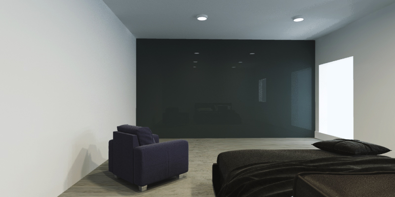

here i have 2 light.
one from out side window . and 2nd one u can see it it above it didnt affect gi .

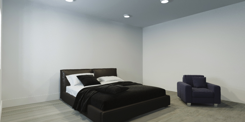

here my first attemp on this tricks . i was playin around too acheive many light and shadow in side room without get bright render .

hey sry for long reply. well if u want to have many light inside ur room or kitchen or bathroom . u need to use area light without invers dist x2 . it mean u will use basic area light and u gointo motion tab : u add photonmultiplier and put 0.3 or 0 depend how much u want to light affect difuse and gi . soo with this method u will get many lights inside ur room without affect gi = sooo u will get nice diffuse and normal render not white or bright .
