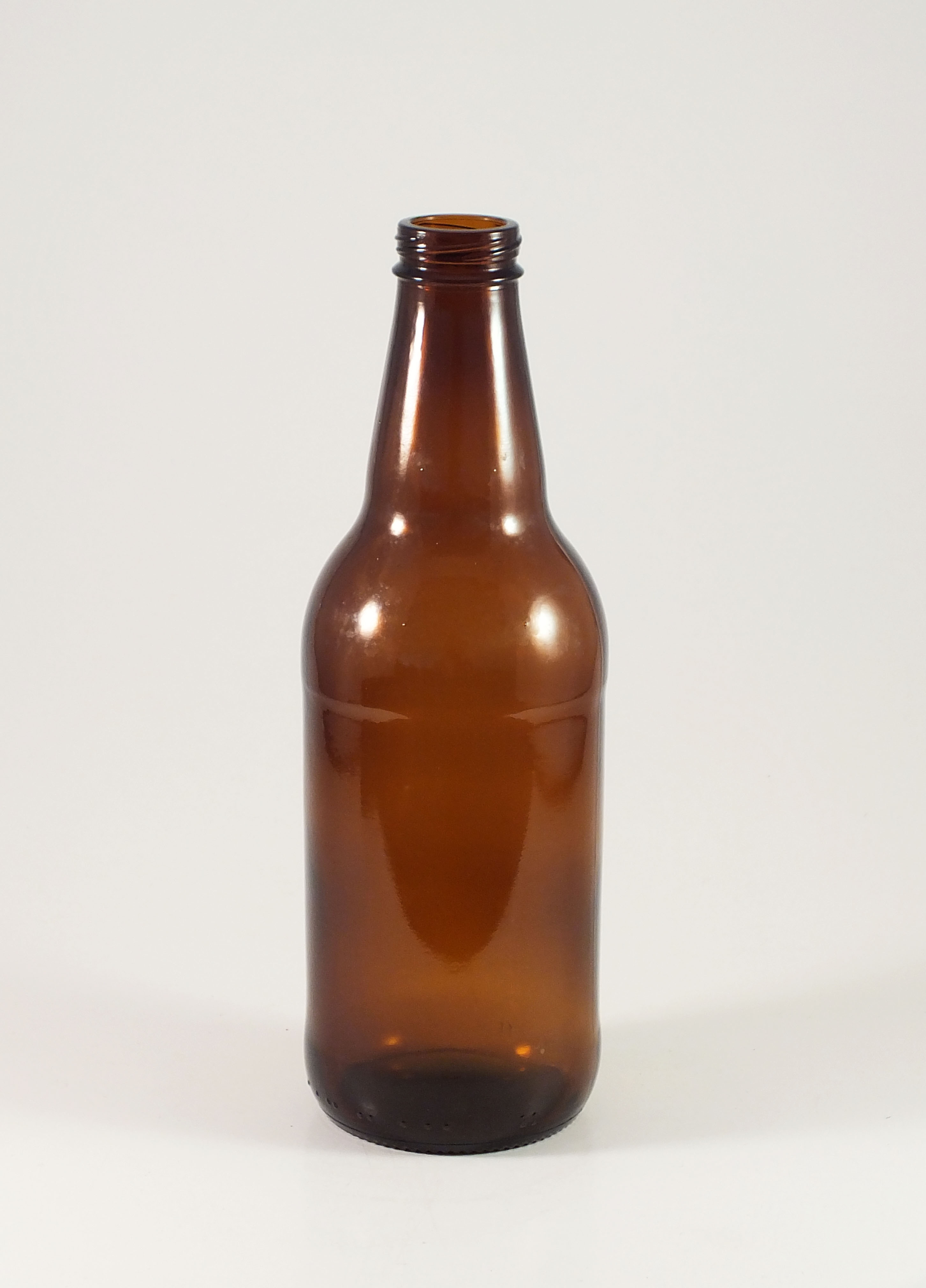

I need to make a brown glass shader for kray. (I can do it in lightwave native with materials - but I need it for kray) Its for beer bottles (loads of them)
Here's an example I'm looking for:
I tried several setups, but they only work for clear white glass. And when I use diffuse value's lower then 10% value's, the brown becomes totally black. I also noticed that brown glass is not 100% transparent but somewhere around 65%.

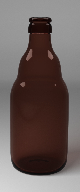

Here's the model: (Im not gonna tell which Beer it is)
The colors and imperfections we allready have, no need to make them (except if you want to post them on this forum) I'm just looking for a working kray shader setup (like the one in maya/vray - or lightwave/dielectric) because I dont want to mix renderengines.

This is the render with dielectric material (brown color +absorption 500%) So having the same in kray would be great. (the dielectric in kray gives weird effect)

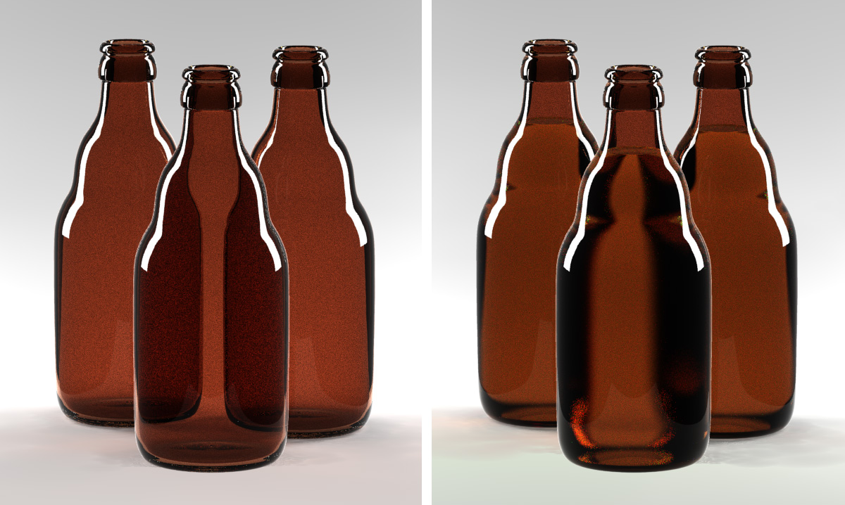

I messed around a little - ZIP coming up in 10 minutes. Probably too slow for your needs, but it might be a good starting point.
Re: Brown beer bottle shading
Here you go. Empty and filled. Noise is due to dispersion and blur, which can be turned off or optimised.
Files attached as well.

One more thing: your bottle wall thickness is very constant. Adding some variation in thickness would make things look more realistic.

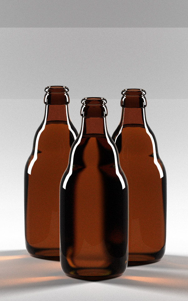

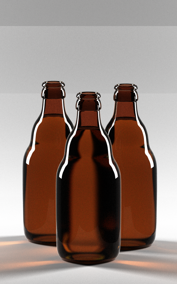

Let a QMC high render run last night...

Thanks for the shader setup! I did not know the refraction nodal shader was supported in kray. But it seems to work very good and renders pretty fast. Maybe we should have a list of supported LW native shaders in kray. (until kray 3 has it own shaders)
I will add a bit of geometry displacement on the inner shell of the bottle, this will apply to the thickness of the bottle.
