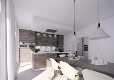

Thanks for all the advice!
Soon gonna post final images and then gonna leave for a holiday!

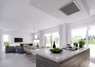

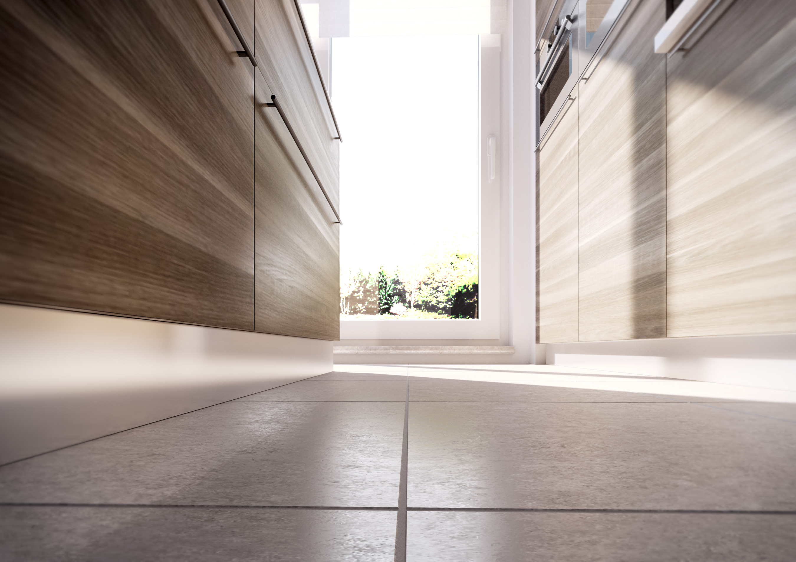

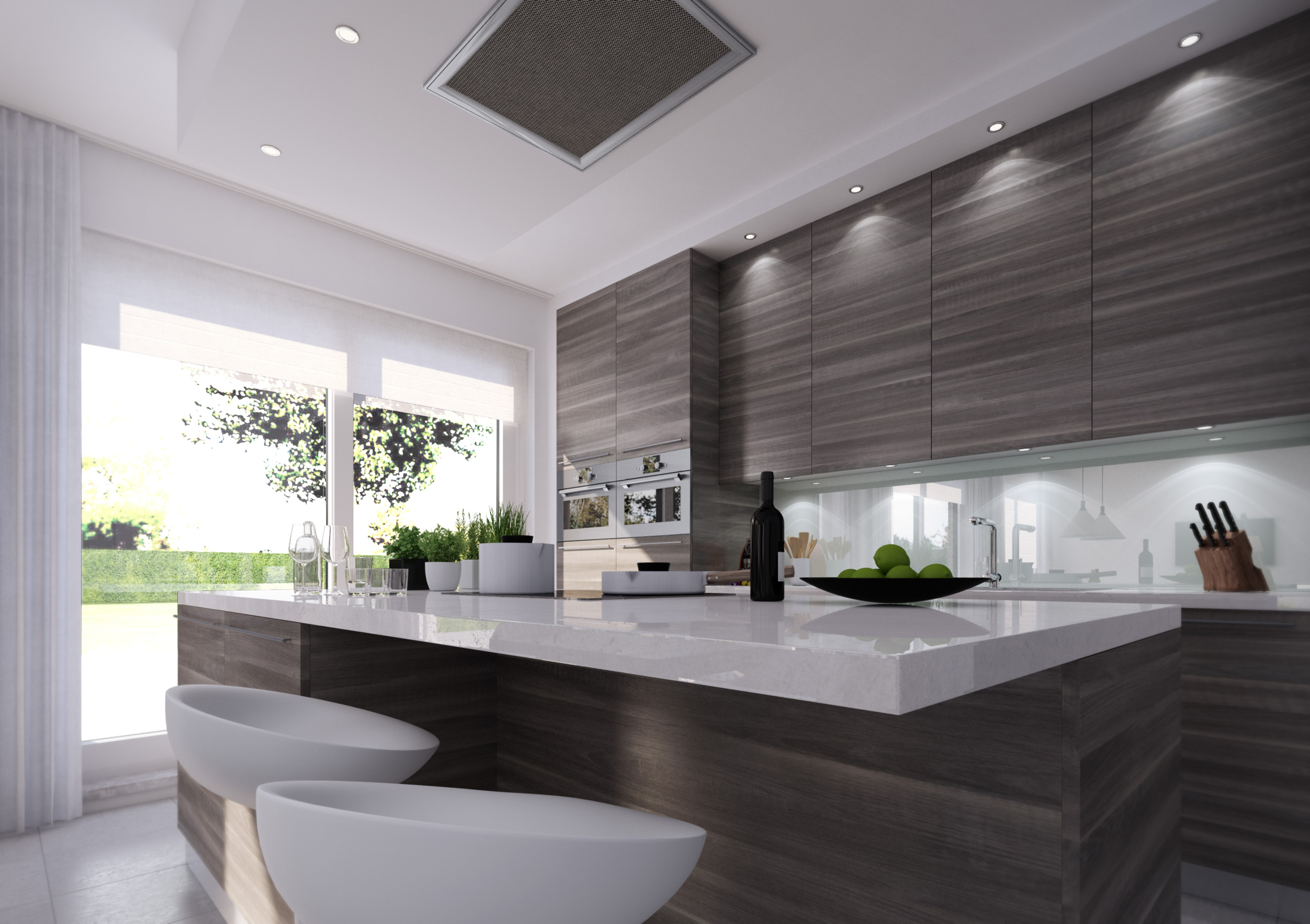

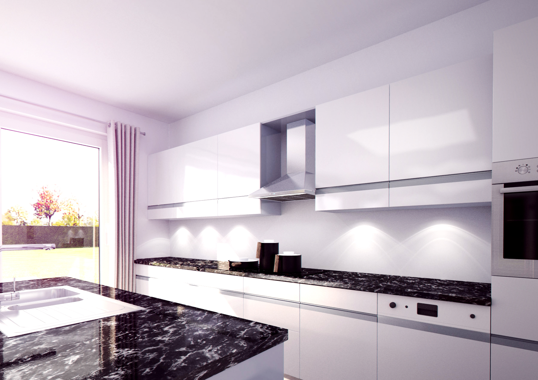

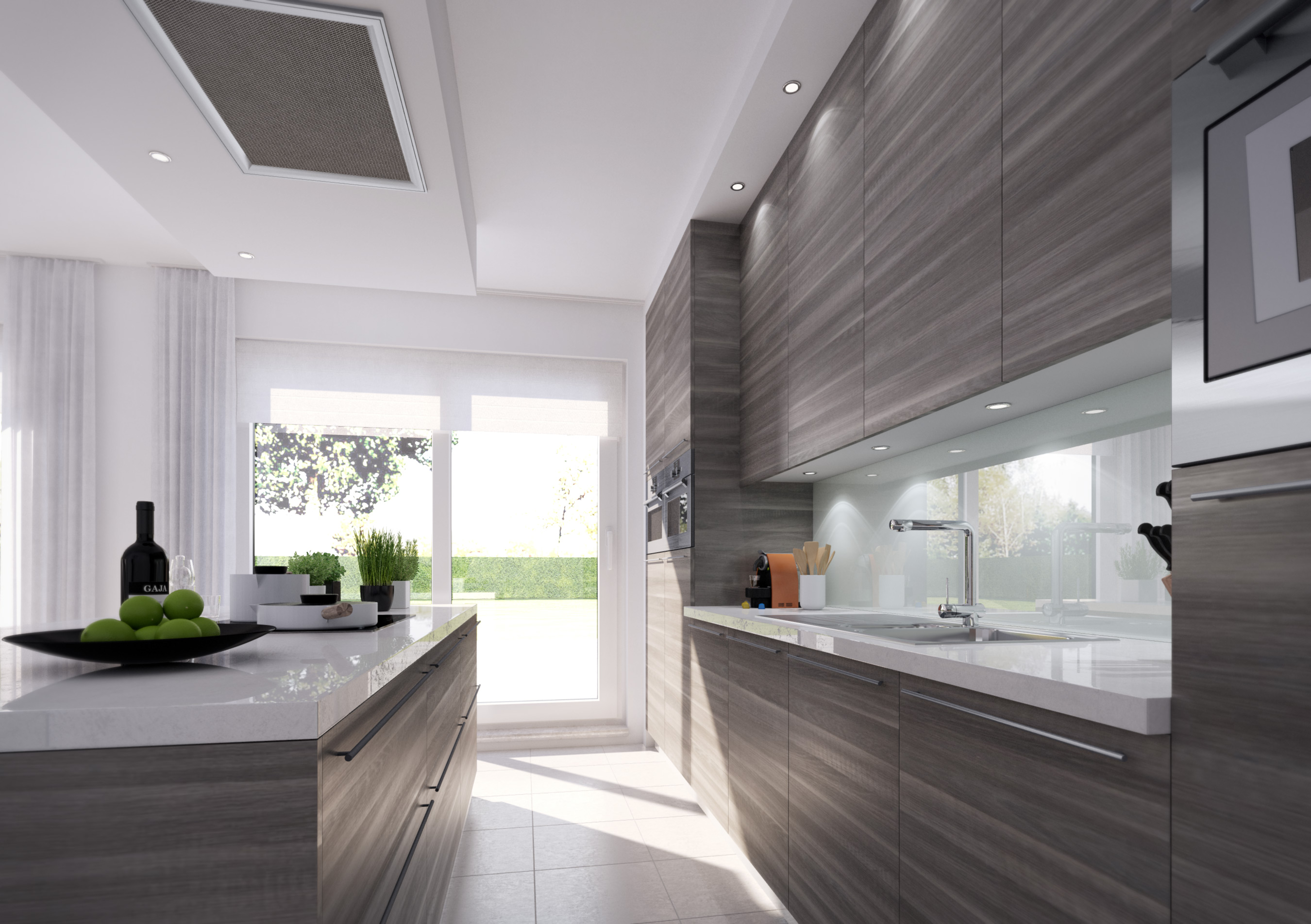

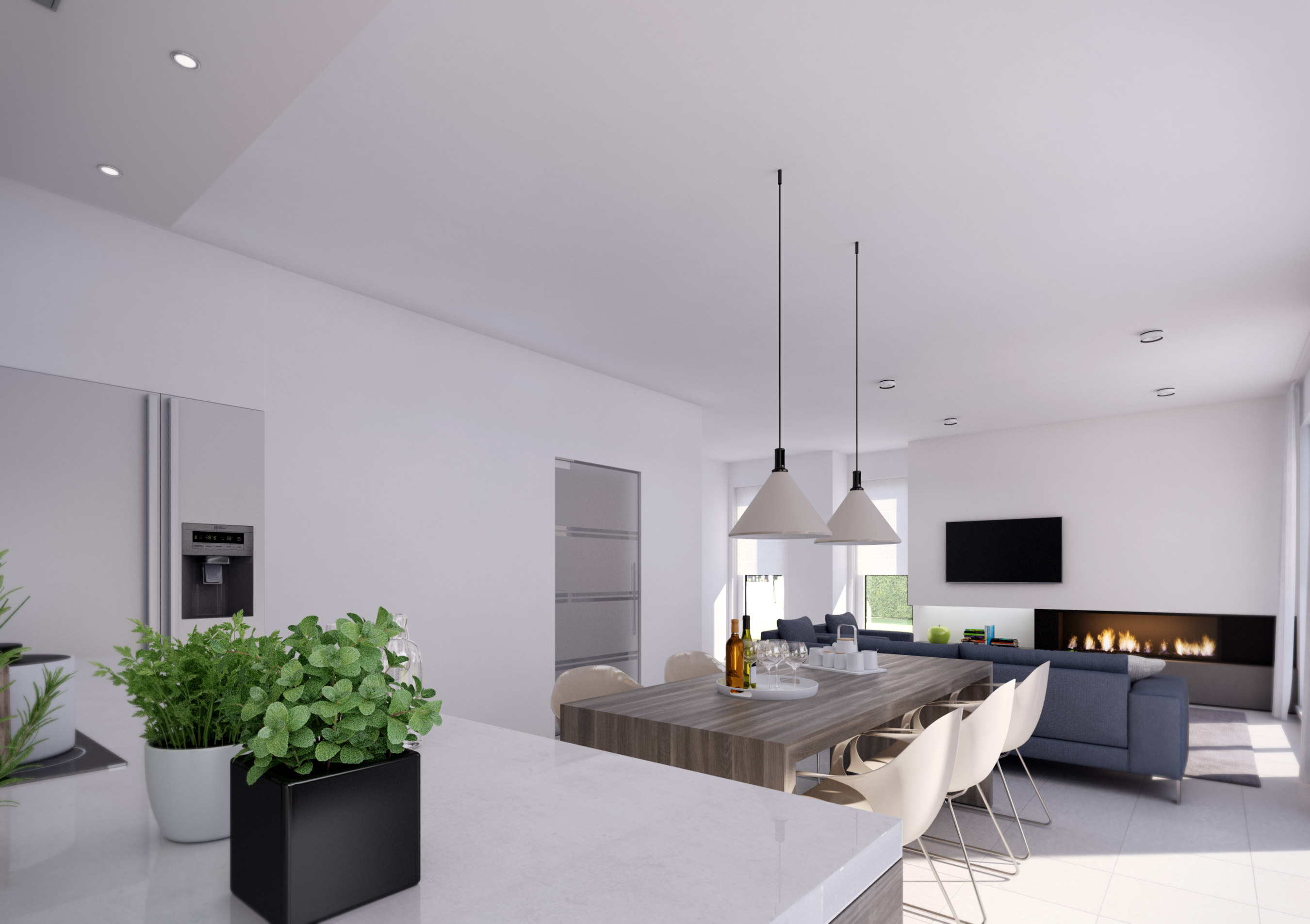

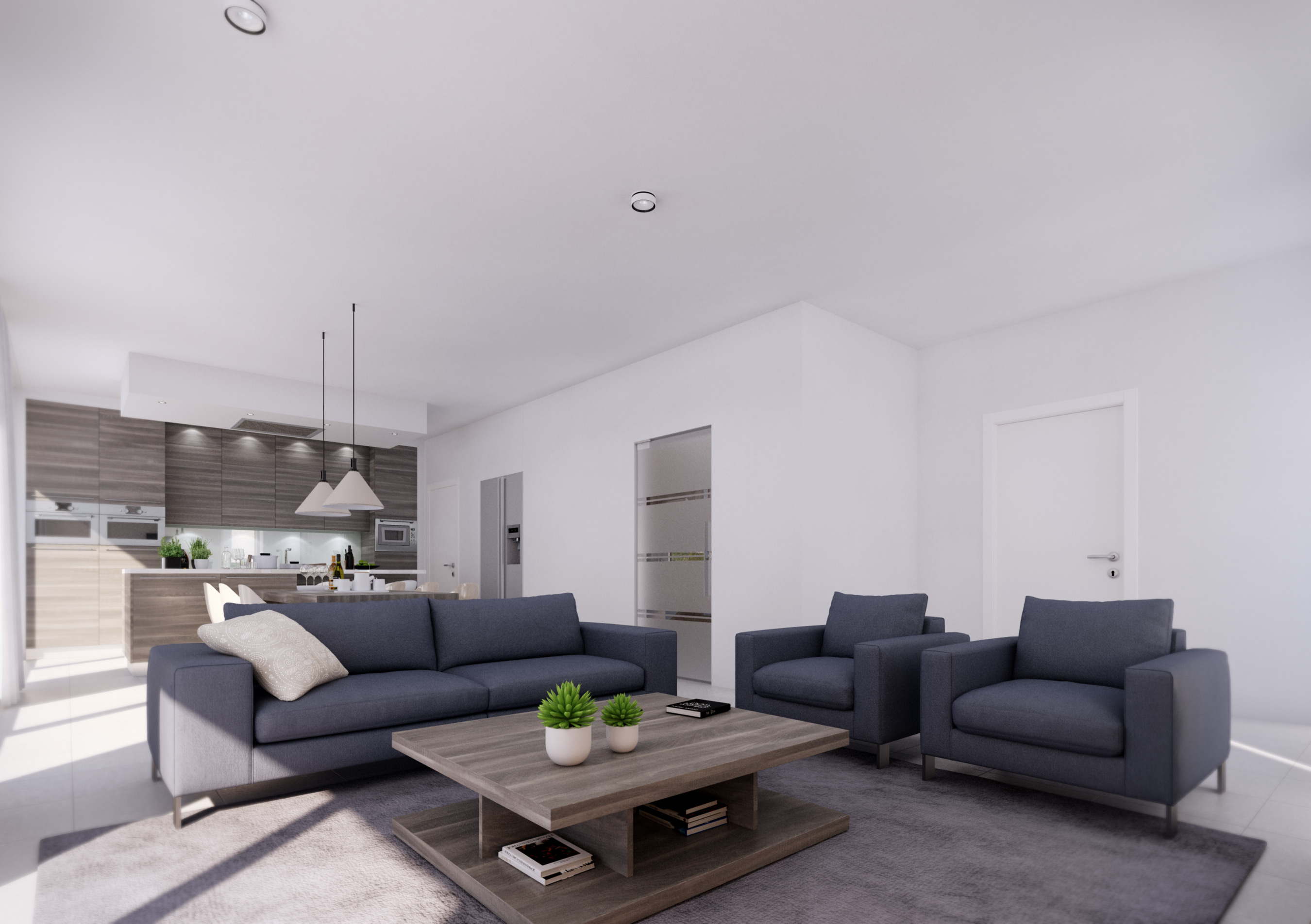

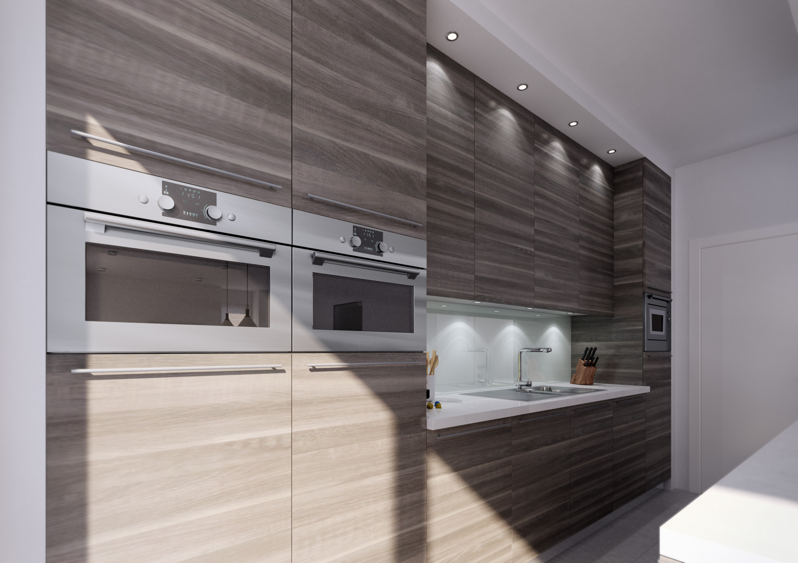

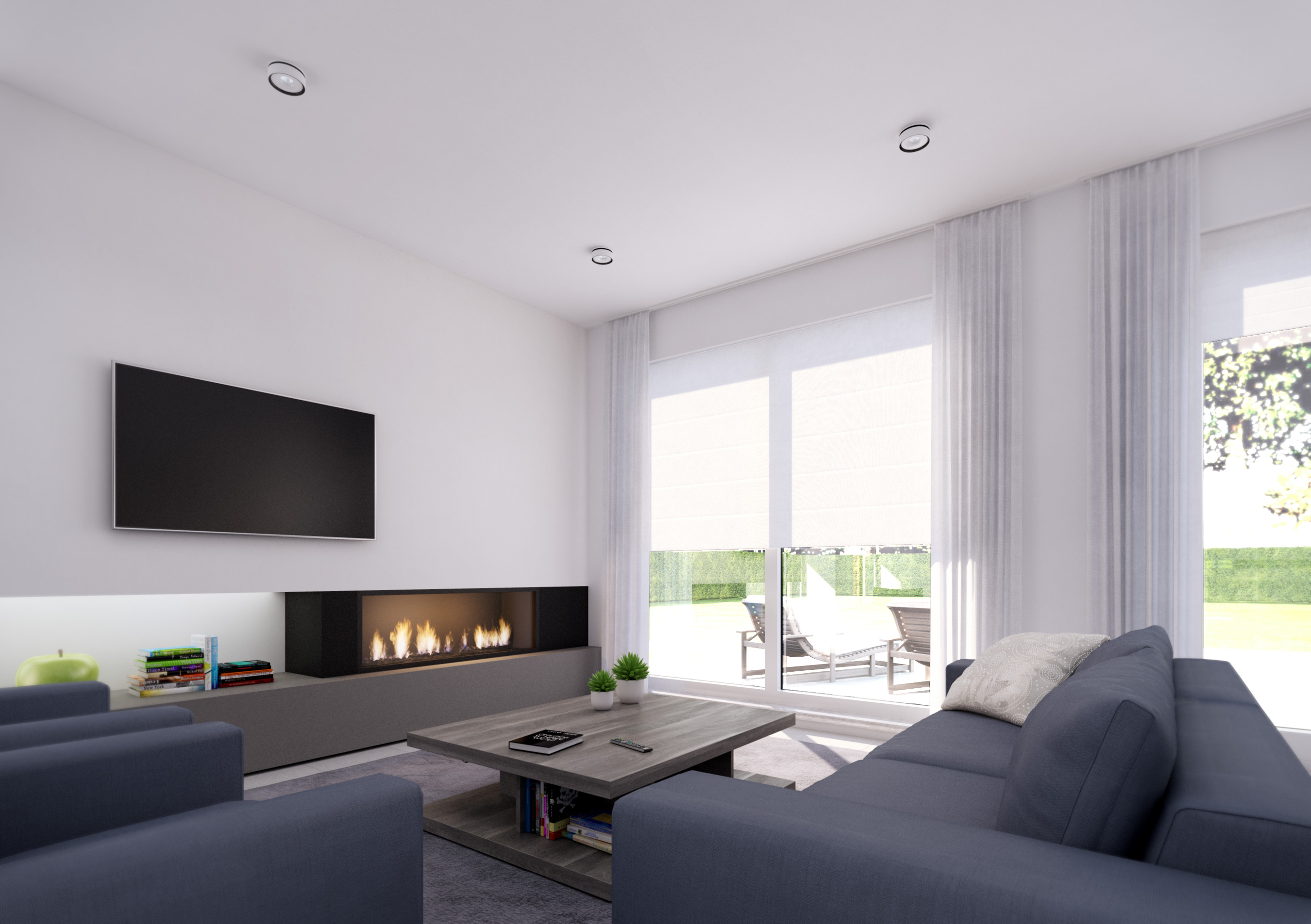

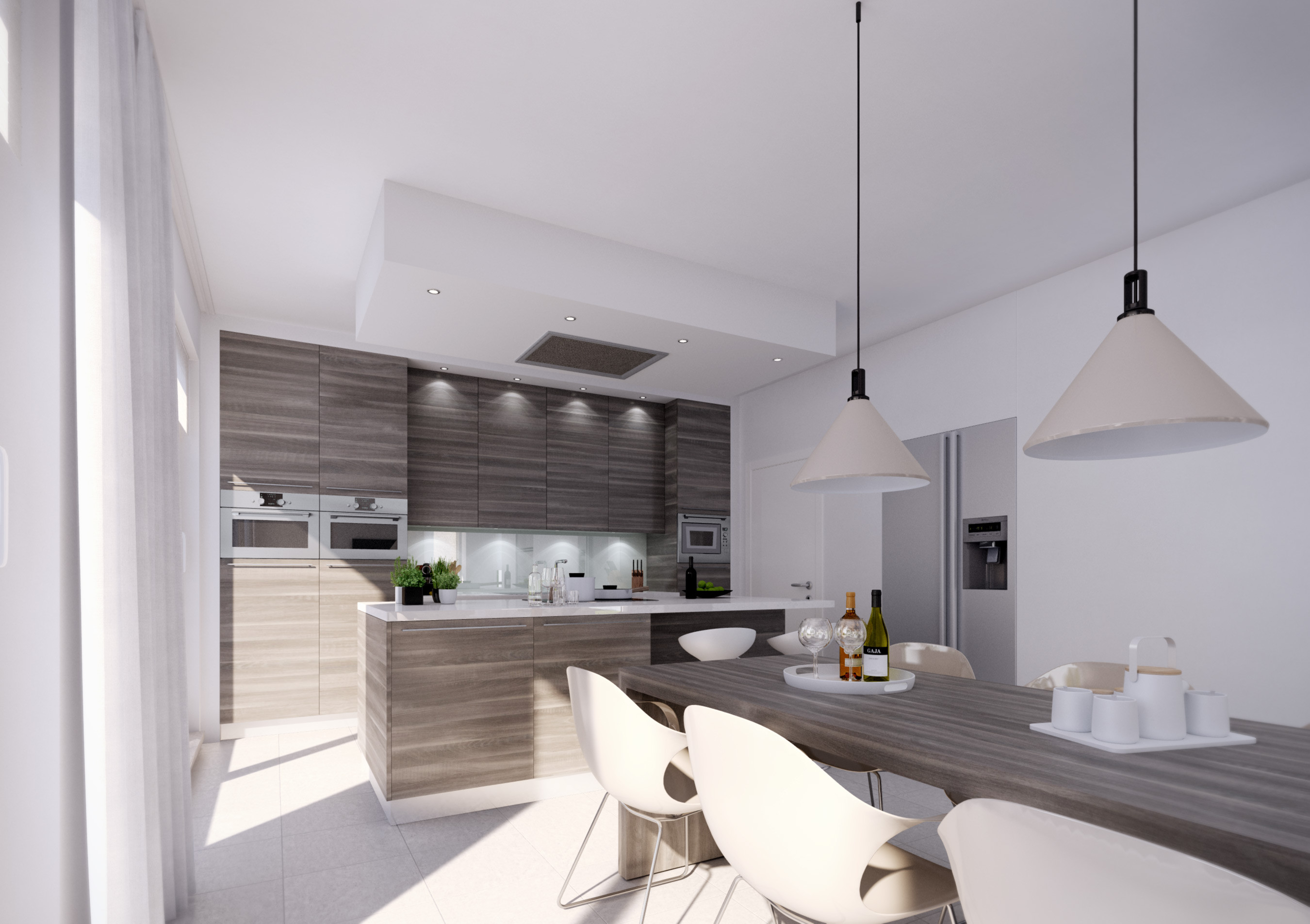

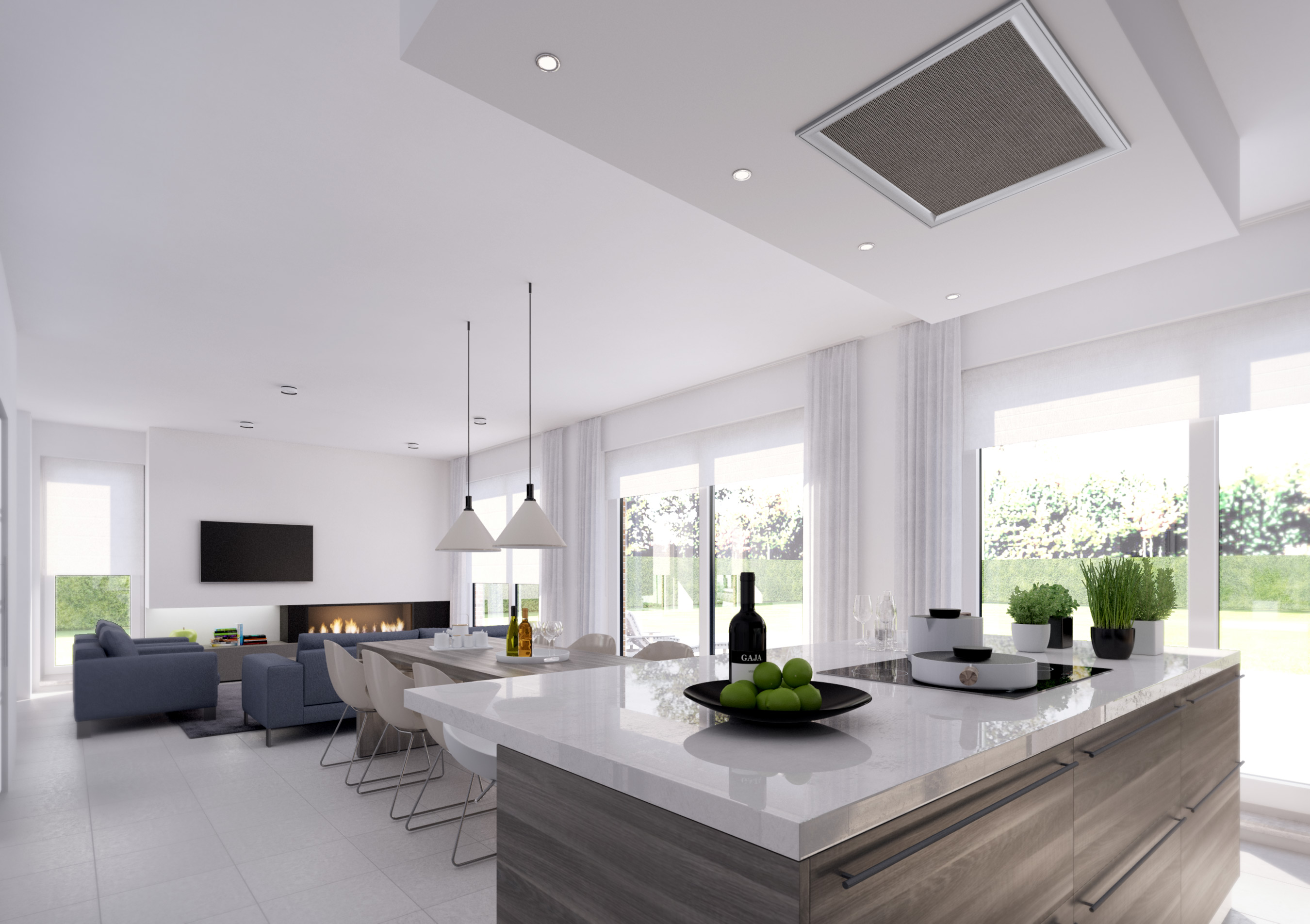

Here are final results :

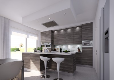

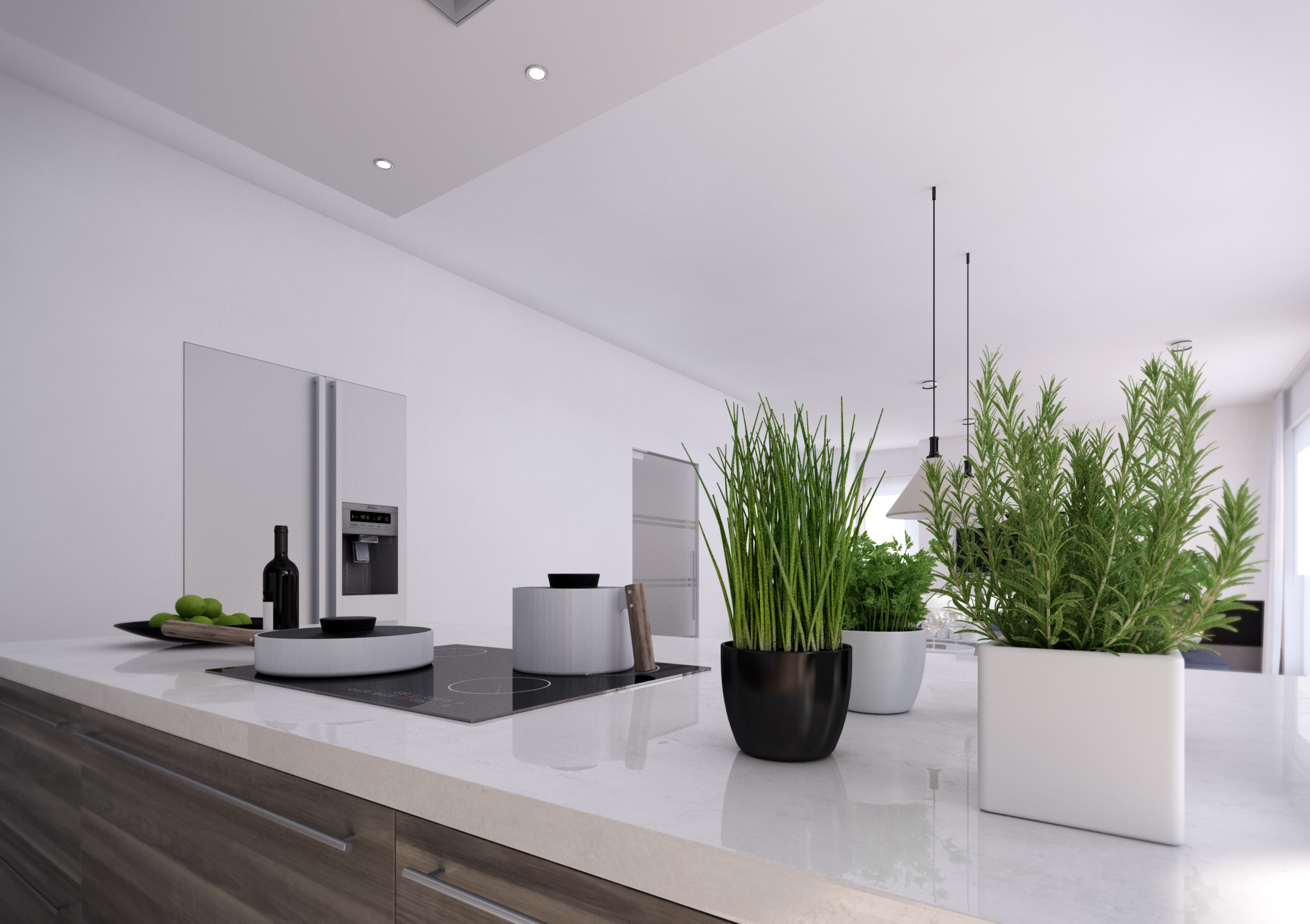

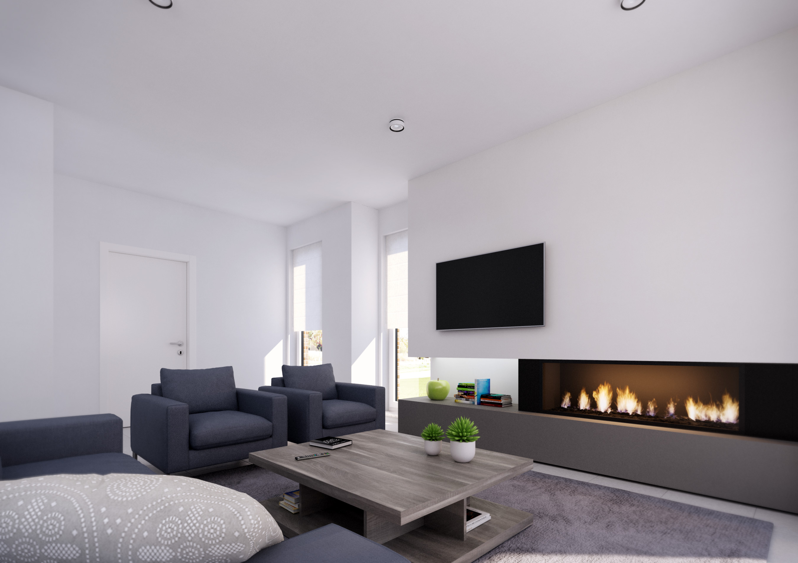

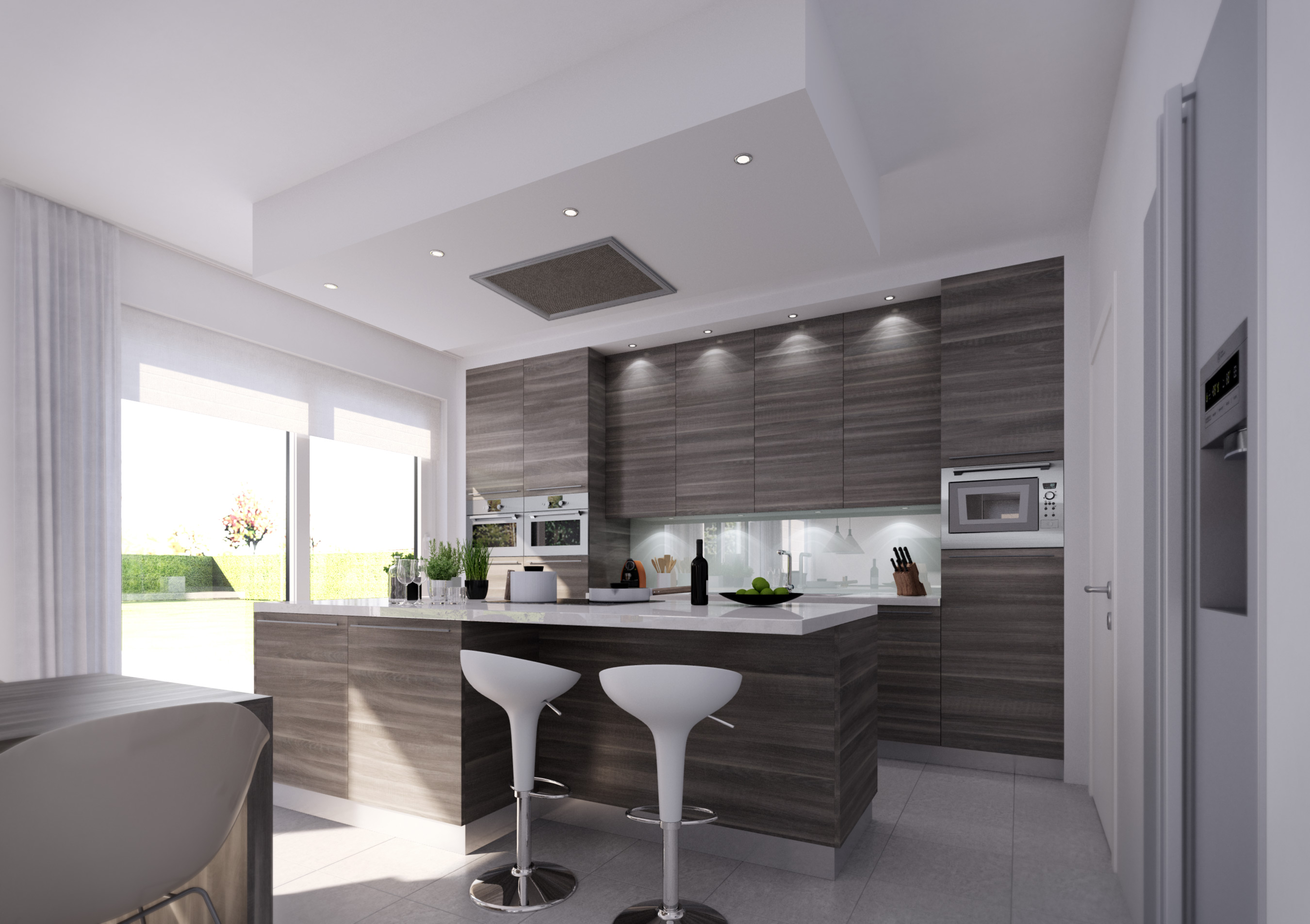

Re: Best recent interior setup?
Looks good :)
btw
for better GI (sharp GI corner effect) we must wait for K3. With K2 engine is quite difficult to get good looking corners - the radiation is too big always. Path Passes option (for example 1/50%) helps detect these regions by cached Path Tracing Photons but effect is average...of course without is much worst.
This bad effect comes from not accurate photons (which is normal and exist everywhere in other software) G. add just small tool (path passes) which support this imperfection by small amount Path Tracing Photons.
K3 has new Photon engine which make accuracy close to Path Tracing! but with Photon Mapping system (so ~10-20 times faster)...something similar to Sky Portals. After that having good photon map sampling will be very good and fast.
