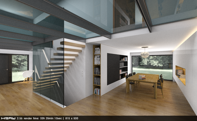

Kray interior render and scene attached !

It will be horrible time...because for that you must activate full Path Tracing rendering with minimum 5-8 bounce light...so it can be ~ 5-10 h (depends from GFX card or cards)jnom wrote:Ah so the render I got is exactly the same raw output but just needs tonemapping and post work.
Wow 20 hours for the lightwave render engine.
How about the octane engine? How long did it take to get a decent render? I know its a bit unfair for octane to render interior scene but just curious.
To speed up render you can make it in traditional way (limited bounce light+OCC)...but effect will be poor.
This is theoretical conclusion - it can be faster but I doubt because Path Tracing is no interpolated method and whatever you use: Maxwell, Octan, Arnold, Kray, etc it will be slow...horrible slow - no miracle!
In Octan you can use Direct Light Path Tracing photons with 1-2 bounce light (should be fast but light transport very poor) + OCC effect for simulation shadows. Of course render will be dark so must be supported by tone mapping.
This problem with dark renders (because of poor light transport) is avoided very often by strong clamped tone mapping. Personally I am not fan of that because light solution is really bended and is similar to dealing with "nuclear" light which is "dimmed" by tone mapping.
Here Path Tracing with 3 bounce lights and low quality (noise): You can notice black glass on the top (not enough recurse)
Render is greyish because small amount bounce photons.

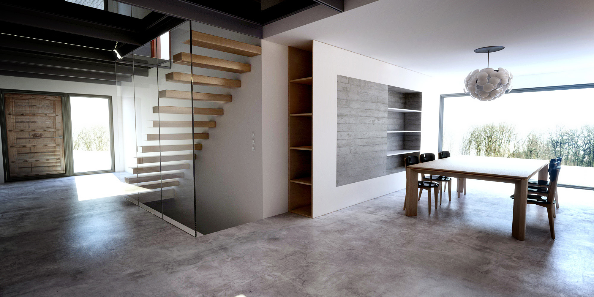

The Octane render i posted on Newtek's forums took 20 hours as well on a GTX 770 (a Titan would have reached this level in around 14/15 hours in a rough estimation...) with Path Tracing kernel and 8 bounces (as far as i remember) @ 1500x1000.jnom wrote:Ah so the render I got is exactly the same raw output but just needs tonemapping and post work.
So yes it's slow as hell and i found Octane isn't very efficient to reduce the noise compared to Thea for example, which is even more "realistic" to my eyes.
To summarize i think Octane is a great render engine but i won't use it that much due to its limitations and i didn't make the upgrade nor do i plan to do it in the future.

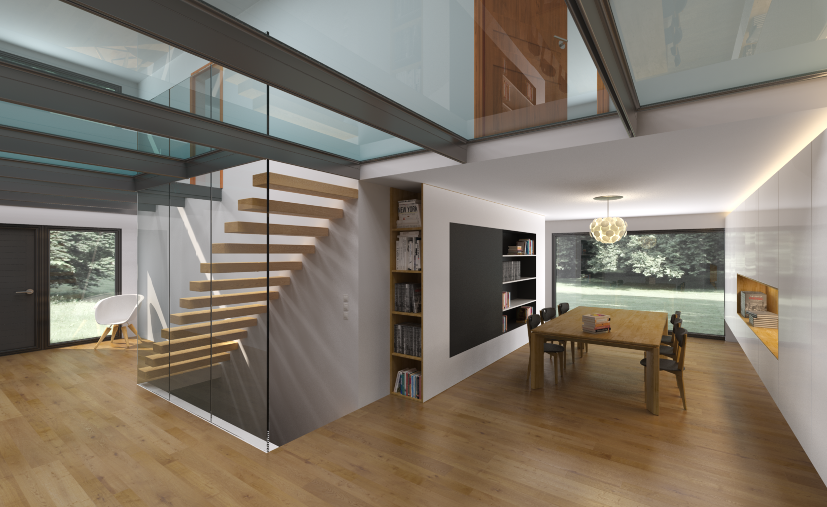

here HQ RAW, Photon Mapping with 3 pass Final Gathering test render with recurse 12 and FSAA Grid 3.

Hey, cool reconstruction of the scene, thanks for showing.
