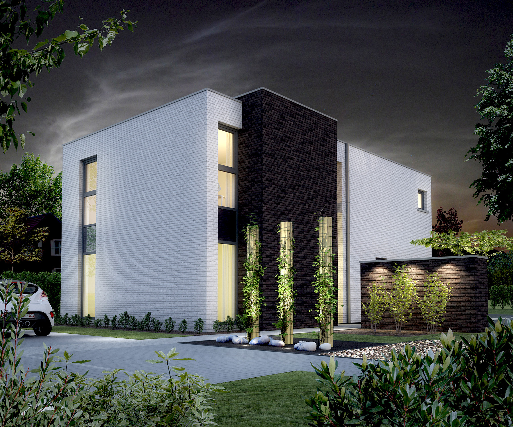

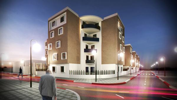

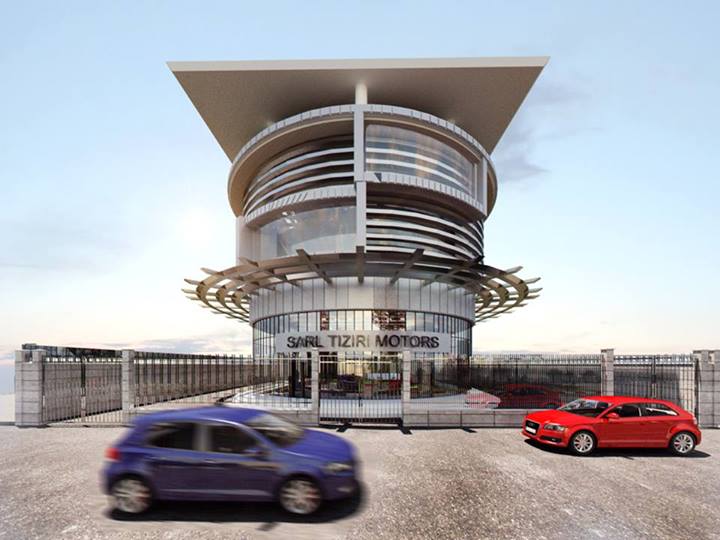

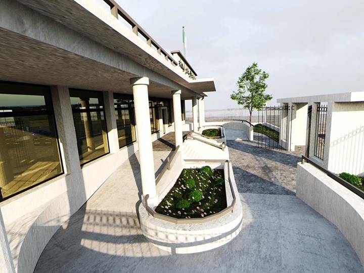

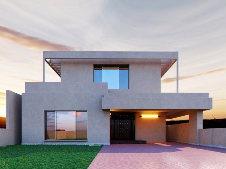

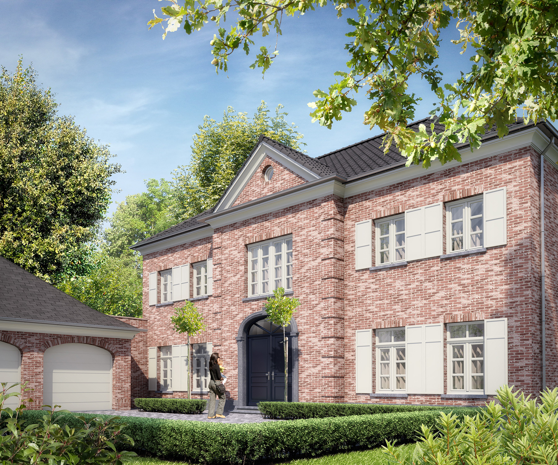

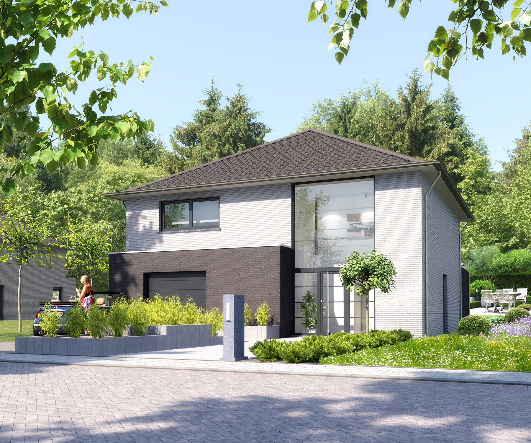

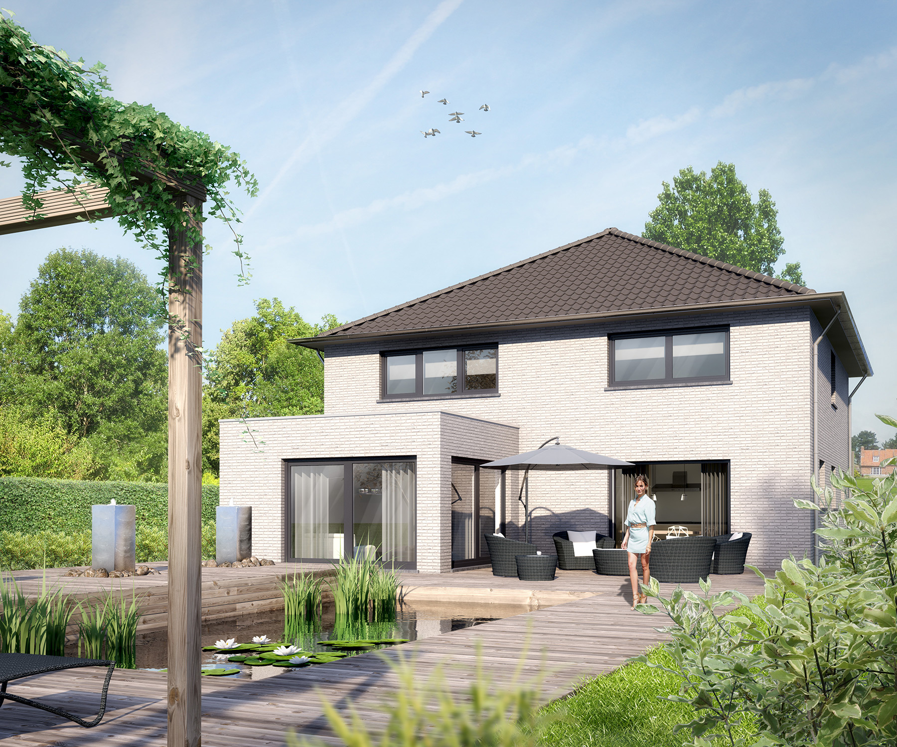

Just a collection of my renders

Re: Just some random projects
i suggest you using hdri . u will get really nice color and realisme . +phyksky only sun . kill lightwave light "distant light" and uncheck "Ingore lightwave backdrop" from physky kray .
Well I never realy managed to get good results with HDRI, maybe because I don't have good enough HDRI images.
I always render Physky (LW SUN ignored ofcourse) with ignored LW backdrop and sometimes a dome to 'fill in some shadows'

I suggest do not use HDRi. Information of light in these images are not good. Photon Map is not clean (hot photons) affect errors and problem with reflections. I know in the web are nice renders based on HDRi but still for exteriors is not good choice. Even worse situation is to use them in interiors - this affect more errors because photon comes from source of light which is not organized (HDRi) get worst after many bounce lights in rooms - this affect color leaks, etc.
Anyway, Physky is the best solution (perfect gradient photons - which reduce errors) and I have new solution for that: Physky with Spot Light from LW. The model of Physky is old and is quite difficult to get good effect from this source of light (colors).

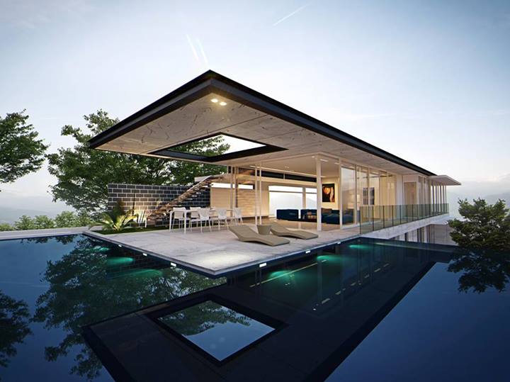

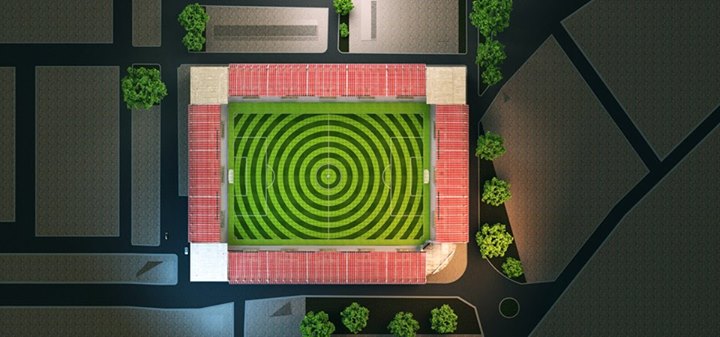

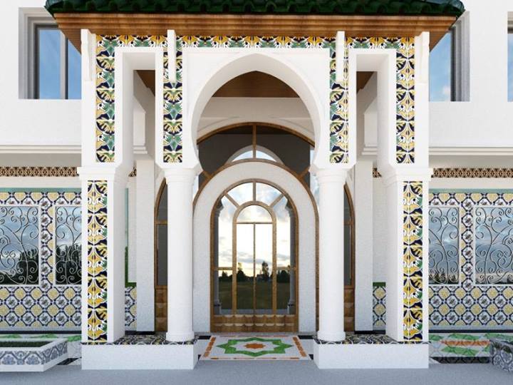

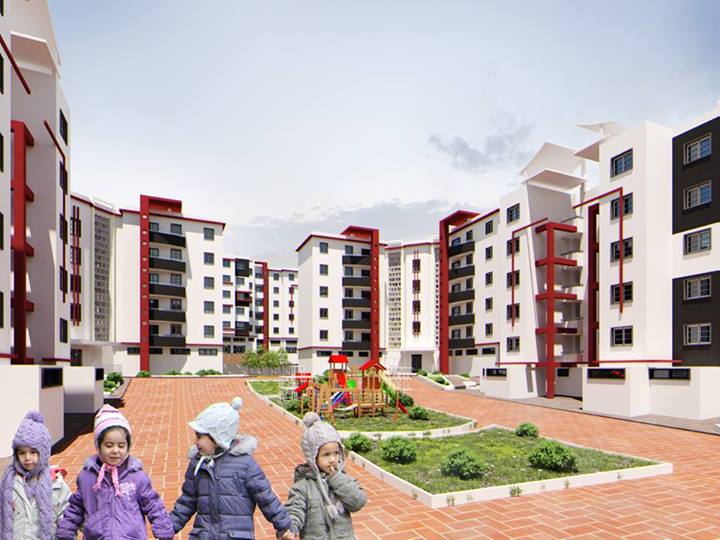

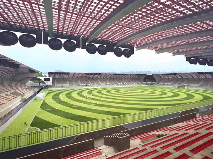

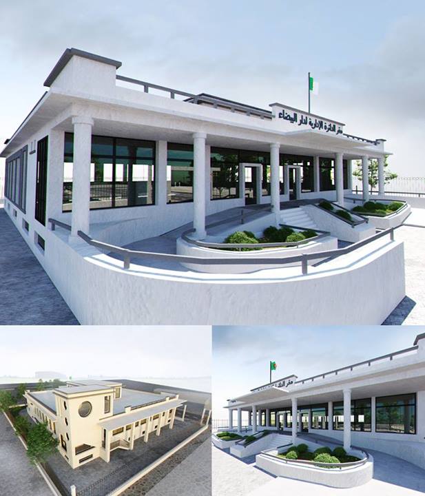

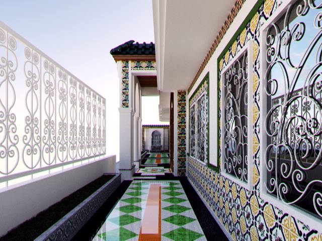

here few exmple render with hdri idid some old and some new .and +physky sun from kray .
all thos render is use any hdri image u habe its works . ofocurse with good kray sun position . and good tonmeping its done . hdri just give u mood and lighting . and u can tweak dat mood as u want .
as janusz said he is right . pohontmaping hot . not good but if u add gamma they will be good . when using hdri in envirement . spherical ball Y axis . its done . + gama 2. and over up to 6 or 7 . i never up it into 7. but as i said its depend hdri u use . any hdri u think exterior its good .

yes renders are good indeed, but I have been trying with HDRI many times and couldn't get it right (that must be me)
And as always too little time to do much experimenting
