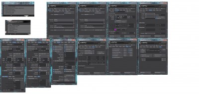

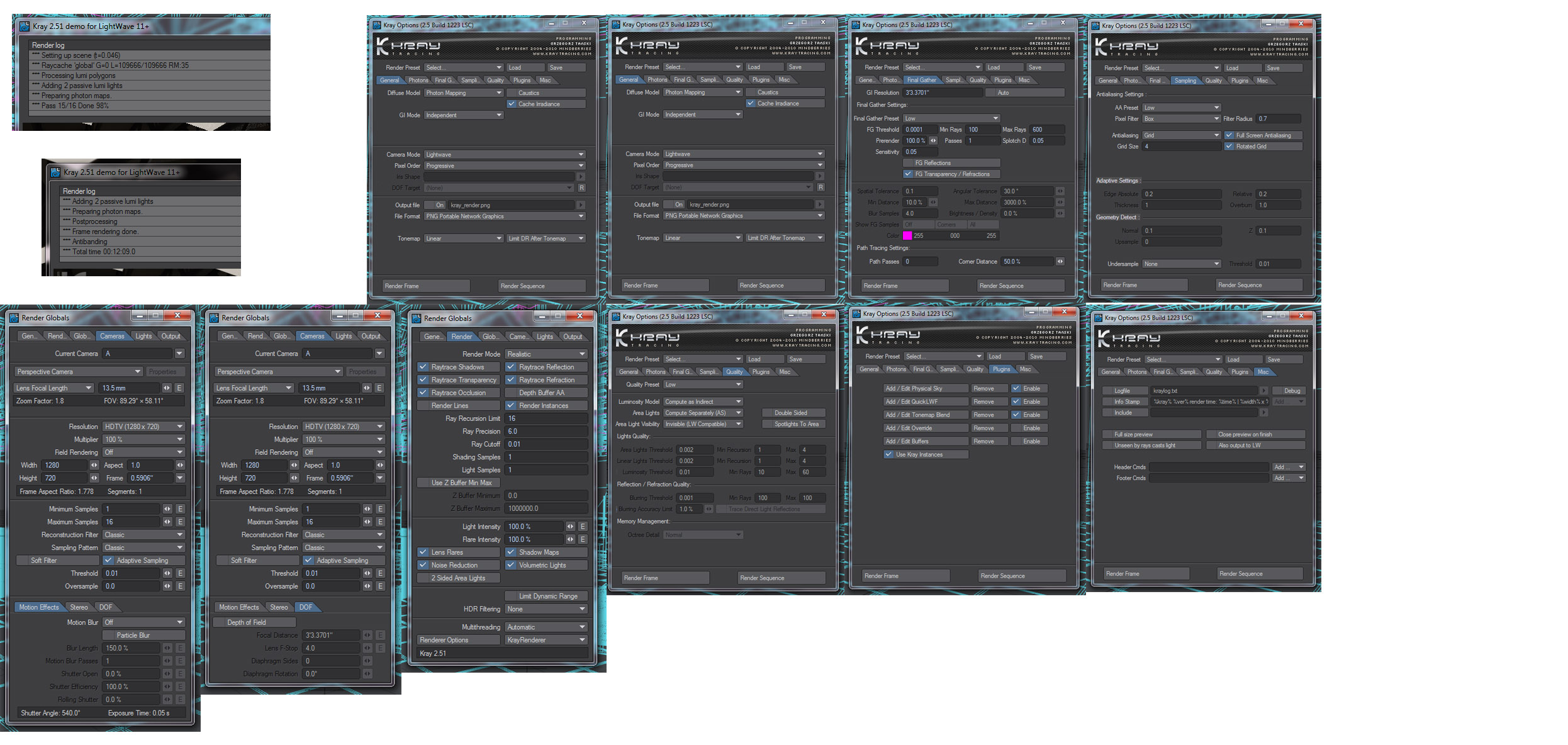

Re: Why is Kray Rendering Motion Blur
Post by 3dream »
Here is a screen grab of every dialog I think would be considered. Let me know if you think there is something somewhere else that could be causing this.
