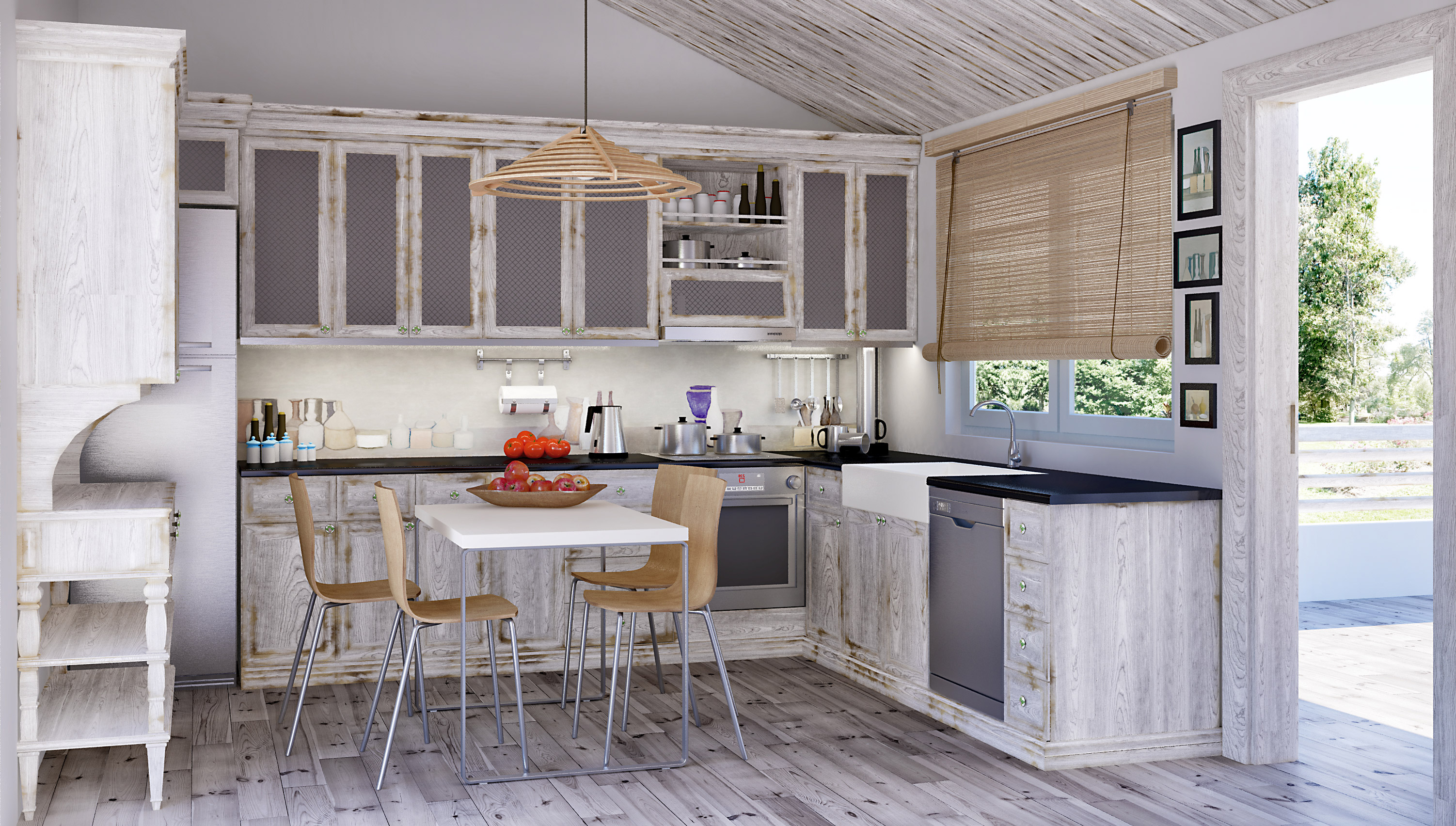

a little work. I hope you like it.
Re: a little kitchen
For me looks good except the quality of blur and anti-aliasing. Also some materials I would like make better. For example apples and tomatoes: they are to shine. Personally I use google image searcher to watch materials from real photos or from real life :wink:

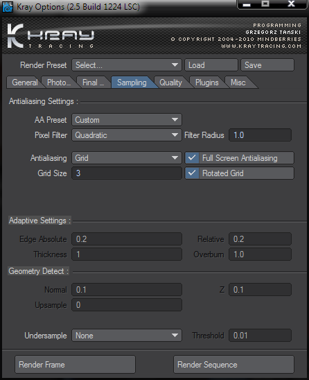

What can I do to blur and anti-aliasing? What could be setting the scene?
Here setup (maybe a bit extreme, but this is minimum)

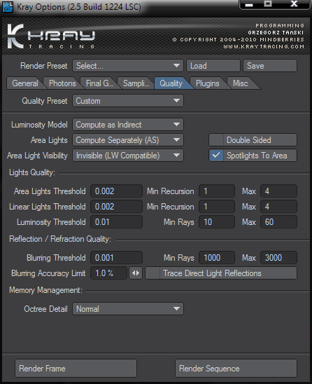

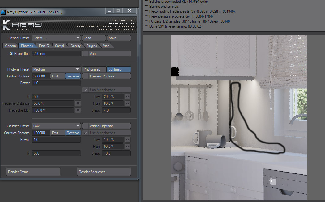

How do I solve the corner problem of gi. What should be the settings tab.
This is screenshot from pre-render (better is to post final render - then we will see more information).
This effect will be less visible after finish render - if not then You can increase blur samples (for example 1 , higher parameter make problems with contact shadow) and increase FG min/max Rays (for example 600/1000, this is major part of render engine in Final Gathering. Raising up for example 600/2000 You increase time render around twice but quality of samples is higher)
I think You should try with this:

finish work janusz
Now is much better. :wink: Of course materials need improvement still.
