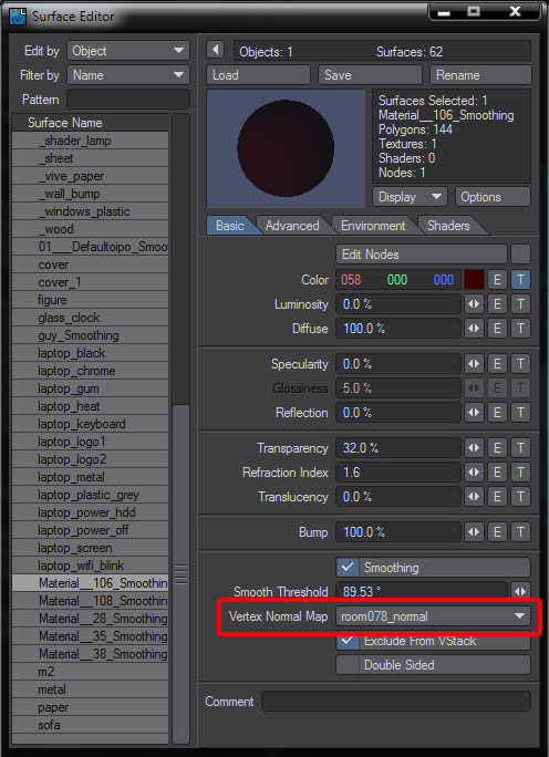

When You will open scene just turn OFF Vertex Normal Map from some surfaces - there are a couple with vertex setup. This bug appeared recently (is no annoying).
Here render after this with one pass: 3 min. :wink:
