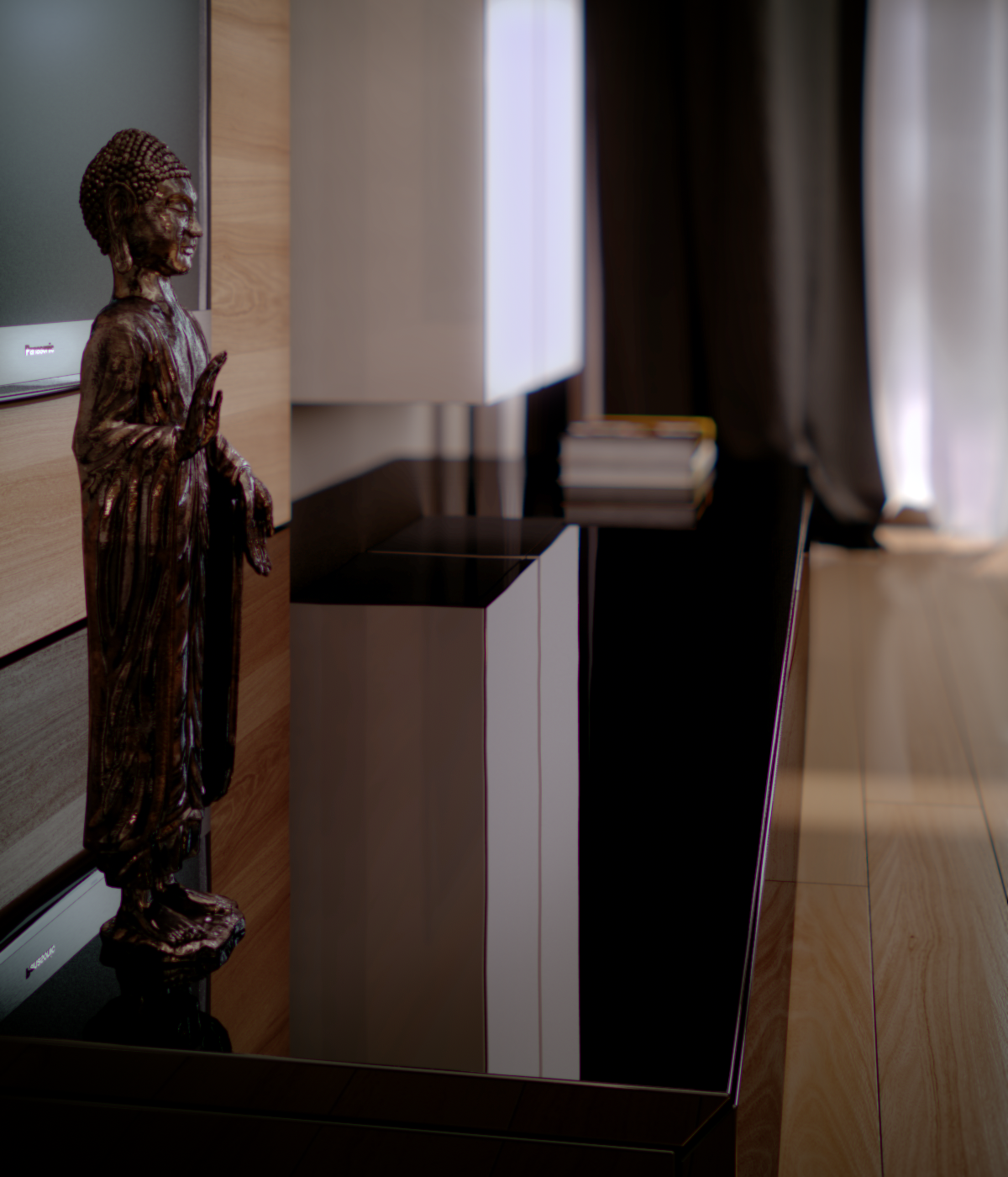

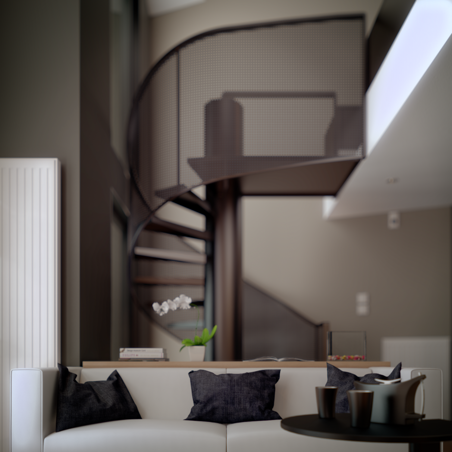

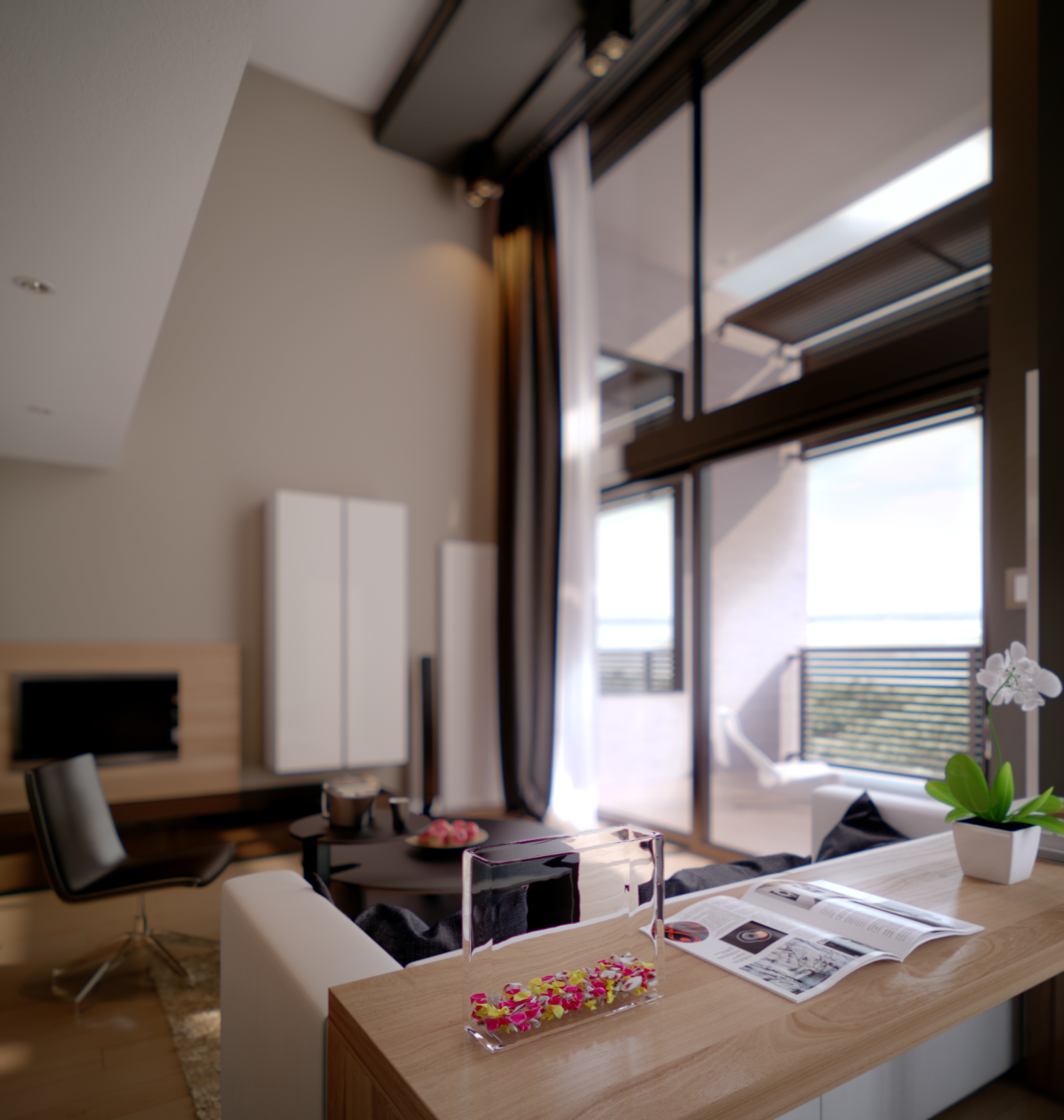

Here are three renders from my free training. Quite different style then before when was strong light, over bright walls, high contrast. I wanted keep more calm render, more ascetic (not too many details). Soon next renders

are perfect render, very hight quality...i'don't like the dof (imho) but it's all fantastic.
lumi panel on ceiling? lightportal? area? which light system are you using?

Great renders. You have originated new KRay+LW quality standard. I am looking forward seeing your new renders.

Thank You! Btw with DoF,all the time is problem with "point of view": how, where, how strong, etc.

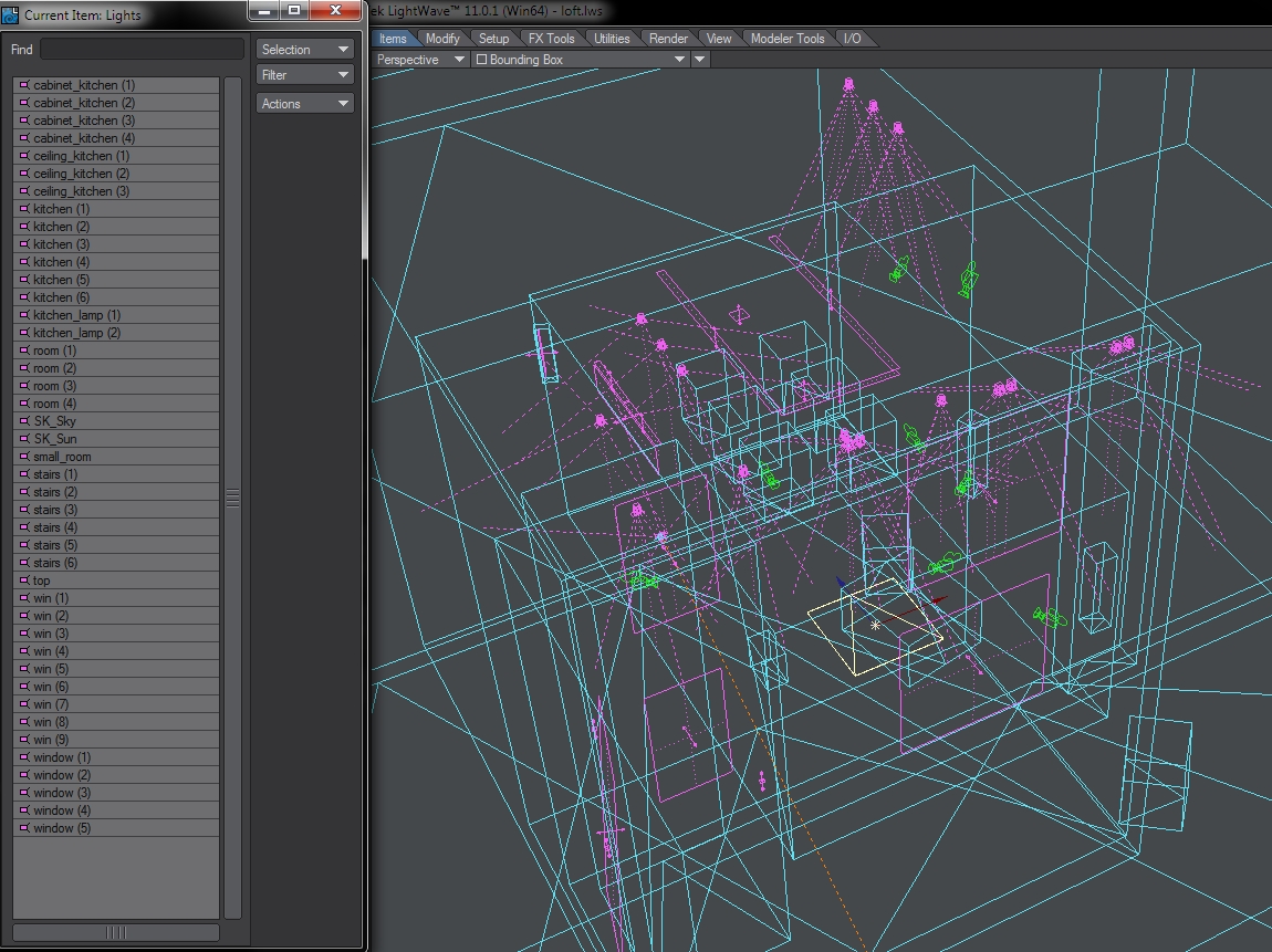

Here setup light (no lumi in scene). Time renders between 1:30 - 2:30 h.

Dobre BARDZO DOBRE. Fotorealistyczne a to chyba najwazniejsze bo cały czas do tego dąrzymy do realizmu. Dofpro daje rade i dodaje realizmu aberacja, lekkie przepalenie. Po przyjrzeniu się na siatce doszłem do wniosku że tych świateł mogło byc znacznie mniej abu uzyskoć podobny efekt. A może mi sie wydaje. A może to takie skrzywienie aby oszczedzać na ilości swiateł aby nie zmulić renderingu. Tak czy siak świetna robota.

Wow man! this looks good and different!
Your amterials are just perfect.
Why no Lumi this time?

so januzs you are working with sunsky of pontonnier in this render!! no lumi in celing!!! great news for kray!!!!
edit:using the plugin's the render time is greater...with lumi panel is +fast....i've see from my test...it's true?
the quality is very good and is fast set the scene but i see > time!!

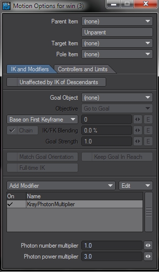

About lights:
1. there a lot of spot and area lights, why? because I was tired by exponential tonemaping and "its" let`s say "patronizing" over scene (we know how exponential can ruin render...and we know we can not live without exponential) so I took decision to reduce level of exponential. So from now I will render almost pure LWF Gamma (in these renders are 75% of LWF in blending shader) If I will put just a few sources of light scene will start be overburn and flat. Is very hard control LWF but LWF brings positive thinks with real view of colors.
2. Actually this amount of lights did`t affect strong time of render (15-25 min without AA) but complicate setup of surfaces, high level of blur, high level of AA give multiply minimum 3.
G. promised better AA in next release and also surface shaders (which really bring speed)
3. Is one trick which I used first time: PowerShader for lights, because was too dark and could not use strong exponential or just rise up brightness of lights I make tonemaping by power (2-3 for each light) This idea can be DEVELOPED. Of course somebody will ask why not do it with lumi panels, but I observe power shader works better with physical lights. Are less splotches (almost non), less effect of strong radiation.
4. I would like really avoid problem with exponential by canceling unfortunate exponential and use only LWF Gamma. But I think this is quite difficult and maybe PowerShader can help to control better LWF Gamma.
Will continue this way and we will see what we get

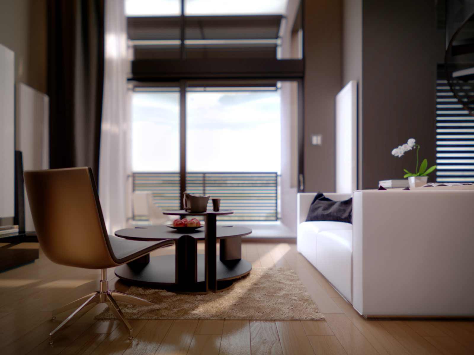

That is what I tried with my last renders, but do you set up parameters in LW in LINEAR or RGB?
Also, around ceiling it's pretty dark, hox do you handle that?
Re: ambient
Yes, in LW must be Linear. All space colors and tonemap You do in Kray .khan973 wrote:That is what I tried with my last renders, but do you set up parameters in LW in LINEAR or RGB?
Sorry but I do not understand question....Also, around ceiling it's pretty dark, hox do you handle that?
