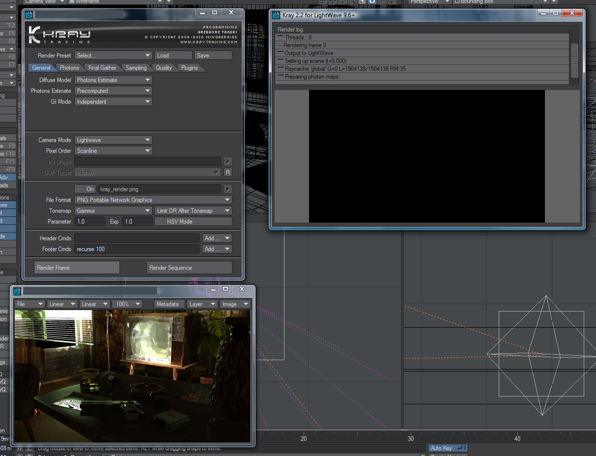

Since Kray for Mac is unstable I've switched to Windows for rendering my scene.
I've loaded up my room with shaders, most of them nodal.
I load up my scene, set my resolution multiplier to 25%, select Kray Options, switch to Photon Estimate Precomputed and hit Render Frame.
No problem there, Kray renders just fine.
Now I add the footer command 'recurse 100' and hit Render Frame again.
LW freezes for ever and I have to force quit.
Strange thing is, this morning it worked, even with recursive 100. I am at a total loss... what the hell is happening here?

This is after I switched off all nodes in the surface editor.
After adding the 'recursive 100' command, LW freezes.
It also freezes if I increase the recursive level through the Render Global tab in LW instead of the Footer cmd.

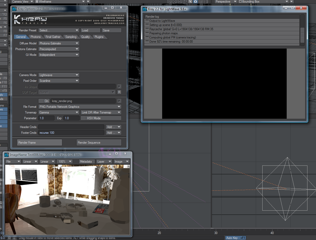

Re: Kray Keeps on Krashing
I have no idea why it would work one time and not the other. But what I do know is that "recurse 100" can be very demanding on the cpu so maybe it didn't stop, it just takes a loooong long time to render. However I have no idea why you would want to use recurse 100 command. This is just unnecessarily adding to your render time.
In any case, if it's crashing and it can be reproduced easily then send me the scene and I'll make sure the bug gets fixed.

No this is entirely correct. However you will not see any difference once bounces get above 15-20... Because light contribution from those bounces is very very low. However adding more bounces for reflections and refractions will mean kray needs to trace rays deeper and 100 is a very high number. Check out Vray settings for example, by default they trace only 5 recursions for reflections/transparency to save render time.sarford wrote:i Jure,
