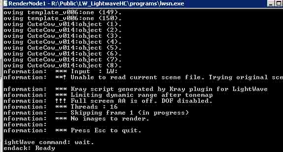

I have spend last 2 hours trying to set up rendering of one frame in BNR and KRay, did anyone succeed with newest version of KRay? I am getting this error on all render nodes except the first one (so it looks like it is problem between spiting frame function in BNR and KRay). Only one slice is rendered, the first one.
It says 1 frame skipped because I have changed the scene - thinking that it might be KRay not wanting to render frame 0 in lwsn mode - but it was not that.
Cheers
Tomek

Make sure you are using LW output and disable Kray's.

Re: Butterfly / Kray problem when split frame?
Post by soth3d »
thank you, everything worked perfectly fine :)

jure wrote:
can you add this piece of info please to the network rendering wiki?
it took me a long time to figure that one out... ;)
finally found it here on the forum.
edit: did not fix my issues...
