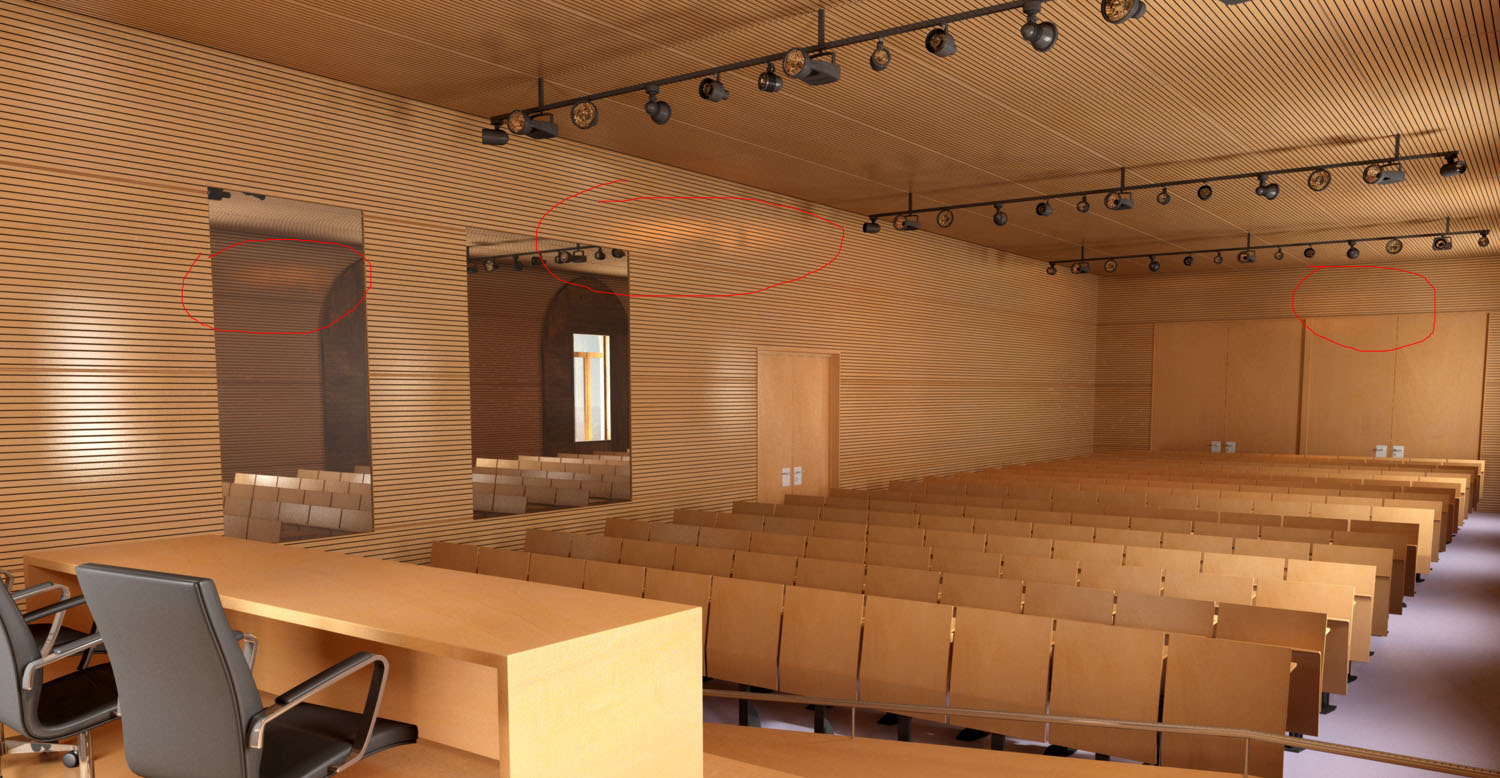

I have problems with a scene. Someone knows why it is and how to solve?
Re: Need Help please
opm wrote:I have problems with a scene. Someone knows why it is and how to solve?
It looks like there are splotches in your photon map. Check precomputed unfiltered and if you find bright spots there try to fix them with shooting more photons and higher N number.
I think also is problem with photons coming from outside through window (if You have glass as windows glass please use 100% transparency or put them for layer with uncheck CAST SHADOW.
Also Area light as RAPID light from windows inside room can help.
Windows are wery small so photons has problems with traveling from outside to inside.
Best way is use SKYPORTALS, but for that You have to use lumi bal as physky effect (Kray physky does not support skyportals yet)
Personally I suggest Skyportals.
