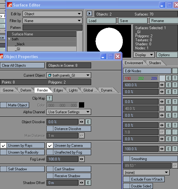

New feature: hidden lumi poly
activate and setup (later will receive shader I think)
footer cmds: lwo2unseenbyrays_affectsgi 0;
footer cmds: importancegammamultiplier 1.4;
http://www.kraytracing.com/forum/viewto ... 730#p10730
I thing 1.4 i the best. High value blurr just looks as high. for fast prev You can switch to 100/500
